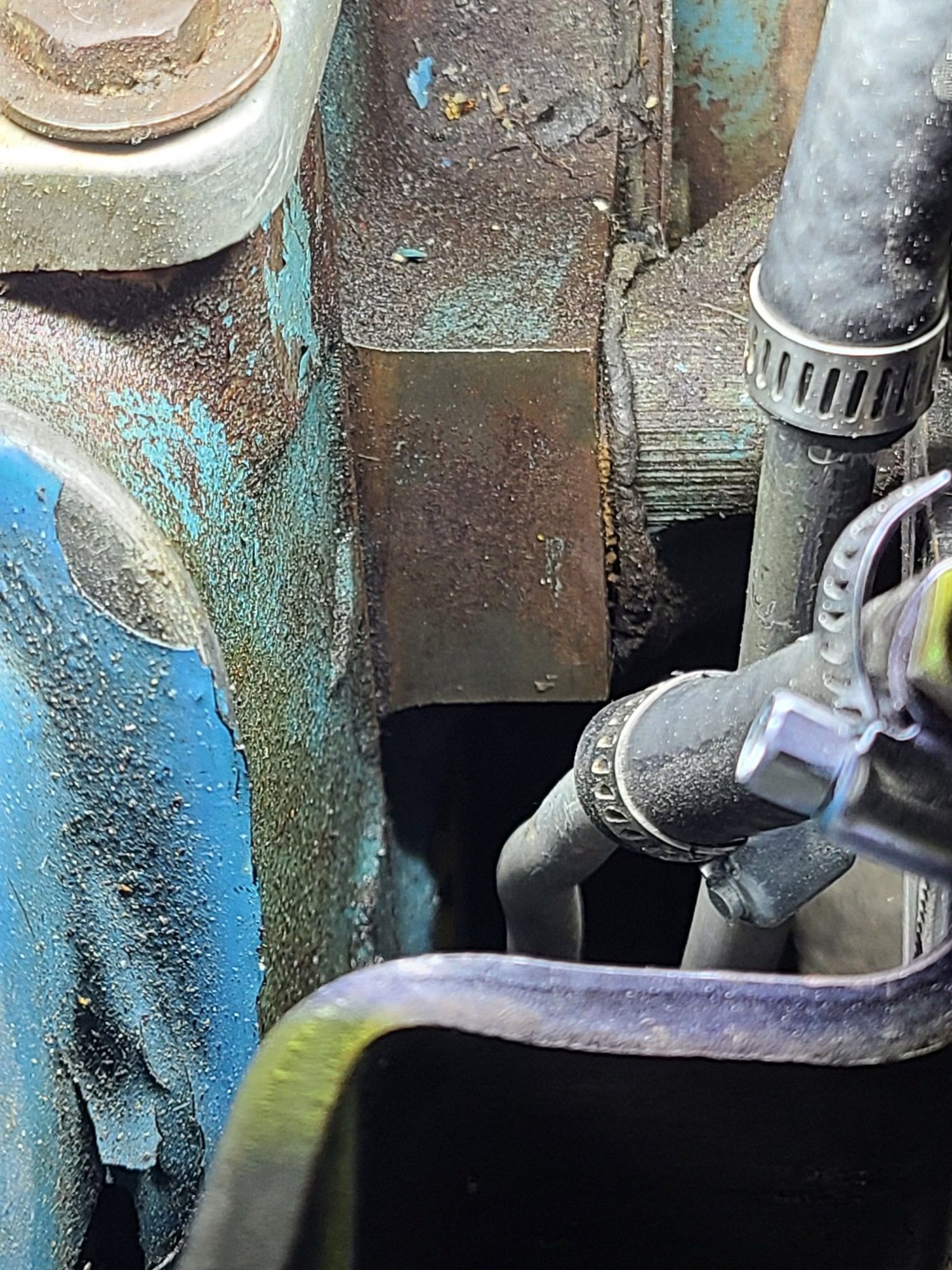

Is this where the engine serial number should be?

Yes, clean it off with a old toothbrush & WD40; don't use metal.

To answer the original question, yes that is were the engine information should be stamped, but it wouldn't be a serial number. What should be stamped on the pad would be a VIN derivative (a portion of the car's VIN) and a code for the engine assembly date, the engine plant and an engine suffix code (engine designator), but even after blowing up the picture I don't see anything stamped on that pad.
A blank pad might indicate an engine that was "decked" (the block cylinder head mating surface was machined smooth) while being rebuilt, or a new Chevrolet bare block was installed.

I cannot resolve any stamping either. To me, pad appears as either very dirty, Or, what may have been stamped, has since been obfuscated / obliterated.

I can't be so sure of what I'm seeing. Has your stamp pad been adulterated or altered ? Can you resolve a pattern of very fine broach marks across entire pad ?
if you haven't already, suggest perform compression tests AND leak-down tests on All cylinders, BOTH with And without oil. To help determine condition of ring seal.

I can't see any stamp marks on the stamp pad, I would think they would be at least 0.010" deep and the pad looks perfectly smooth to me except for the rust in the middle if I blow up the photo a lot. I'll get in there with my dremel and see if I can clean that off.
