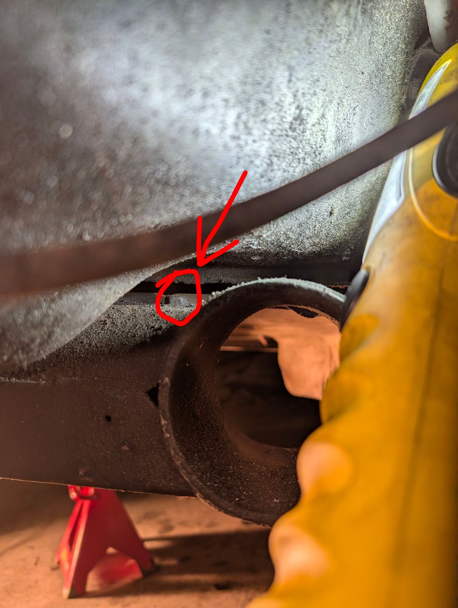

Ok...it's no wonder we cuss so much when working on these things!I've got the old junk exhaust out now trying to take the cat shield off. It's ALWAYS that one last bolt!
Can someone tell me how to get this last one out? It's between the crossmember and floor. Impossible to get to. 1/2 wrench can't get to it!
Any good ideas are appreciated.

Make a 1/2” wrench out of some 18 gauge sheet metal, bent to fit over the bolt.
You could also cut the box end off a 1/2” wrench and spot weld a long sheet metal handle to it.
Just use your imagine and design a tool to do the job.
I’ve had to make my own tools many times for some difficult tasks that the tools in my box won’t accomplish.
If it’s just a self tapping bolt that screws into the frame, it shouldn’t take much to back it out.
Maybe a pair of long nosed vice grips.

TEMU flat steel plate wrenches ...a whole set for $6. Amazon.
I've bent/shaped a couple of these to get into tight places for fuel and brake line clip bolts.
Maybe?
Regards...

Great idea!
Sadistic minds for sure!

In your situation it appears that the transmission crossmember may have to be dropped on one side to access the bolt head or a well placed Sawzall might do the trick.
