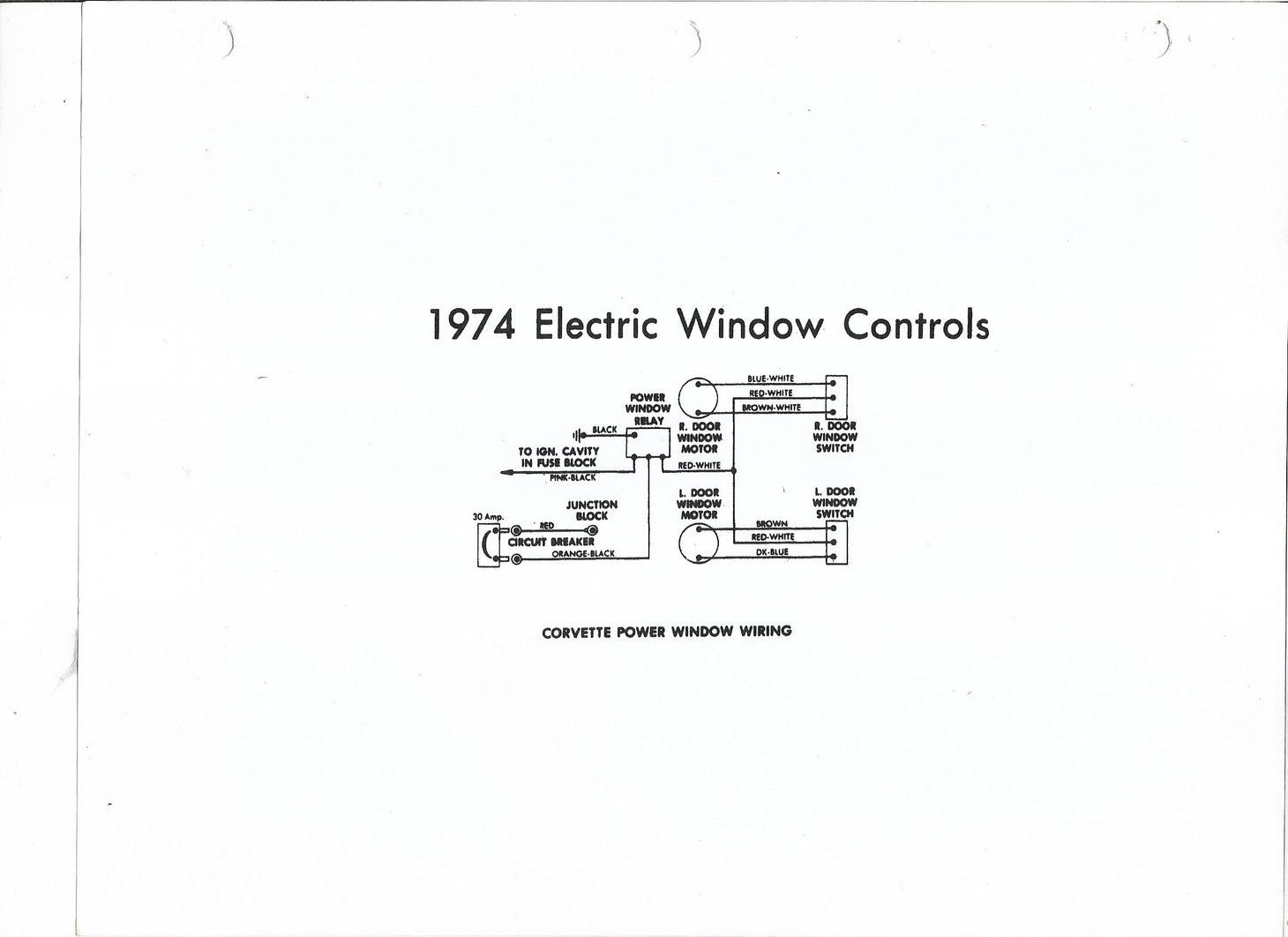

Default Check the circuit breaker first.
Open the hood and check for power at the circuit breaker that is mounted to the firewall behind the master cylinder.

If you have a loss of all power, you need to check power and ground starting with the battery.. The power wire going to the fuse block from the starter is in the outside connector to the fuse block. This connector was covered at the factory by a black moisture repelling goop that is hardened by now and probably does not repel moisture as well either. The terminals in this connector may have corroded to the point that a heavy draw from the power window may have caused a burn through of any remaining corroded contact. The power windows are usually powered through the Accessory Circuit Breaker (CB).. You can pull the CB off the fuse block and check for 12v. power on one of the terminals on the fuse block for the CB. On the other terminal (neg) check for continuity to battery ground with an ohm meter or a test light connected from Battery + to the negative terminal for the CB on the fuse block.
Sometimes a meter or a rest light is not enough to challenge the power draw of the electrical system. You can use an old sealed beam headlamp with both low and high beam in the same bulb. This headlight has 3 blades on the back: low beam, high beam and ground. Wire the low and high beam blades to a single wire (positive). Wire the remaining blade as ground. The ground can be a long wire with an alligator clip on one end to clamp to the ground cable on the battery. Then use the positive wire to test the 12v. connections, starting with the positive post of the battery. Let the headlight stay on long enough to challenge available power. Use a minimum of 14/16 Ga. wire. Carefully check the fusible links at the solenoid on the starter. Possibly an issue with a faulty or frayed link on the power wire to the fuse block. There is a connector (C403) at the end of the starter extension harness that comes up from the solenoid into the engine compartment near the A/C box at the left fender, Mine had several burned terminals. I replaced the extension harness and rebuilt the male connector of the engine harness..
