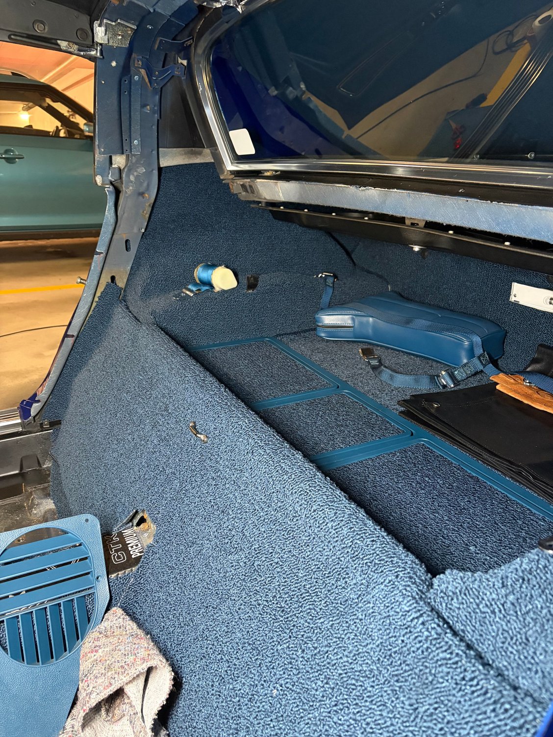

My carpet installing goes on, mostly done. I other words test fittet and cutted without any glue.
Only one question, Is there a trick to fit the rear bulkhead flat in? Mine makes some small ugly waves.
Laying the carpet over the edges works realy well. On left and right there is a small notch where the carpet snaps in. I let them sit for a few days for forming.

Hello,
What you've done looks very. very good.
As far as the bulkhead behind the seat goes I think you should wait a week or two to see if it flattens some on it's own.
If it doesn't, a very sparing amount of glue might be needed.
Again.... looks terrific!!!
Regards......
You might find that you'll need to enlarge the opening cut into the carpet for the rear of the transmission tunnel.... but wait so you'll be sure that's needed.
You'll want to be positive the e-brake console will cover it completely.

For all people I removed the most of the glued jute from the ACC carpet. The only jute were I leave was the big one under the front driver and passenger carpet. The small ones on the side at the front carpert were also removed.
My underlayer is a mix from Alubutyl and the ACC sound deadner (the jute styl with the black rubber) but I have made some modifications and cuts to it. Nothing is plug & play but works well with time.

Hello j864,
Those photos show some VERY fine work!
Well done!!!
