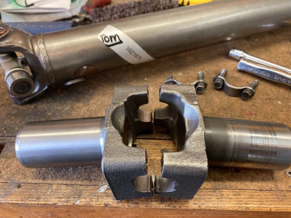

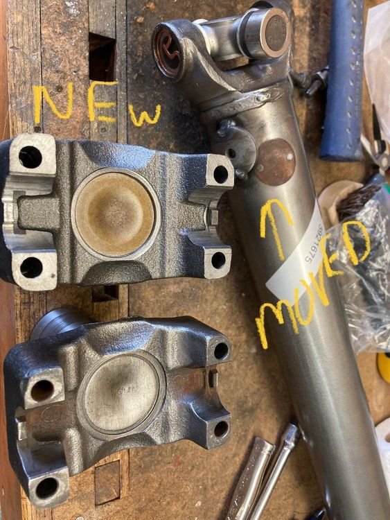

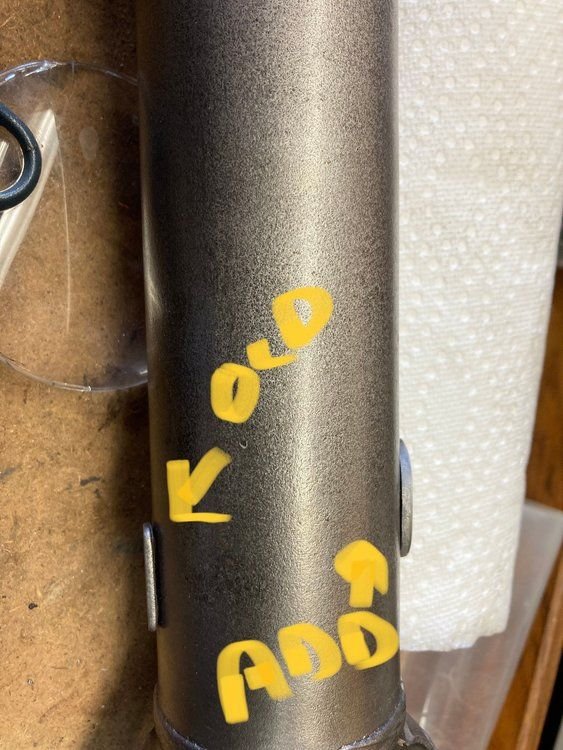

I think its cheap insurance to send out driveshaft with yoke attached to balance.
my education here.
