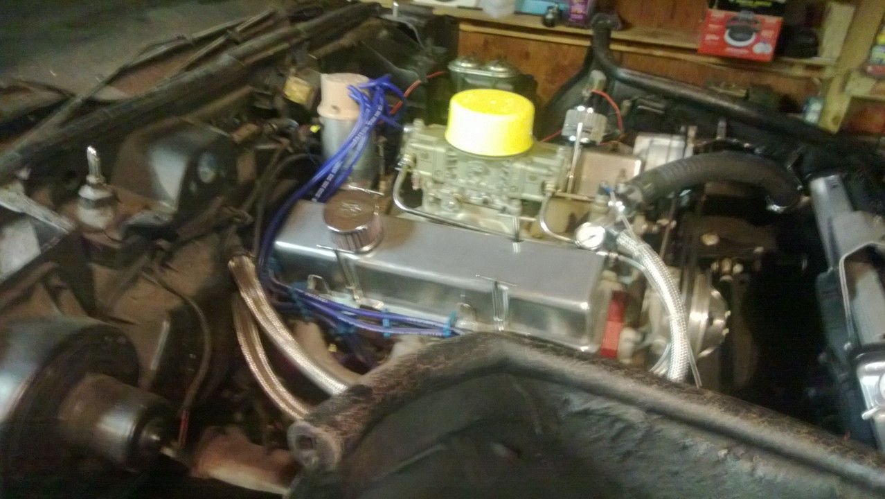

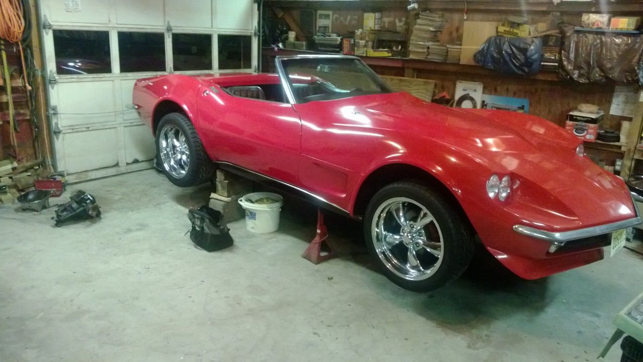

I've been running a Vertex Magneto on my small blocks in this 1968 Custom tilt nose Convertible Corvette since 1977. It has been great with the exception of being unsuccessful in having a tach work reliably. My question is what are other people running in their High Output small blocks?

I'm looking for Race quality 7K /RPM is where I should limit it; but I'm sure my Vertex will be fine to 12K/RPM and beyond. My Vertex needs to have the magnets recharged and the whole thing gone over, so I'm talking a few bucks. I'm looking for a back up plan. My small block has: solid roller cam and lifters, AFR heads,383 stroker, better than 500 HP & TQ.

interesting tilt-nose styling
