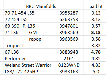

Both of those manifolds are too tall to fit under your stock hood. Summit says the Wieand is 5.75 tall and the Edelbrock is 5.220 tall. Off the top of my head, stock is 3.56. I have a Performer RPM on my 73 big block, but with a L88 hood. Even that requires a drop base air cleaner.
On the Summit site, they call that Weiand manifold dual plane, but the picture shows it has the plenum opened up quite a bit. If you're after torque, that's probably not what you need.
There are repop copies of the L36 390hp manifolds available that are stock height and oval port. From what I remember, they're in the $500 range for a new one. You can look on Ebay for OEM and they're $400-700 depending on how many helicoils are in them and what numbers are cast into them.

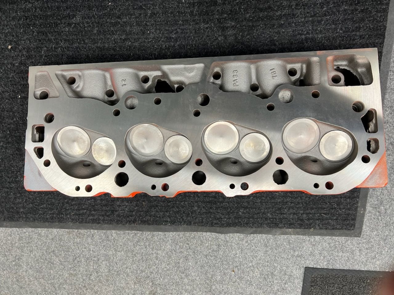

I have a 1974 bb and am using an original ls6 alum intake with stock casting heads.
The factory heads are indeed 781 castings which have the large oval ports.
The original ls6 intakes are rectangle ports but the bb's dont mind so much if you are not going racing.
The LS6 intake casting # is 3963569 so search online for a repro with same.
As mentioned above, you can get a repro of the ls6 intake with matching larg oval ports to match the 781 head ports.

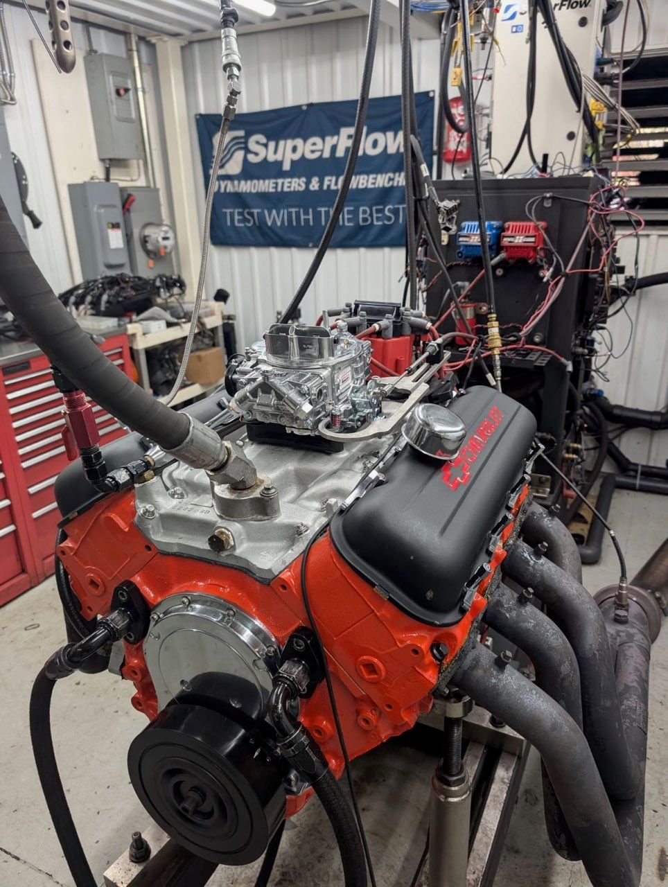

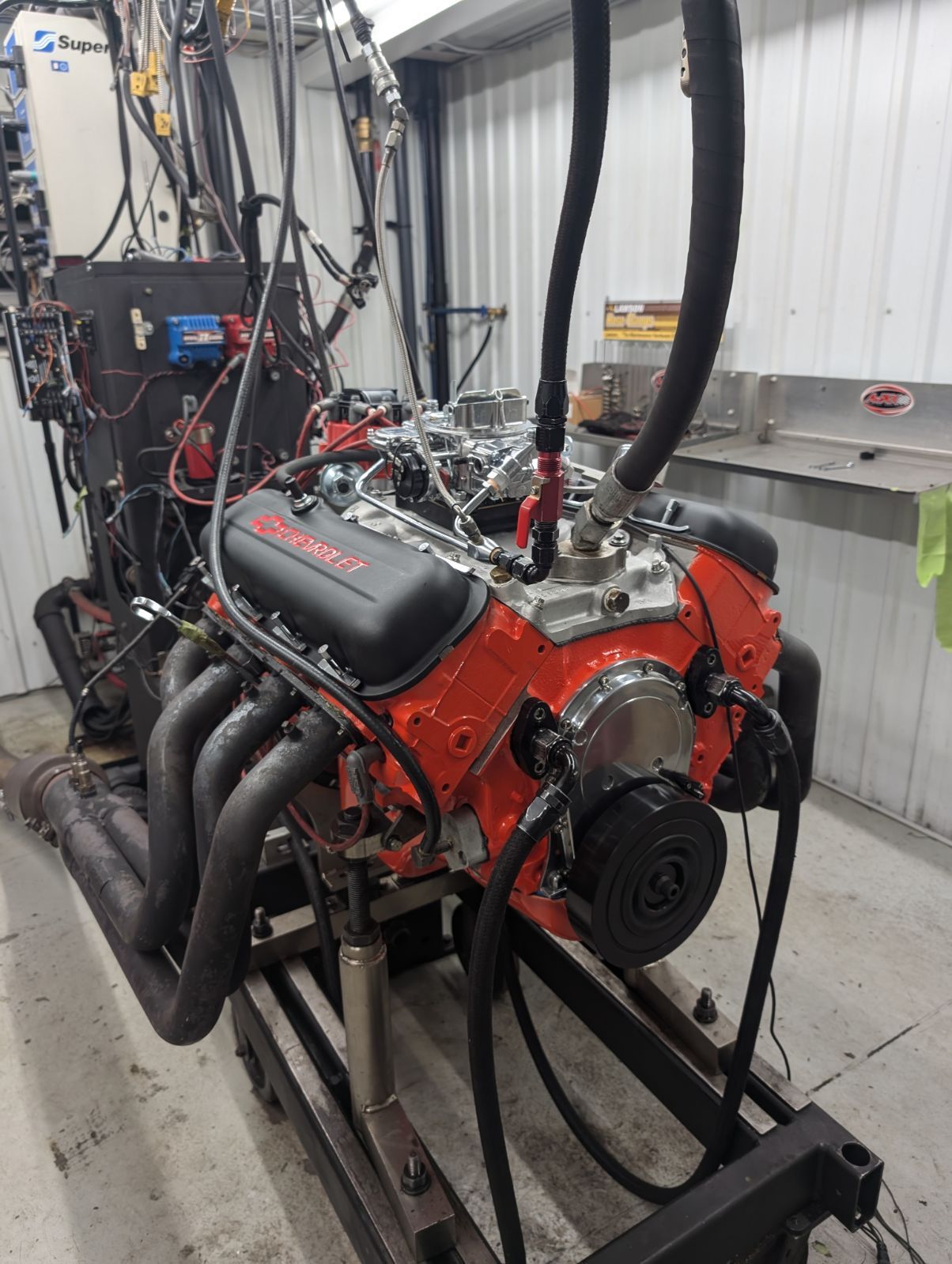

Just to clarify a bit.
The engine pics on the dyno show a 1" spacer under the carb.
That was only so the fuel lines used on the dyno would clear the intake.
That will not be in my car with my fuel lines.
My engine is parked on a stand right now but am sure the spacer is too much with the stock hood.
The motor actually dynoed over 500hp with the dyno operators 850 race carb.
I was looking more for the torque than the hp for a fun street car.
Cheers!

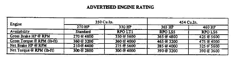

The oval ports will easily support 500+ HP.
The R-ports are only preferred once you push it over ~5000rpm.
Under that ovals are preferred.
Your biggest HP & TQ issue is the really low compression ratio the stock 71 & up BBCs had. Like 8:1
Getting it over 9 to 9.5 really makes the throttle more crisp! And adds power too.
400 is sooo easy on a BB. Might as well shoot for 450-500.
Your factory rated ~270 HP is net, that is close to ~350HP already (gross HP).
See the 71 LS5 454 which was rated both ways by GM. It was only 15HP stronger.

Your 74 hood is about as high as a 72 BB hood. You might have 1 inch more room?
The Torquer II is the height limit on a BB hood. With roughly 1/2" to spare.
Not sure a Performer is gonna make it.
Prop your carb or air cleaner up and check. Use some putty or crumpled al foil.
