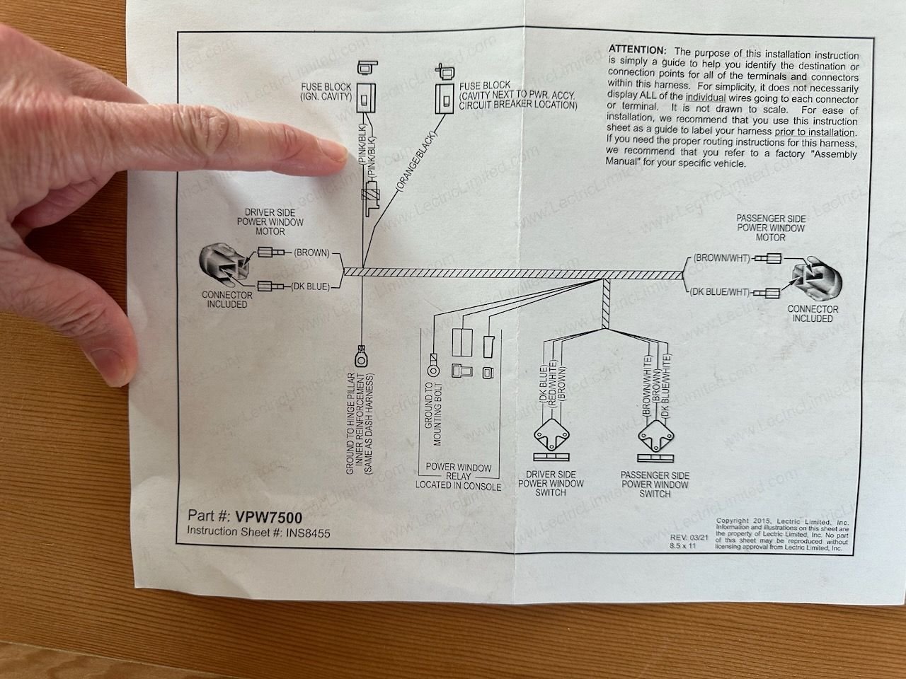

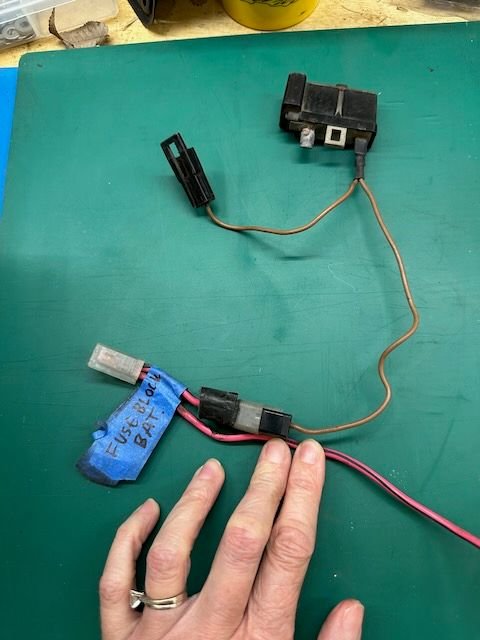

Swapping out the power window harness on my '75 and can't figure out what this brown section of wiring is (see attached photo).
The wiring diagrams I have for the old harness and new harness have the pink/black connecting to BAT on the fuse black. The pink/black pigtail that comes off of that is empty in the diagrams but my old harness has this brown wire section. I've searched the forum but I haven't been able to find an answer.
Any ideas?
Thanks!!
Old harness removed. What is the brown wire going to/for?
Wiring diagram of my new harness. Nothing plugged into the pink/black pigtail.

From this thread, it appears to be part of the headlamp "on" warning buzzer. Does your black box have similar numbers?

It sure does! Or ...um...used to. Thanks so much @barkingrats Did you remember that post or are you just really good at search terms?
I guess the "headlight on buzzer" plugs into the power window harness instead of the rear defogger switch on convertibles (which mine is). Makes sense. No defogger.

I searched on what power accessories would use that short pigtail if the car has power windows. That the buzzer was a standard feature and not an option was just the luck of looking through several threads.
