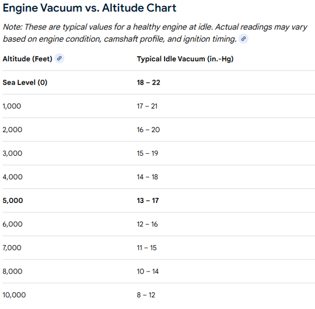

I live at 6,000 feet and was wondering why my idle vacuum on our L71 was low 'compared to normal' (I knew it would be on the 'low' side due to the cam, but...). I had one of those dooh moments about our altitude. Our idle vacuum is actually spot on for our altitude. This is another thing to take into account depending on where you live. The 'estimator' listed above by 69L88 above takes that into account - cool! Best, Paul

WOW!
An inch vac per 1000 feet.
And Denver is at 5000 ft, down 5 inches!

WOW!
Yep, surprised me too. Our new home sits at 6,000 feet and I felt much better when I realized this after doing some research. Makes a difference! Best, Paul
