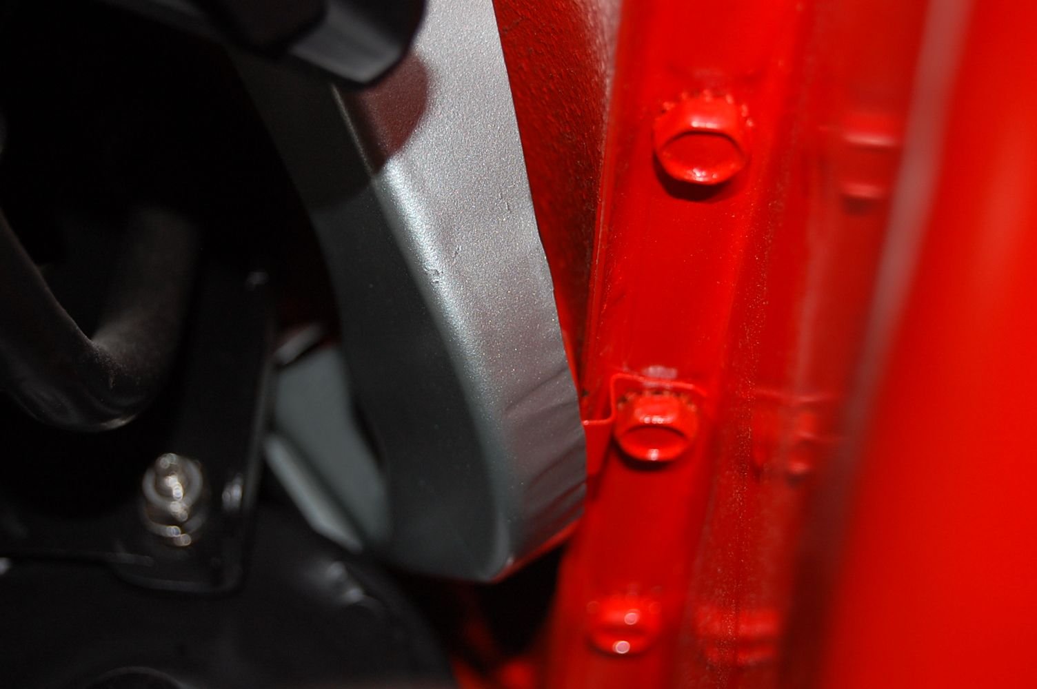

I am thinking the clip in my attachment for my L48 goes under the pan bolt head?

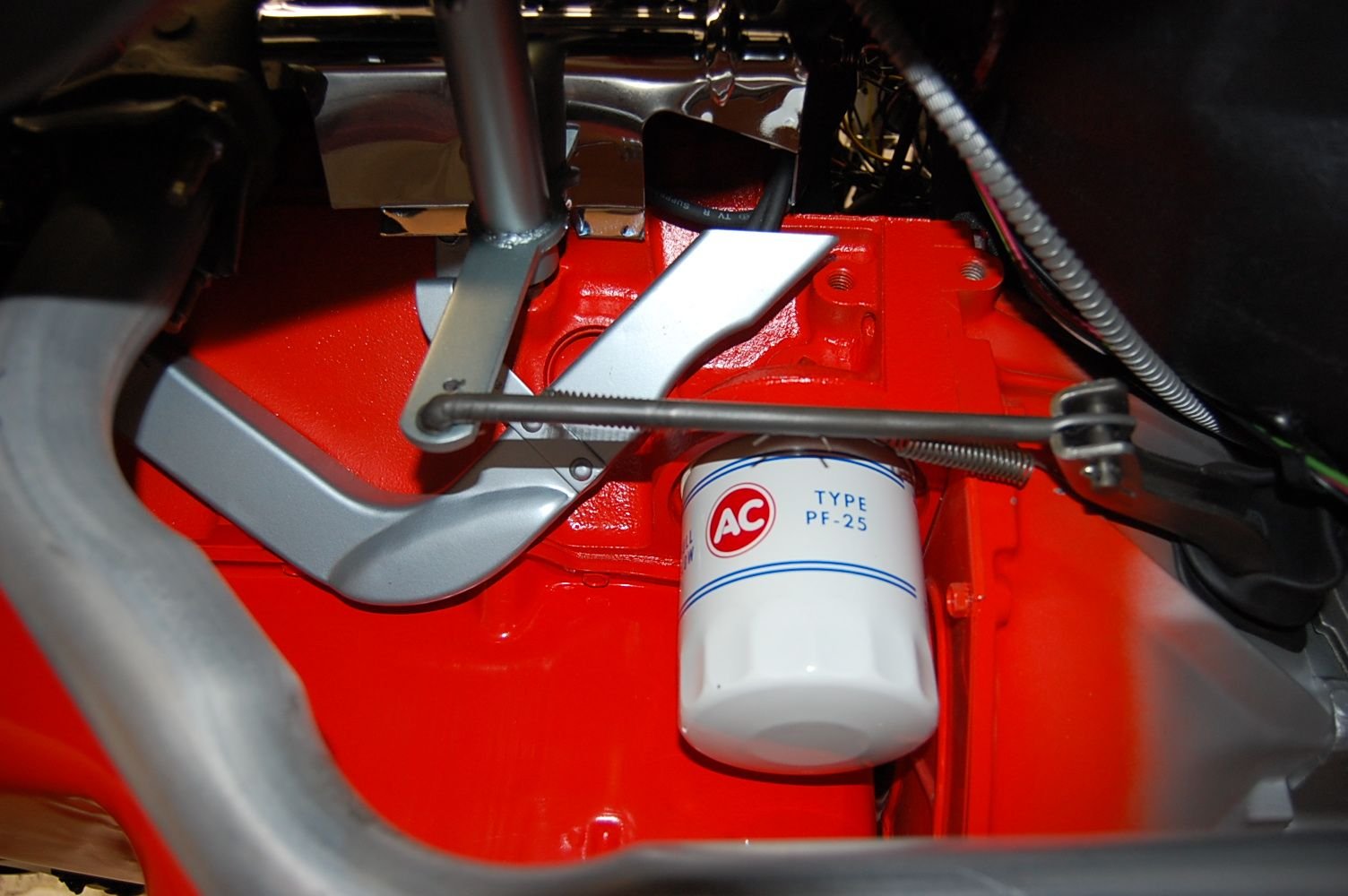

Hello,
Here?
When installed the clip is mounted on one of the oil pan bolts and supports the 2 forward spark plug wires under the boomerang heat shield.

Originally Posted by Alan 71
Hello,
Here?
Regards....
Thats what I figured, thx for confirming Alan. Steve
