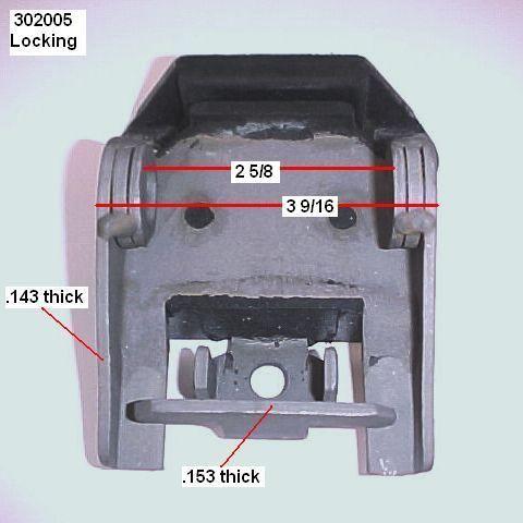

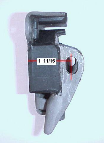

Originally Posted by jthornton
For a low power cruiser, what mount is the best?
These will work just fine for your car:

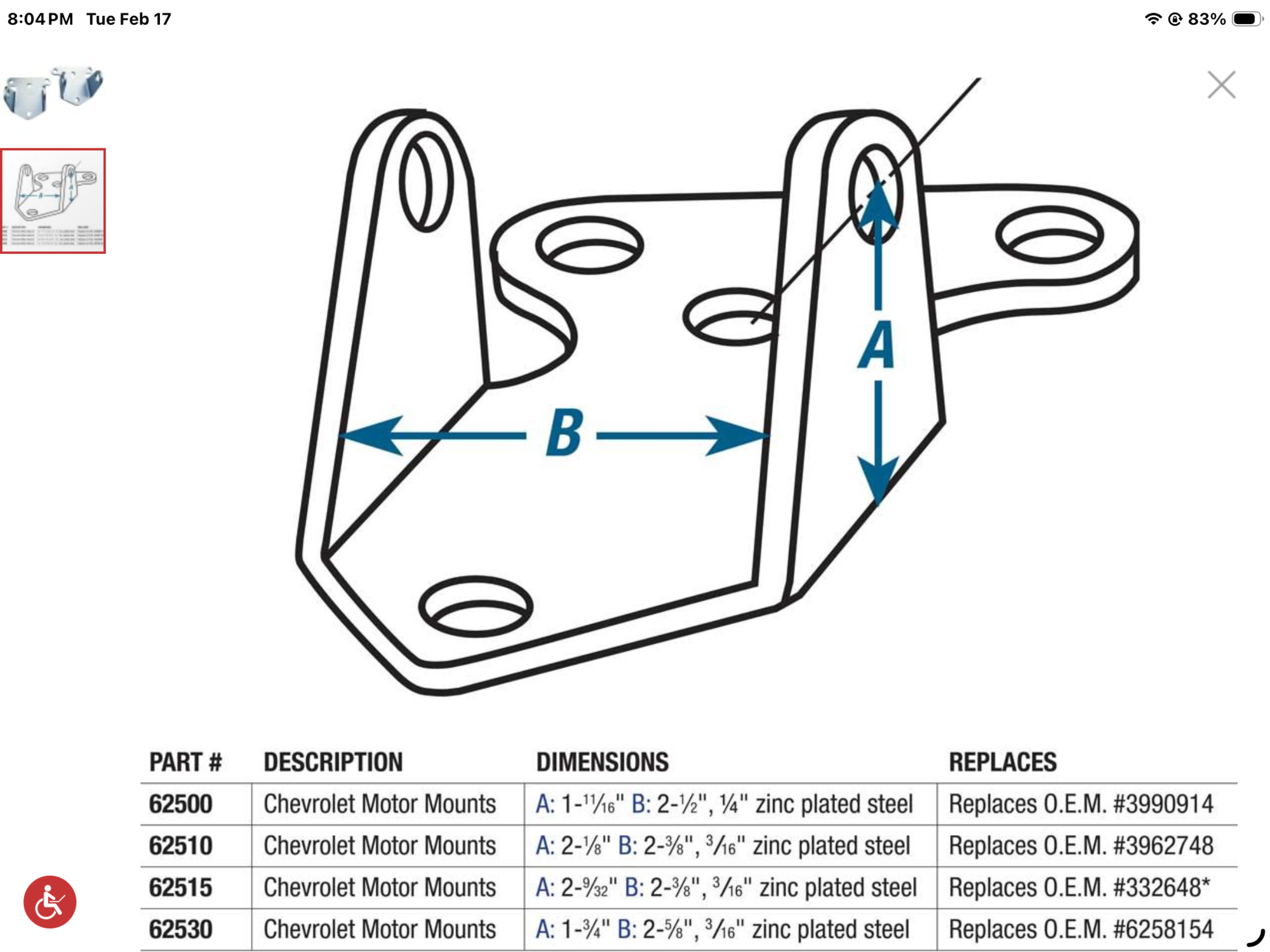

This is from Moroso’s website.
@Peterbuilt ‘s post #6 shows the stock GM mount “A” dimension at 1 11/16” and the “B” dimension at 2 5/8”.
Looks like the 62530 is the one to get, albeit 1/16” taller then stock.

From a corvette vendor like corvette central.
The common parts store ones (anchor?) the metal is about 1/2 as thick.
Early C3 have solid mounts, til 72.
73+ cars had thick rubber mounts, different animal.
No C2 or C3 Corvette used solid engine mounts, all had rubber cushions. (Maybe I'm misunderstanding.) The C2 and first couple years of C3 used a non-locking rubber mount and then GM moved to the locking style rubber mount. The locking mount came to the production line in 1970. All are backwards compatible with the locking upgrade replacement.
