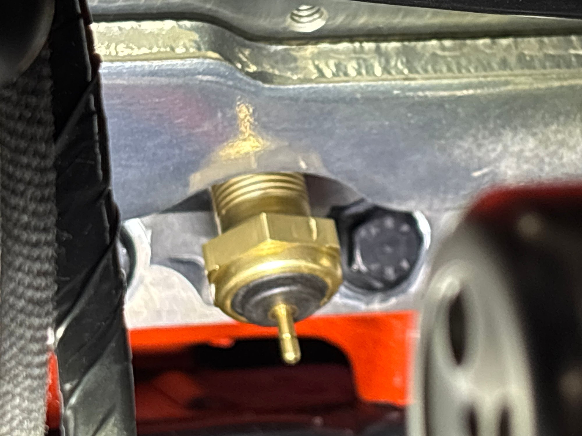

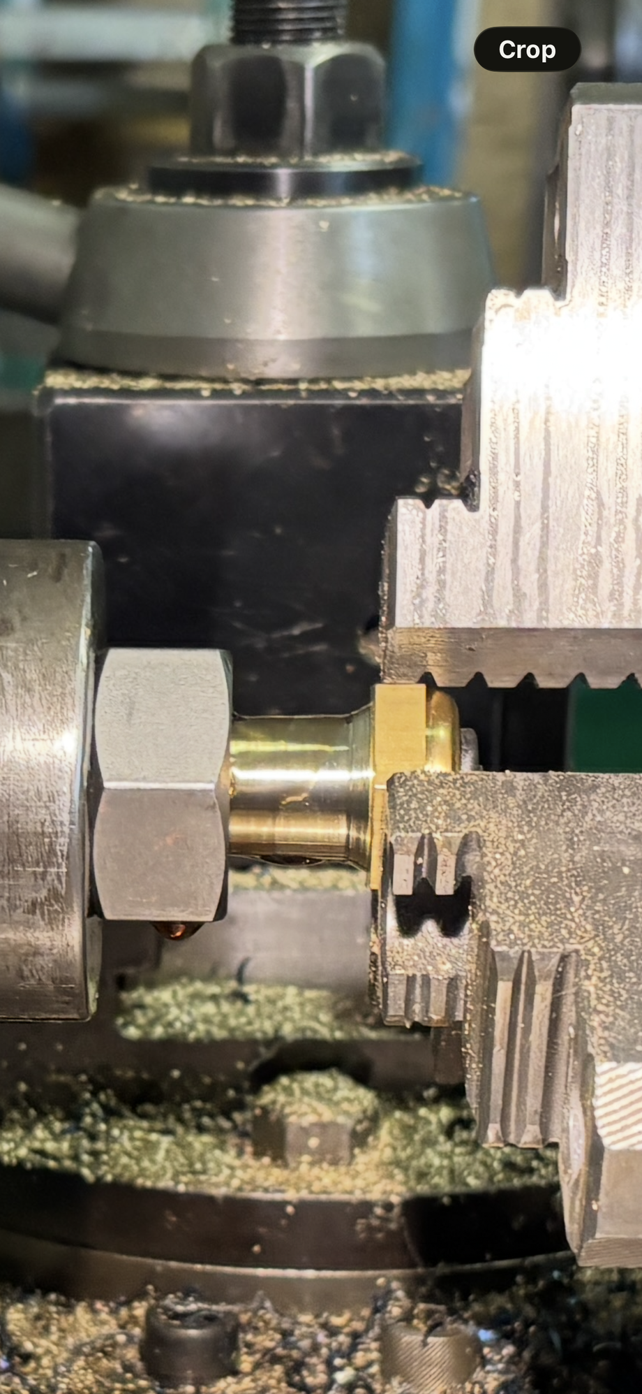

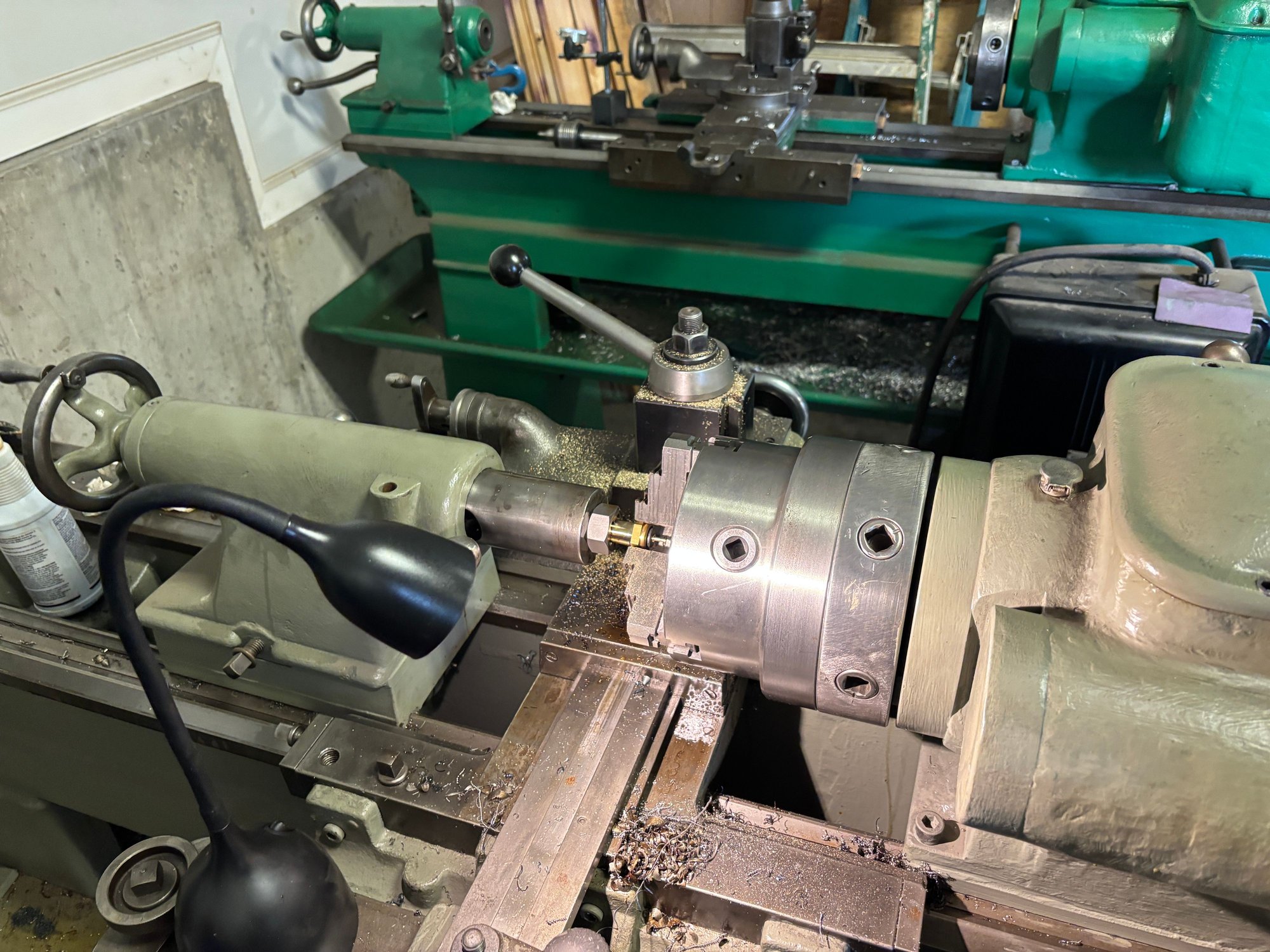

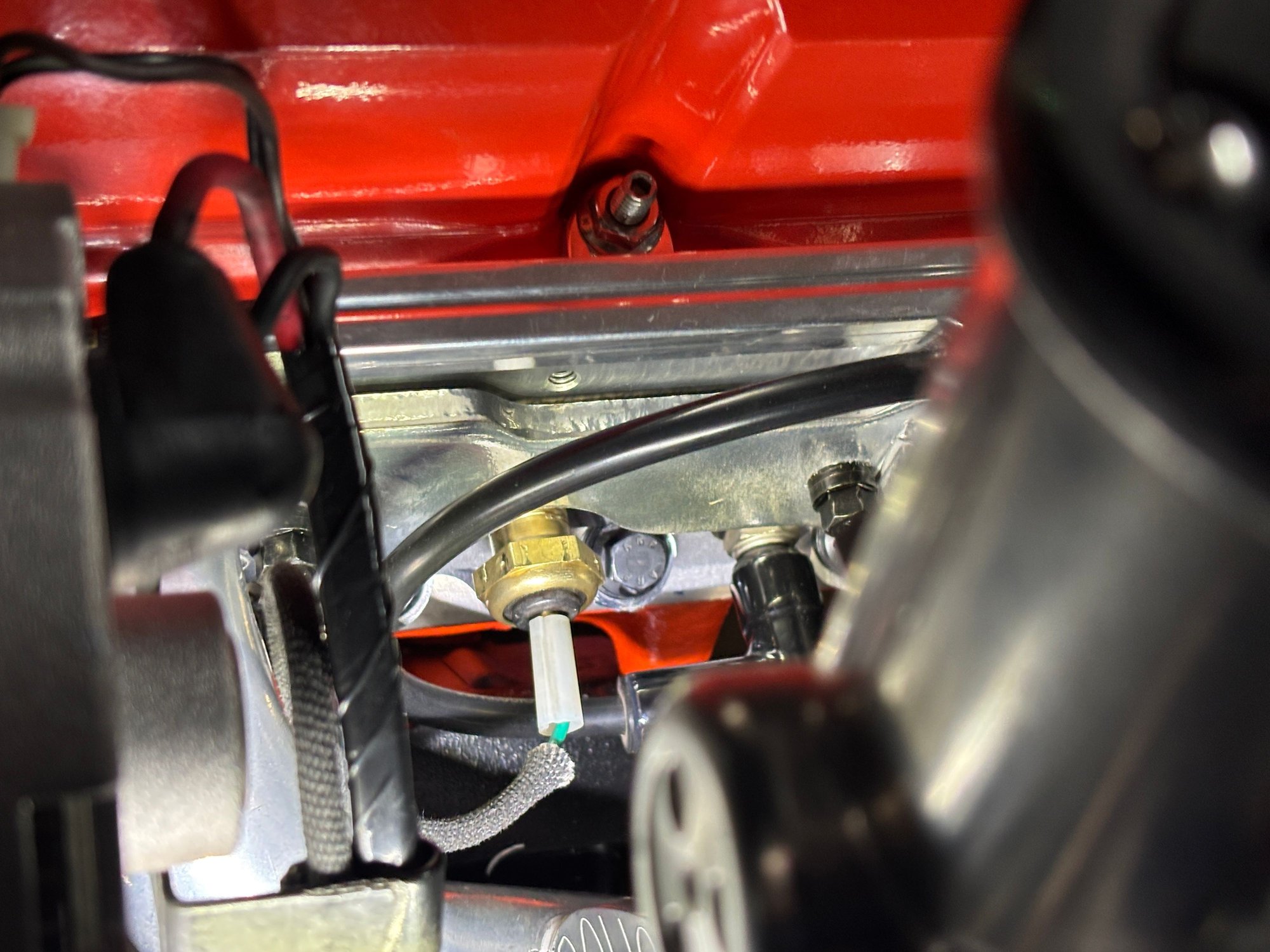

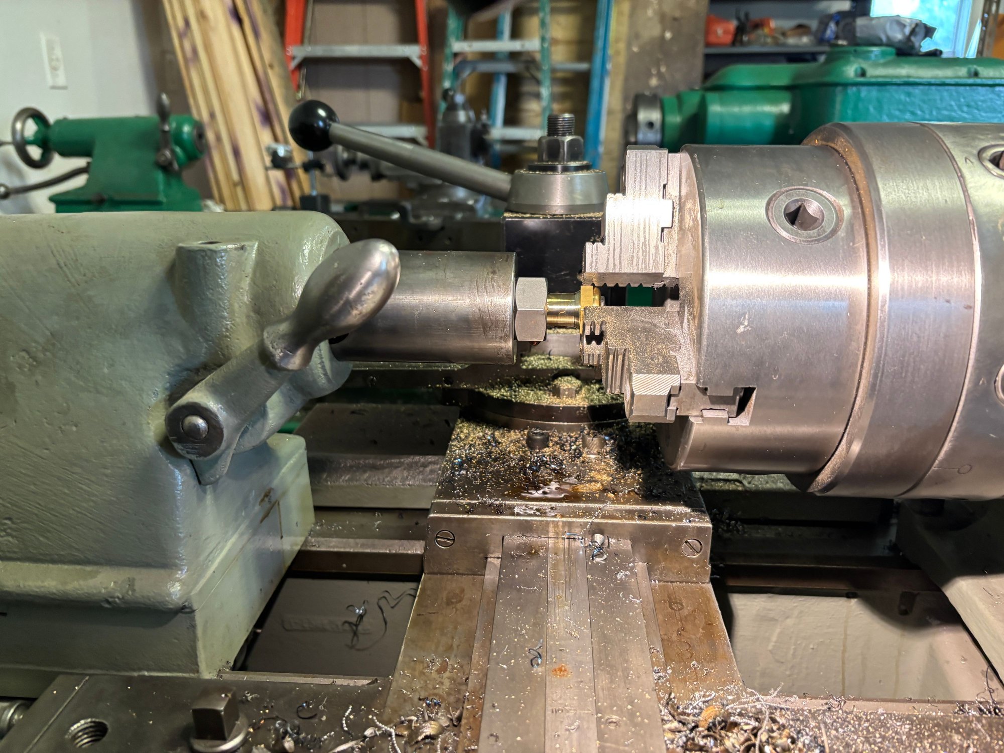

I ran into this same issue back in August when I got my engine back from the builder. Previously had Edelbrock heads on it where the the head was milled correctly for the factory style 1/2" thread sensor. However, as part of the engine rebuild, I upgraded to a set of AFR heads and then ran into the same issue where the sensor would no longer screw in. Unfortunately, didn't catch this until after I got the engine back. Surely wasn't going to tear the engine all back apart to have the temp sensor hole milled out. I considered moving the sensor to the top of the intake manifold, but really didn't want to butcher the new engine wire harness to extend the sensor wire up to the manifold. Luckily, have a co-worker that is pretty much a jack of all trades kinda person. He has a lathe at his home shop and was able to mill the sensor down to 3/8" so it would fit the new AFR heads. I had a spare sensor laying around anyway, so brought him two sensors...one to practice with (since he wasn't sure how it would work) and the other sensor to be the final piece. Prior to doing the work, he had me order up a 3/8"-18 NPT Hex Die that he could use on the lathe to cut the new threads with ($15.00 on Amazon). Everything worked out perfectly. Sensor screwed right in to the head with no issues. It has been on there for about 6 months now without issue. So, if you are unable to source a different sensor that will work, you might see if you can find a local machinist or someone that has a lathe that can machine yours down as well. Just a thought...
