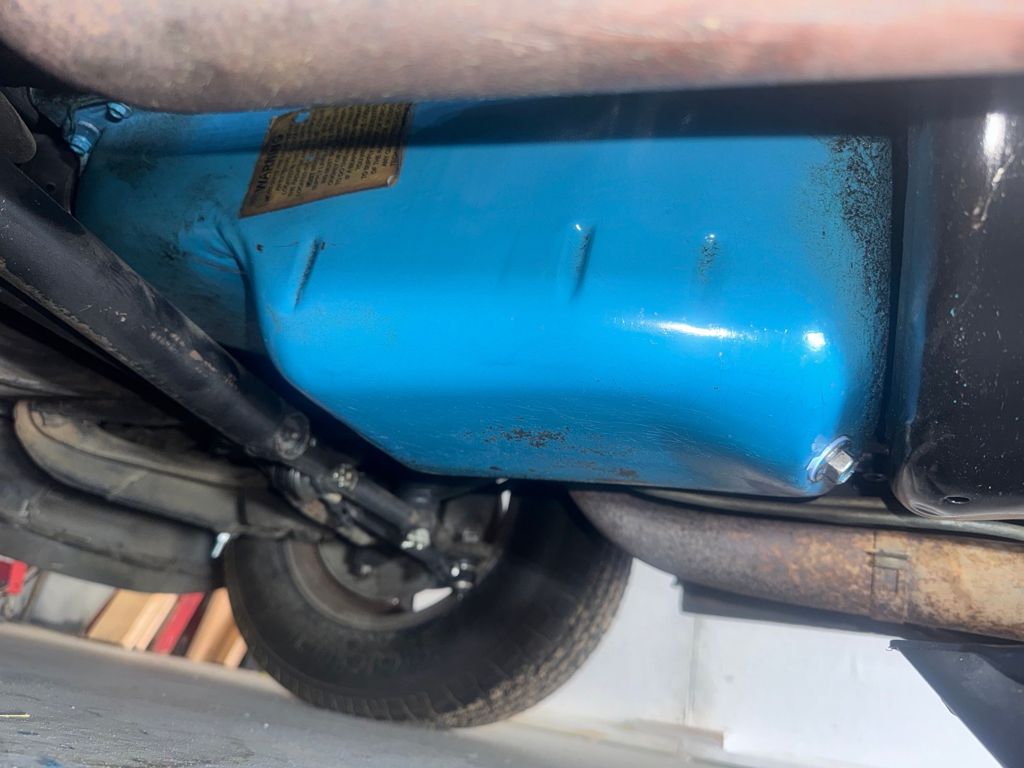

Hey guys …I’m pretty sure I already know what the majority of answers will be here but I’m interested to see if anyone agrees with some local answers I’ve gotten…
so I have a 1981 cream-puff that had a Jasper Engines rebuild (using the original engine) in 2005.
The car has 9000 miles put on it since the new engine install. The last oil shop sticker was still on the windshield so I called the number and got the info of what oil was put in it. Pennzoil Platinum 10w30 full synthetic. At least two oil changes with that oil.
So now let’s go down the ‘Zinc’ rabbit-hole. The car is 100% completely stock with the CCC and the stock catalytic-converter. High Zink causes CC damage so I’m told.
long story short is I’ve been told at least twice that a low-compression flat tappet motor with stock valve-springs that’s already broken in with 9000 miles will do fine with the Pennzoil Platinum.
Thoughts?

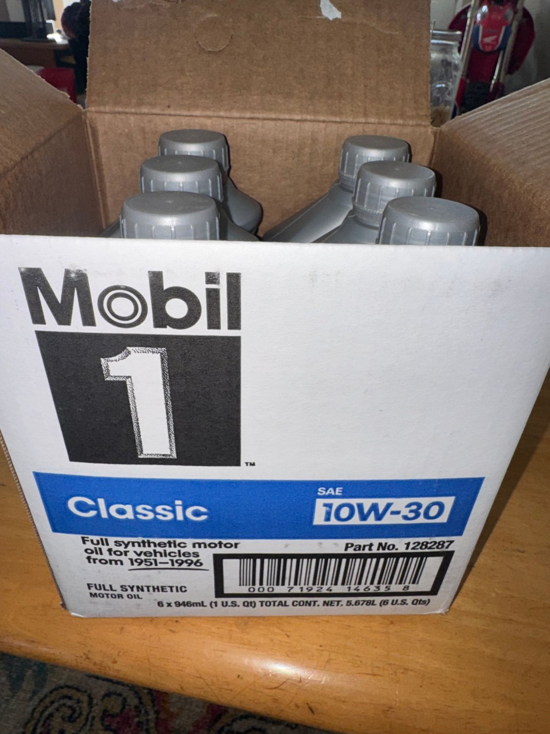

Thanks for the reply. Yea I’ve already ordered the Mobile 1 Classic which wasn’t cheap but I’ll only be changing the oil on this car once a year.
like Piersonpie said it’s easier to replace the cat than the engine. If the cat ever fails I’ll bolt in a test-pipe of the same length. The CCC apparently doesn’t need the Cat as long as the O2 sensor is still installed and working…

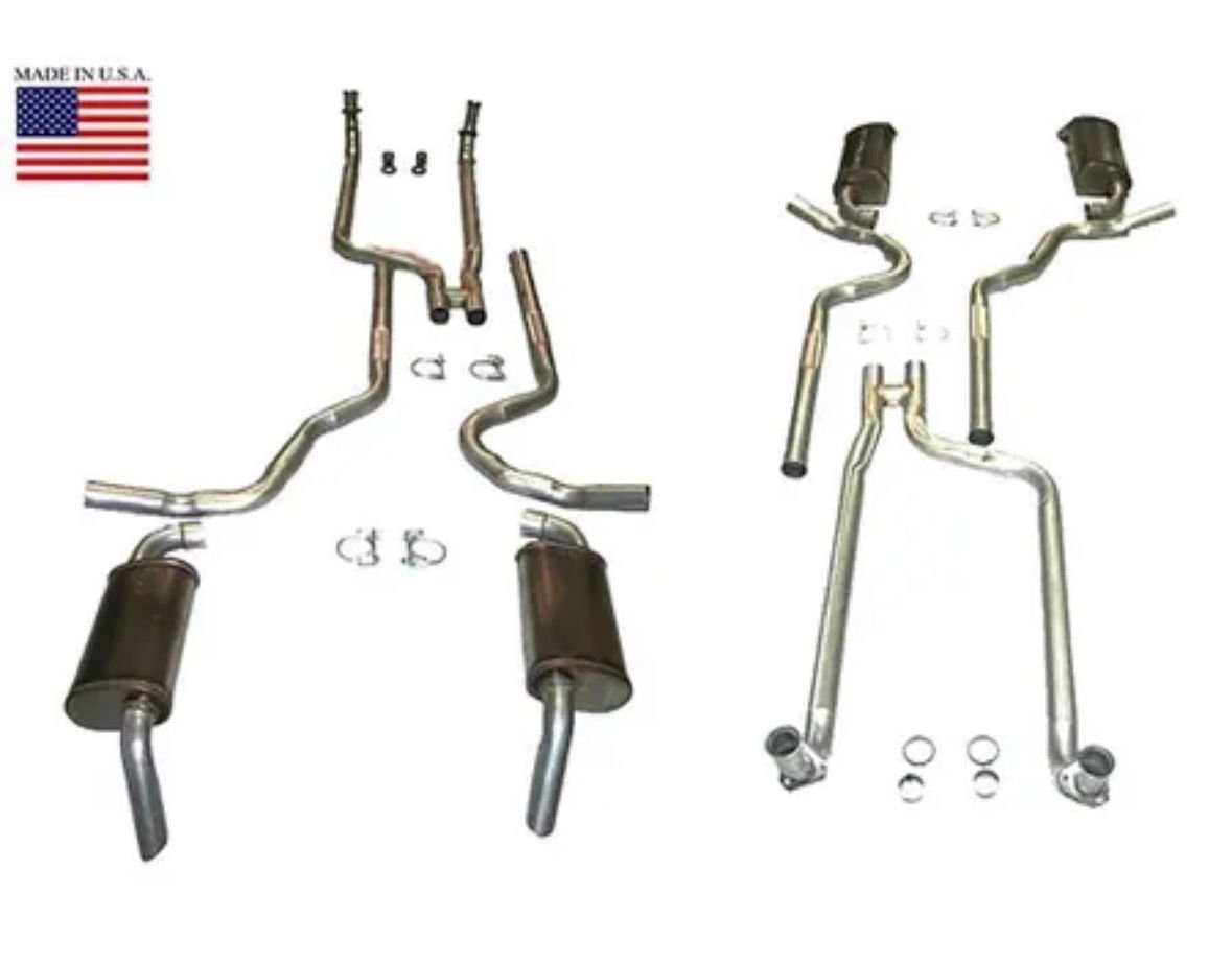

Just got the Mobile 1 FedEx yesterday. See how it goes. Ecklers has 81’ CATS for $240 so if it fails not that big of a deal. Or could just bite the bullet and so true duals …Corvette Central has a kit with the bung for the O2 sensor.
https://www.ecklers.com/1976-1981-co...iABEgKXA_D_BwE

I don't think you'll have any problems. Your O2 sensor is upstream of the cat. If you do ever have to replace it (in 100K+ miles), you'll want to convert to a true-dual with twin high-flow cats anyway.
