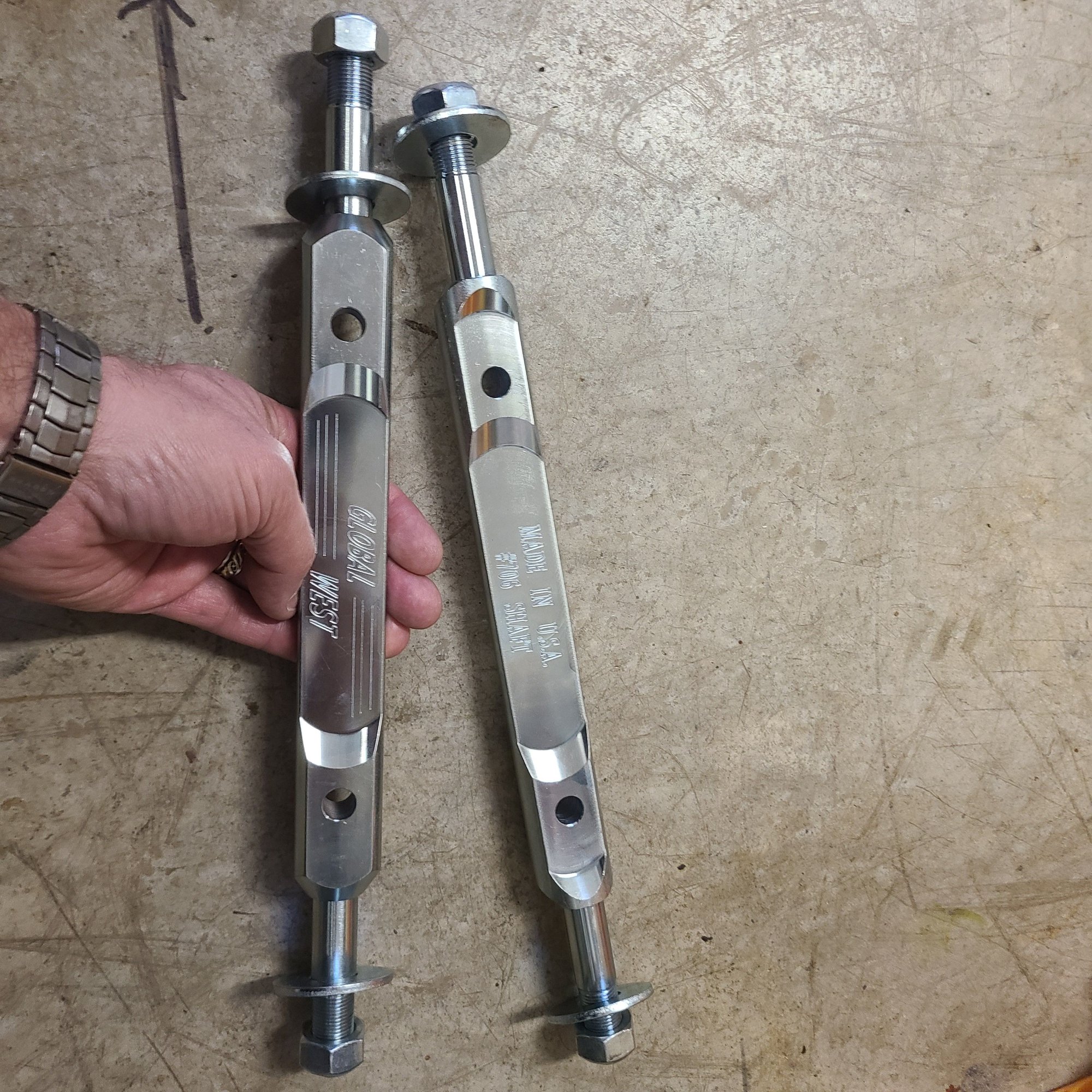

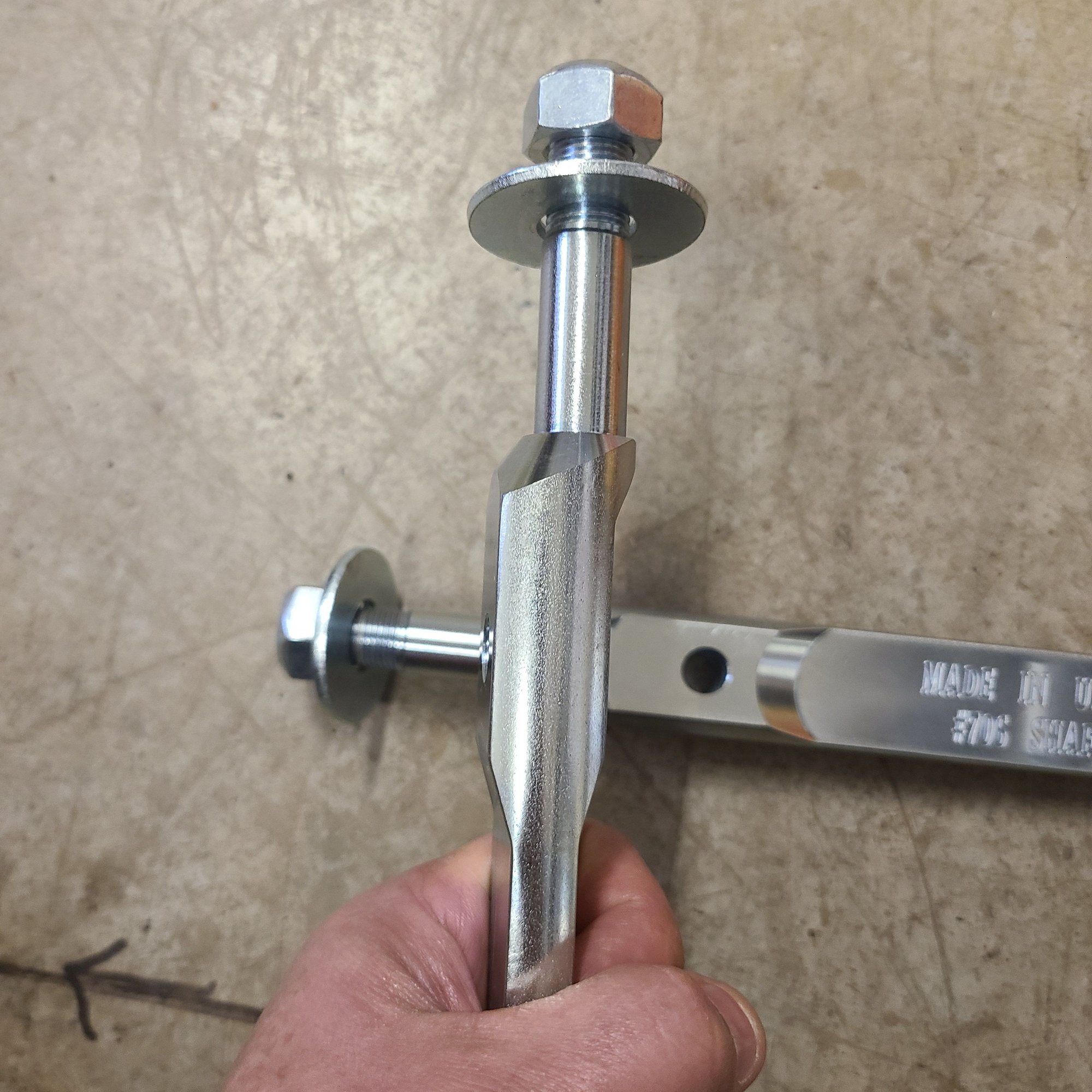

I purchased the Global West ones and since I want to replace the ball joints I figured to do everything and make a complete set to just swap out when I’m ready..
Global West shafts
Moog Ball Joints and Rubber Bushings
2 New to me “after I clean and paint “upper control arms from (CorvetteBen) for $30 each

Now that I have the offset shafts, does anyone think I should get them slotted because I guess I jumped the gun on my purchase. I really don’t have a problem with camber. I just don’t know if I can get the amount of caster with the shims. How much do I slot them? What’s a good positive caster? I saw 6 degrees caster posted somewhere.

JMO - Start off by seeing where you are first.
First, set camber at zero. Then, see how much caster you can get while still holding camber in check. Move the shims from the front spot to the back spot to max out both drivers side and passenger side for caster while holding camber at zero. Move the whole stack if you can, but the camber needs to stay at zero. Camber moves the wheel in-out by adding or subtracting 2 equal thickness shims at the same time on the one shaft. One front shim one back shim - to maintain camber. The limit is when you have zero shims in the forward position but still have zero camber. Then reduce the caster for the higher caster side so it matches the other lower caster side that is already at max. This is pulling a shim out of the high stack and reinstalling it at the lower stack until you are equal caster on both left and right sides of the car. Adjust camber as required with equal shims (add or subtract, if any left) Now you should have caster maxed out for what you have available and camber set to zero. Double check the settings and tighten the fasteners.
Set the toe and drive it.
The modified arms cut slots will allow even more caster, but try it with the existing holes first to see if that is good enough for you is my advice.

If you just have the shafts, but haven't built the A-Arms yet, I'd get them modified now, or return them and get modified shafts. Or SPC UCAs, and save a bunch of effort.
