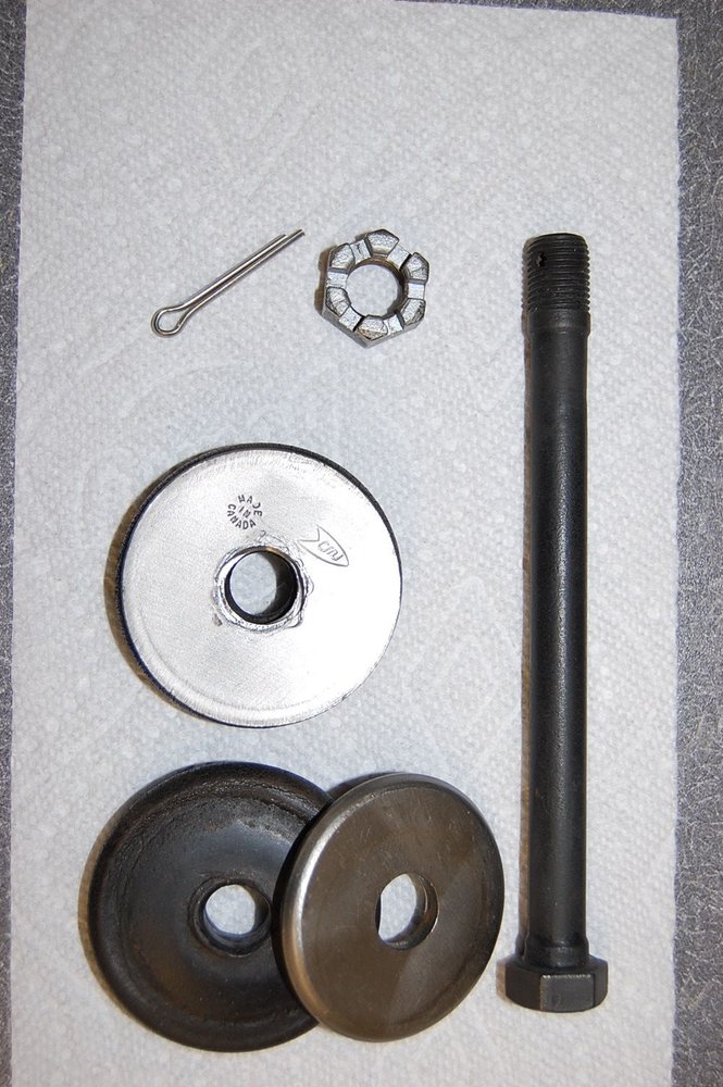

While removing the old rear shocks on my 69 I found that the cupped retainer washers at the lower end are missing. I see that replacements are available from several Corvette suppliers, but I’d like to avoid high shipping charges for low cost items (common issue with most suppliers). I’ve played around fabricating substitutes with somewhat thick washers using my hydraulic press. They look much like photos on supplier websites, but I wonder how critical is the shape or other factors. Any tips will be appreciated.

Hello,
I think the purpose of the washer is to keep the bushing from completely flattening out by speading as time goes by.
Even on bushings that have lots of miles on them the 'cup' has kept part of the bushing at it's original diameter and also centered on the bolt.
$$ ? Yes!!!!
Regards.....
Note unusual configuration of bolt.

Thanks Alan 71. Based on your information I think my MacGyver washer will work.
