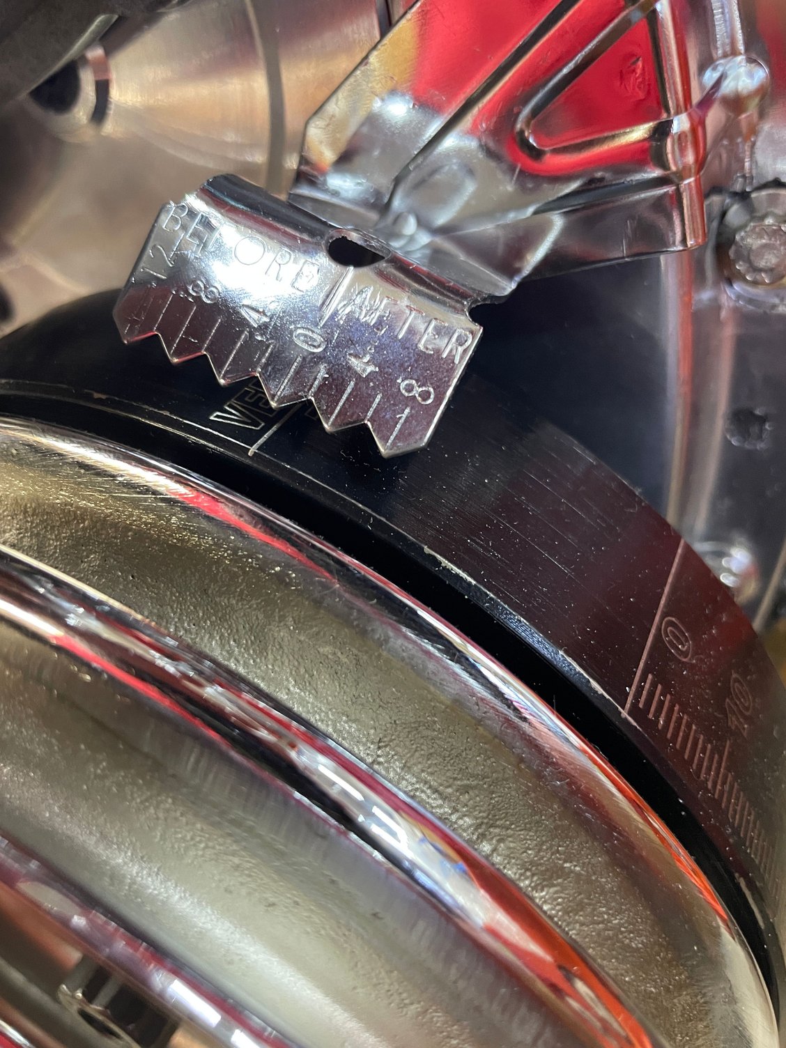

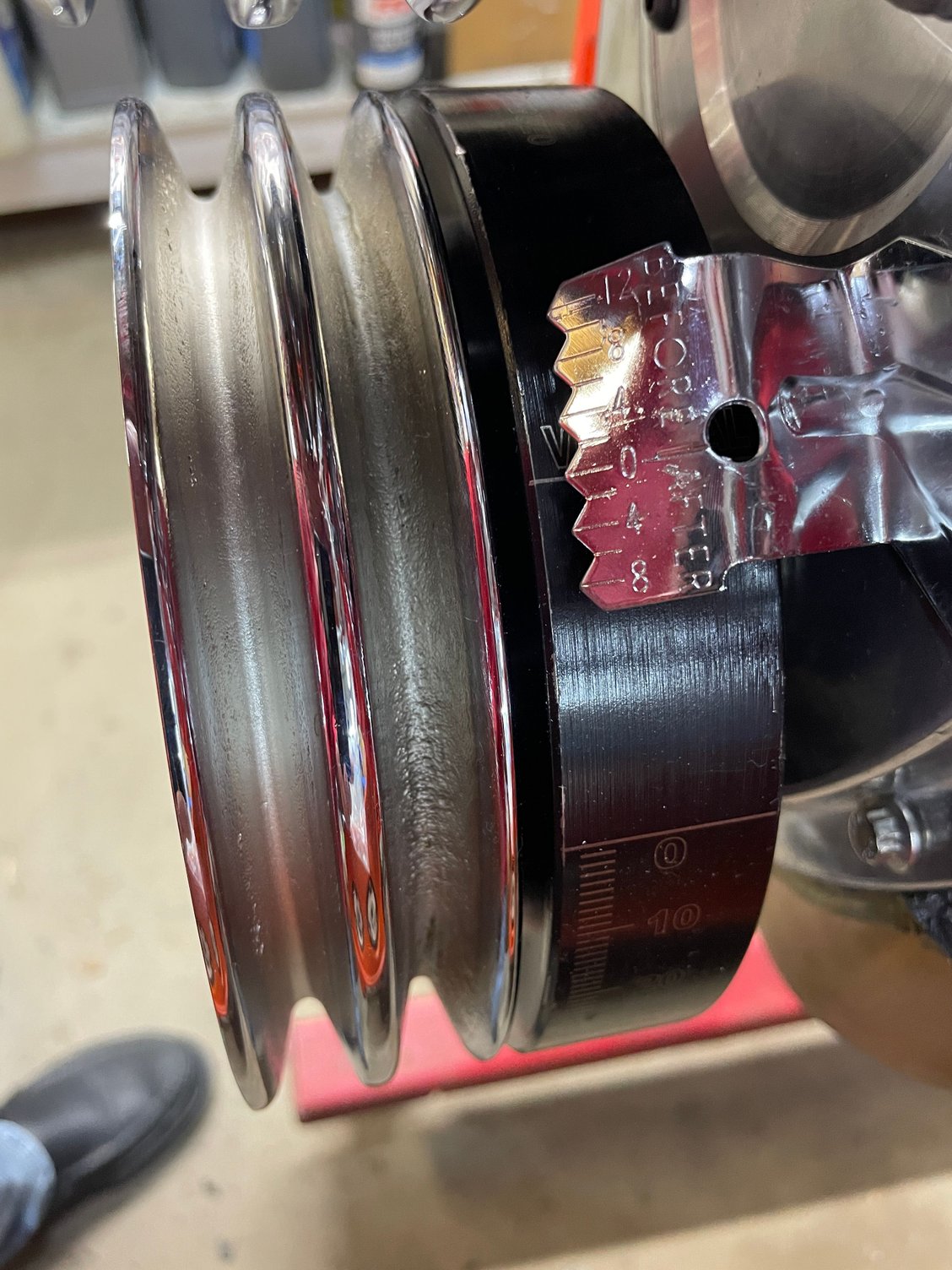

Thank you for all the responses and I greatly appreciate all of the insight. I have uploaded pictures of the damper and how I bent the pointer.
all three pulleys line up perfectly (WP, Alt. & Crank) The damper is part number SCA8000 and I have contacted Scat to see if it is, in fact, the wrong one. Here are a couple of pictures.

That looks like a 7" balancer, to me, not an 8 inch one.
It is not close enough to the pointer.
The pointer looks like an 8" one, which is what an LT-1 or L82 had.
Look how close the tab is to the dampner in post 5.

Yup, either damper not 8" OR as below, that lower pulley oversize diameter and/or timing tab bolted to TC in wrong position.
Also, dollars to donuts that chrome pulley was never OE on a C3.
? tell us please, what torque value did you tighten that damper to ?
? did you employ Any spacers ?
* I peeked online --- scat P/N SCA8000 described as having 6.75" OD
Me thinks scat sent you the wrong & smaller damper for LT1.
Will it work ? If it torqued down correctly, yes it'll work
*** you should closely check and VERIFY piston #1 is truly at TDC when damper zero marks are aligned.

You might be better off with the right pointer
click that. The Pro Form pointer is inexpensive and gets the job done. GM sells a similar one too.

Anytime you use any non original parts in that area, you should carefully check TDC of your new pointer/balancer system.
The racers I know just grind the tab to a point anyway, and use a dial back timing light, and/or a fully degreed dampner.
I have seen many race engines done like that, and even tho the tab is ground to a point, true zero is normally 1-2-3* off of zero on the tab.
All the ones that bolt on bend easily. The welded on originals were tougher.

That SCA8000 is Wrong damper because it's the Wrong, 6.75", Too-Small Size.
And ya have the wrong tab because it's made for a larger damper and ya bent it to fit.
But all that can function AOK; so long as damper did torque down and press fit firmly against crank sprocket at about 65 lb-ft.
OR get a Correct 8" damper and another tab made for 8" damper.
