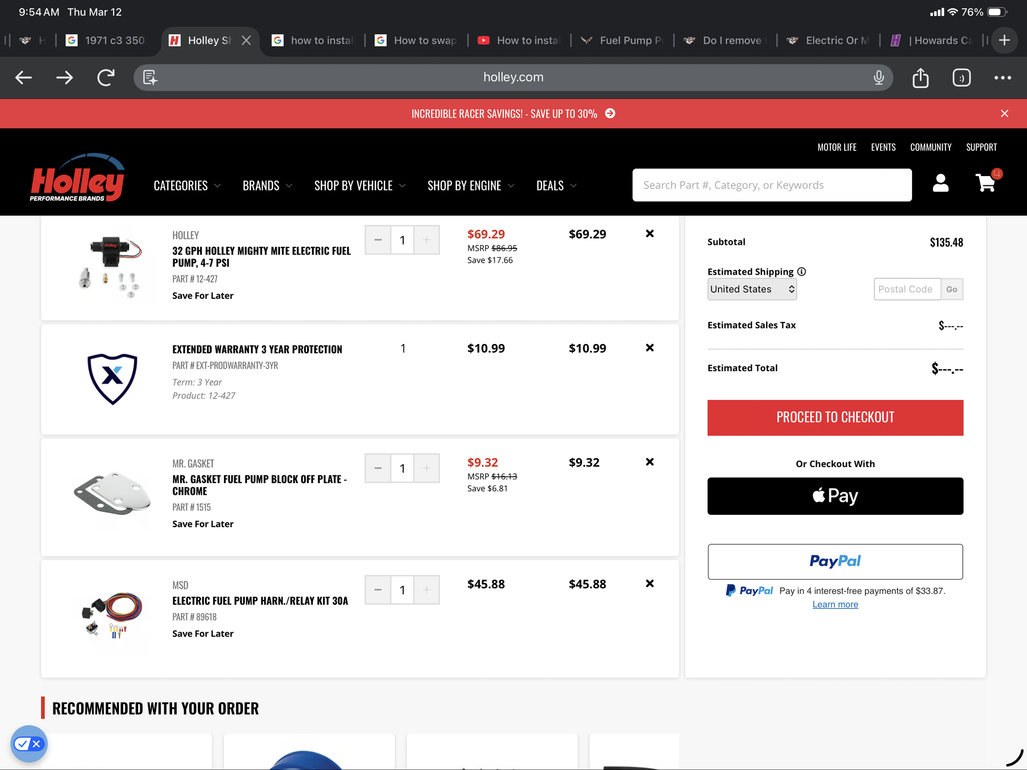

I have been fighting this hard starting, when hot issue since I got the car. ( ‘71 350/270 4 speed, stock rebuild ) The OE correct Q-jet was recently rebuilt and performs perfectly. This occurs when the car is at operating temp, shut off then trying to restart. It could be after only a few minutes, but usually after it’s sat for awhile ( 1-3 hours ) and it always requires at least 4+ seconds of cranking and pumping the gas (twice) sometimes 3 times and holding the pedal to the floor. When this happens the only way it’ll start is to give it a shot of starting fluid.
I’ve added a phenolic spacer. Nothing. Once it starts, it runs perfectly. No hesitation, stumbling or bogging. Several people have told me that they think the fuel in the bowl is evaporating causing this hard starting, excessive cranking problem. They all suggested an electric fuel pump. I think I have what I need for the Electric pump, ( see pic ) Is there anything I’m missing?
I hate to give up on this but I’m tired of never knowing if it will start or not. I’ve been reading all the posts I could find regarding this. I know after I remove the fuel pump mounting plate I’ll be able to remove the fuel pump pushrod. I must block off the fuel return line, as I won’t need it. It should mount at the rear somewhere near the tank. ( Any pics of the best mounting location? )There’s also a third line that connects to the mechanical pump that I don’t know where that goes as I haven’t followed it yet. The Holley pump mixtures is the one the Holley tech suggested. He said he’s used it and it will support up to 400hp. He said I wouldn’t need a fuel regulator either.
If there’s anything I’m saying or doing wrong, or I’m missing please LMK. Thanks, Steve

A electric fuel pump will almost instantly refill the fuel bowl at key on. But your fixing the symptom. Not the cause.
inline pumps are notoriously unreliable. And noisy.
If you really want a electric pump, consider that electric fuel pumps are pushers, not pullers. A intank pump will likely be far more reliable and of course less noisy.
Oh, and I don't see a pressure regulator on your list.

Having run across this several times in the past, here is my suggestion. Before trying to start the car, pull the air cleaner and look down the throat of the carb while you manually pump the gas. If you don't get a strong stream of fuel from the accelerator pump, then the carb bowls are probably dry. Cranking the engine will eventually refill the bowls. There are a couple of aluminum plugs on the base of the carb that are notorious for developing leaks and draining the bowl when the car sits for any amount of time. The old school fix was to JB weld the plugs. You can drill, tap, and plug for a more permanent fix. I just did this repair on a friend's Q-jet. Google is your friend. Good luck.

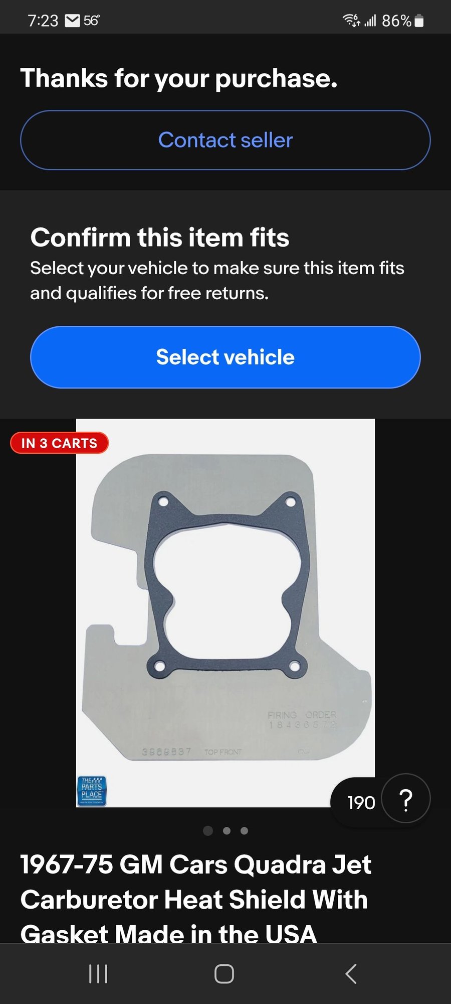

GM designed an aluminum heat shield that prevents radiant heat from getting to the carb bowl. This is not a "spacer" type of heat insulator that would prevents "conducted" heat. This is a thin aluminum plate that is a few inches wider than the carb base so it prevents heat radiating up from hitting the carb fuel bowl. GM designed one for the Holley type square bore carbs and another one for the spread bore Qjets. I added one when I started having this same issue and the problem went away.
Ebay seller thepartsplaceinc has them. I'm having trouble posting a link.

Thank you for that. I ordered one.

Be sure to put the new thin gasket on the intake and the thick regular gasket on top of the aluminum plate or it will mess with the choke linkage.
