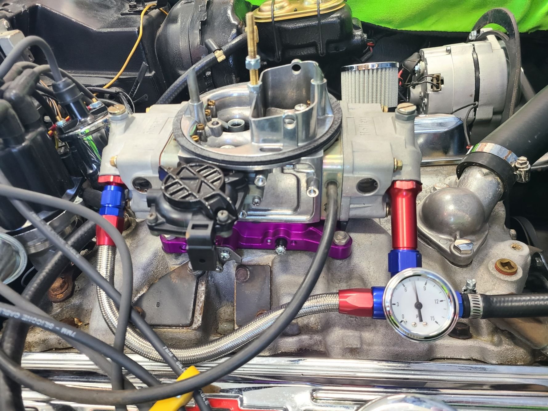

Not to sound like a jerk but PLEASE get rid of that glass fuel filter. I once saw a beautiful 69 Camaro burn to the ground because of one. I don't want to ever see anyone go through that again.
I like your carb. It looks like something I would build. I would cut the choke tower off especially if using a drop base air cleaner.

I agree. The glass filter is temporary though. This car sat for 20+ years. When it was resurrected, a new tank, fuel lines, etc were put in. But not a new FP. I experienced junk in my carb that was clogging up float valves after I had to cut the filter off. (it was installed directly on the Holley FP when the motor was out and could not be removed in car. Don't ask me how they thought that was a good idea) The glass filter is to see if any more junk is still in the system before I switch over to the Holley aluminum one. Going to run it a few more times before I switch over. Not a fan of these filters, at all, except for this one purpose.
Using a drop base, but with the K&N filter top. Debating on cutting the horn, or installing a choke. Surprisingly even in winter starting was not to overly bad without a choke. Will probably just cut that sucker off.

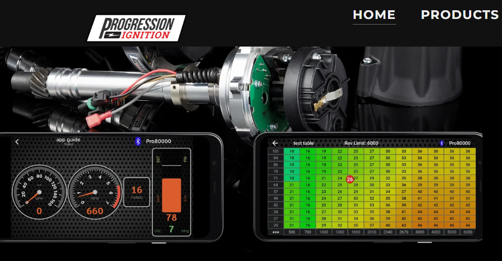

Do you have an adjustable timing light?
It's not that hard to do yourself.
I see you have a 2016.
Perhaps you would prefer the smart phone adjustment option:
It is crazy powerful.
It's $569 with the small cap tach drive corvette version.
Includes full timing map, vacuum advance, rpm limiter, launch retard, start retard, security disable, multiple timing curves, and much more.
By far the best way to tune vacuum advance is on the road, under varying loads. Not by mail.
This lets you change it, even while you are driving, one cell at a time, or load a new curve with a one button push.
I will keep both a 93 & 89 octane timing curve loaded & ready for my cross country trip.
I am a believer in the power of this fully computerized distributor.
I helped one guy tune his car via cellphone MAP screenshots, from 600 miles away.
IMO a full timing MAP is one of the biggest advantages of an EFI system.
Cold start runability and altitude adjustments are a distant second.
Ease of AFR tunability is third.

What a difference! Wow! This thing runs incredible now! The difference between the Dragonfire and the Progressive Ignition is night and day. I installed new plugs (old still looked new) and wires. Need to tweak the profile a bit, but wow! Thanks!
Of course this was all AFTER I pulled the pan to find the missing washer. That was fun. Idler arm was directly against header. Mechanic who changed the oil used a long filter which sat about 1/2 inch above the header. That was fun too. Lol!
Still installing the GM ZZ4/6 tuned Holley 770 later and changing out the fuel supply side. Hey, its paid for so why not.
