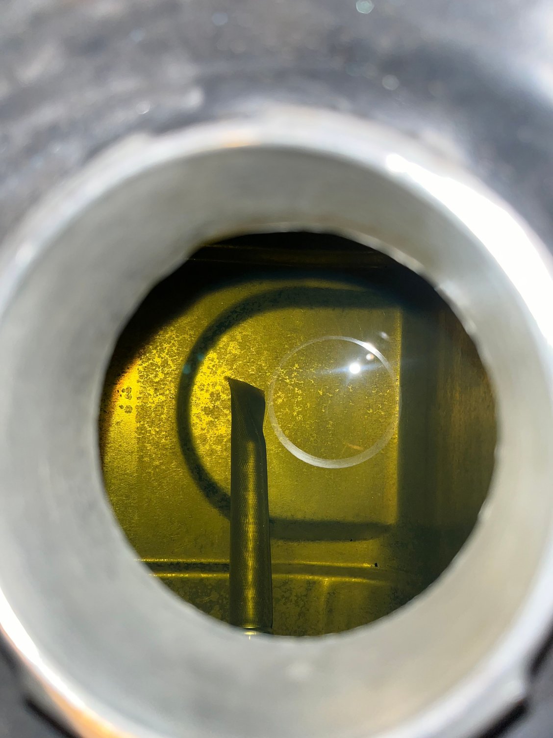

70 LS5 454. Frame off reconstruction so everything is basically new. Drove it a bit this winter with no issues. Around Christmas time we had a beautiful day up here in the smoky mountains and I stropped for fuel at the bottom of the mountain and started to head up. About 3/4 up the mountain it started to act like it was running out of fuel. Every time we hit a flat spot it seemed to once again get fuel and we made it home.Move ahead to this weekend. I towed it down to to Pigeon Forge for the Corvette Expo. Every morning I drove it up to my spot and at the end of the day back to the trailer, No issues at all. The group went for a little run and as we were going up a mountain it happened again and I was stuck. The car was not running hot or anything weird, I opened the fuel neck and did see the gasket in the tank from the cap, I figured the was a problem from earlier possibly not enough pressure to pump the fuel up hill with out that gasket, I fished out the gasket and replaced it. After a couple of tries it fired up and i made it to a turnaround and headed back. Thinking it was cured it made it back to the trailer and died. Back home today and after about a 20 minute run (about 75 degrees out side) it started again coming up the mountain. I kept pumping the throttle and when it would get some fuel i just kept flooring it until i got to the top and made it home. Any ideas? Mechanical fuel pump GM, original Q-Jet carb and slight cam with headers and aluminum radiator. Amy ideas would be greatly appreciated. Bill

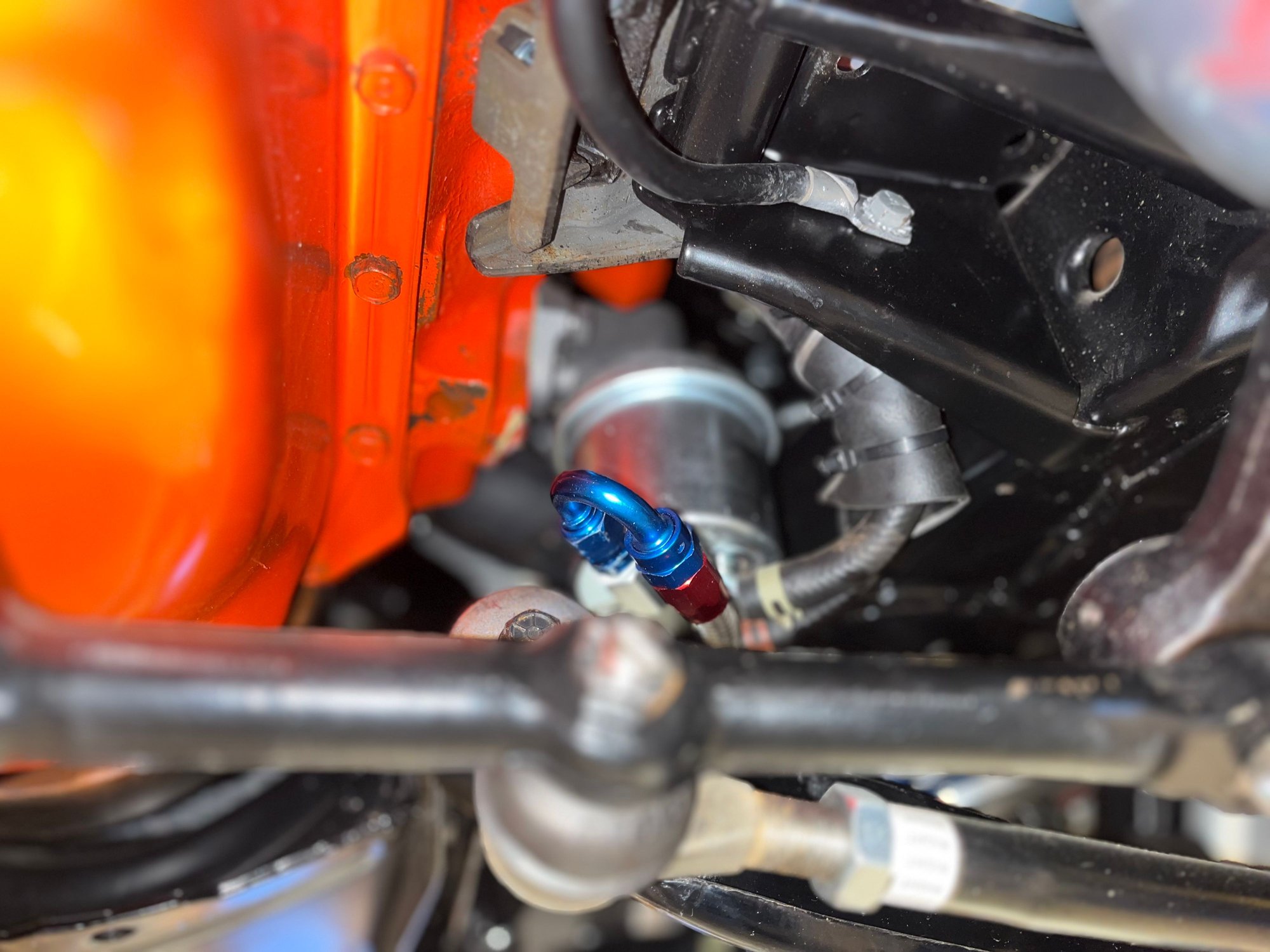

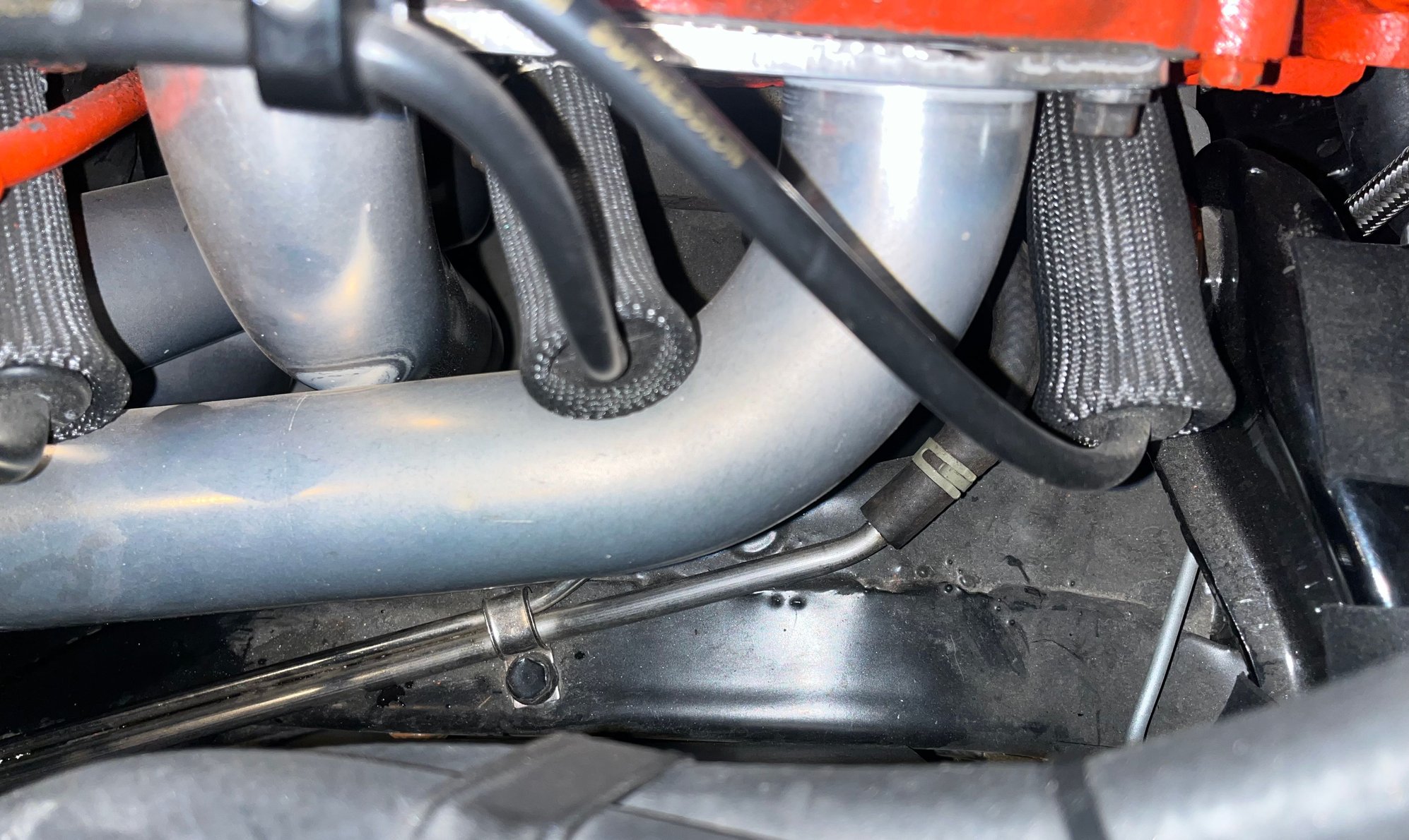

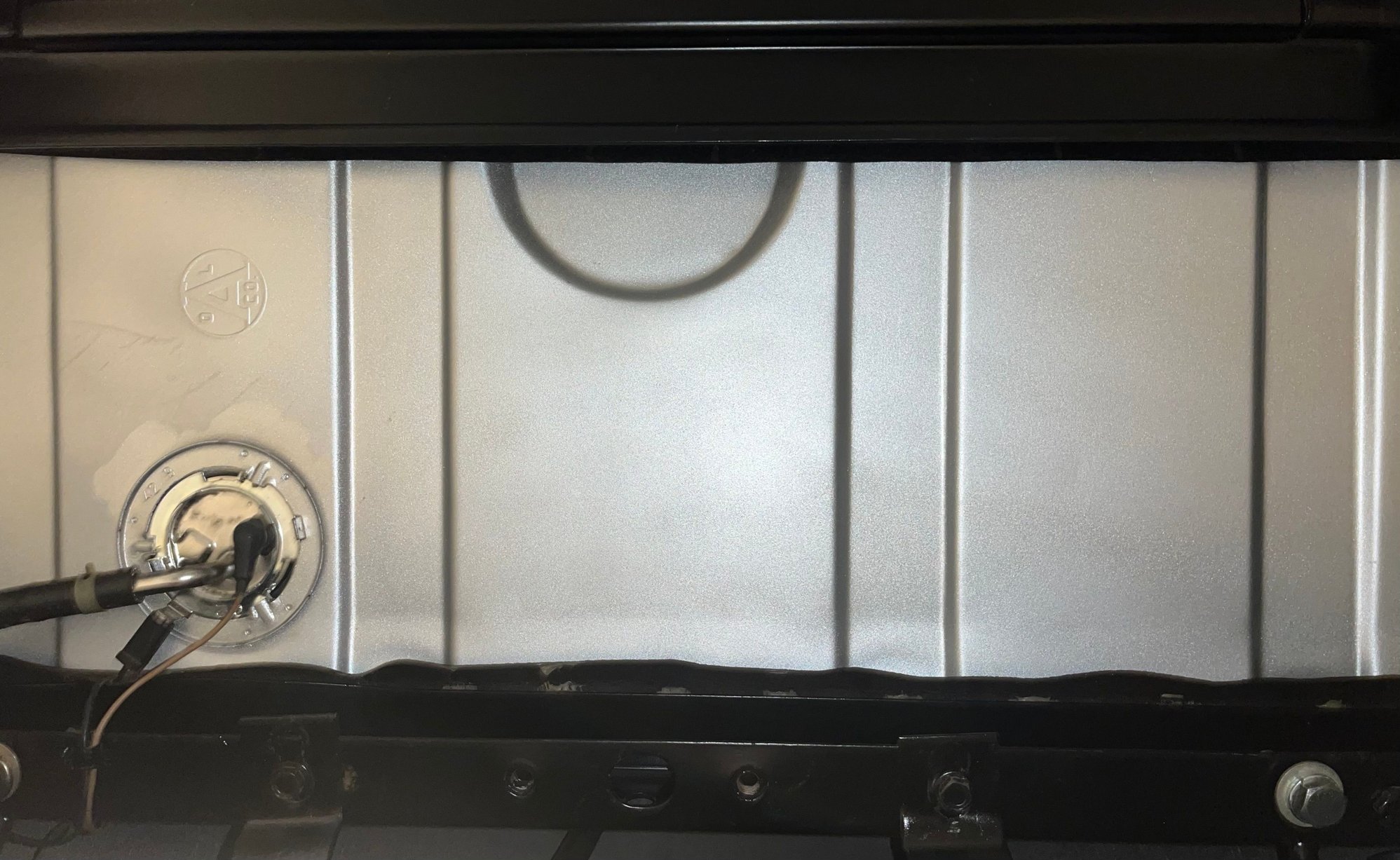

Default Pics of fuel system. Ideas?
I know the header is pretty close to the fuel pump lines. Maybe a shield or insulation? Also the pick up tube looks pretty far in front? Any thoughts or suggestions. Thanks
That does not look like the factory drop down air cleaner.
Do you sufficient clearance under that air cleaner lid to not interfere with the carburetor bowl vent?
Do you have a Quadrajet or Holley carburetor?
