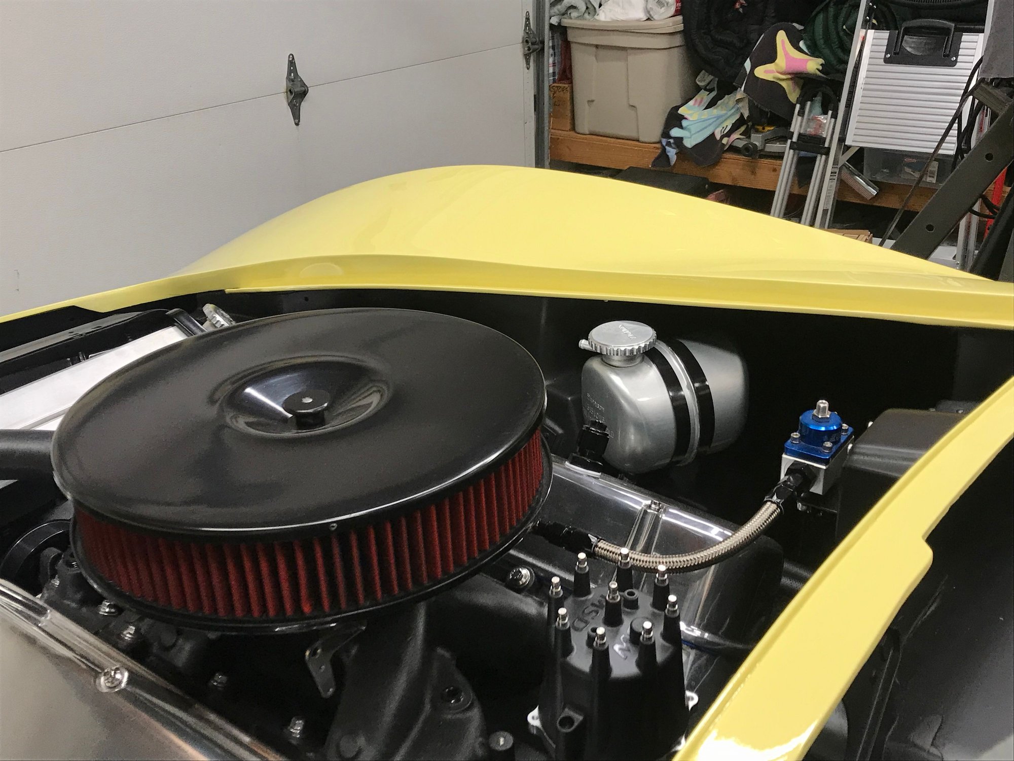

If you have a 2" filter element in a drop base air cleaner housing there is no way that you have adequate clearance between the carb airhorn and the bottom of the air cleaner lid. I have made multiple posts about this. Here are the facts:
A few years ago, I did a bit of dyno testing on air cleaners. What we found to have the greatest effect on engine power and performance is the distance from the top of the carb's airhorn to the bottom of the air cleaner lid. Once this distance gets tight, as it does when people use the drop-base air cleaners with a low-profile air filter to gain hood clearance, power is dramatically affected, and the car will "nose over" at elevated rpm or power setting, much like vapor lock. I found that the minimum distance from the carb's air cleaner gasket on the airhorn to the bottom of the air cleaner lid, to avoid serious upper-rpm performance problems, is 3 inches. Most air cleaners have a 1" "dome", which means that the minimum distance from the air cleaner gasket on the carb to the top surface of the air filter is 2 inches. Anything less than that and you will have issues. So, for instance, you cannot run a 2" tall air cleaner on a drop base - it puts you way below the 2" minimum height required above the carb. Check your heights and clearances. Run the tallest filter you can, and get the air cleaner lid as far above the airhorn as you can without hitting the hood.
To test this, just run the carb without the air cleaner lid installed and see if your problem persists or not. Obviously, if your hood is so tight to the carb that the 3" rule is still not met, you will have the problem even without the air cleaner lid installed, so you may have to "pop" your hood release and run the test with the hood raised and unlatched to verify.

Hey Lars would you it help to run one of those air cleaner tops that are filters when running a low profile drop base if clearance is a problem?
Old Mar 25, 2026 | 12:09 AM
lars's Avatar
lars
Joined: Aug 1999
Posts: 14,380
Likes: 6,391
No - that still interferes with the smooth flow of air into the airhorn/venturis. You need the 3-inch minimum dimension regardless of the type of air cleaner top you use.

[QUOTE=lars;[url=tel:1609529884]1609529884[/url]]If you have a 2" filter element in a drop base air cleaner housing there is no way that you have adequate clearance between the carb airhorn and the bottom of the air cleaner lid. I have made multiple posts about this. Here are the facts:
I will give that a try. I will see exactly how much clearance I actually have with the hood shut. Thanks

I checked today and you are correct. Way under 3” from the airhorn. I can get a standard 3” filter on without the lid but with the lid it hits. I might have to change the intake manifold to a lower profile. This is definitely an issue so thanks for your advice😁

Good job on the setup and check. That could very well be the source of your troubles, and if it's not the only source, it's contributing adversely to your performance - my numbers show that you could be down 15-20hp with the air cleaner lid sitting that close to the top of the carb airhorn. I'd be interested in the results of a test drive with the 3" filter installed on the air cleaner base, the air cleaner top left off, and the hood closed over the top of the 3" element... some aluminum foil rolled up and crumpled around the perimeter of the 3" filter to "squish" against the hood.

I had to purchase a flat Allstar Performance aluminum air cleaner lid to get 2” of clearance between the air horns and lid and still get clearance between the lid and hood with a 3” element.
I’m using a drop base air cleaner, but I’m running a Quick Fuel racing carb so the total design works.

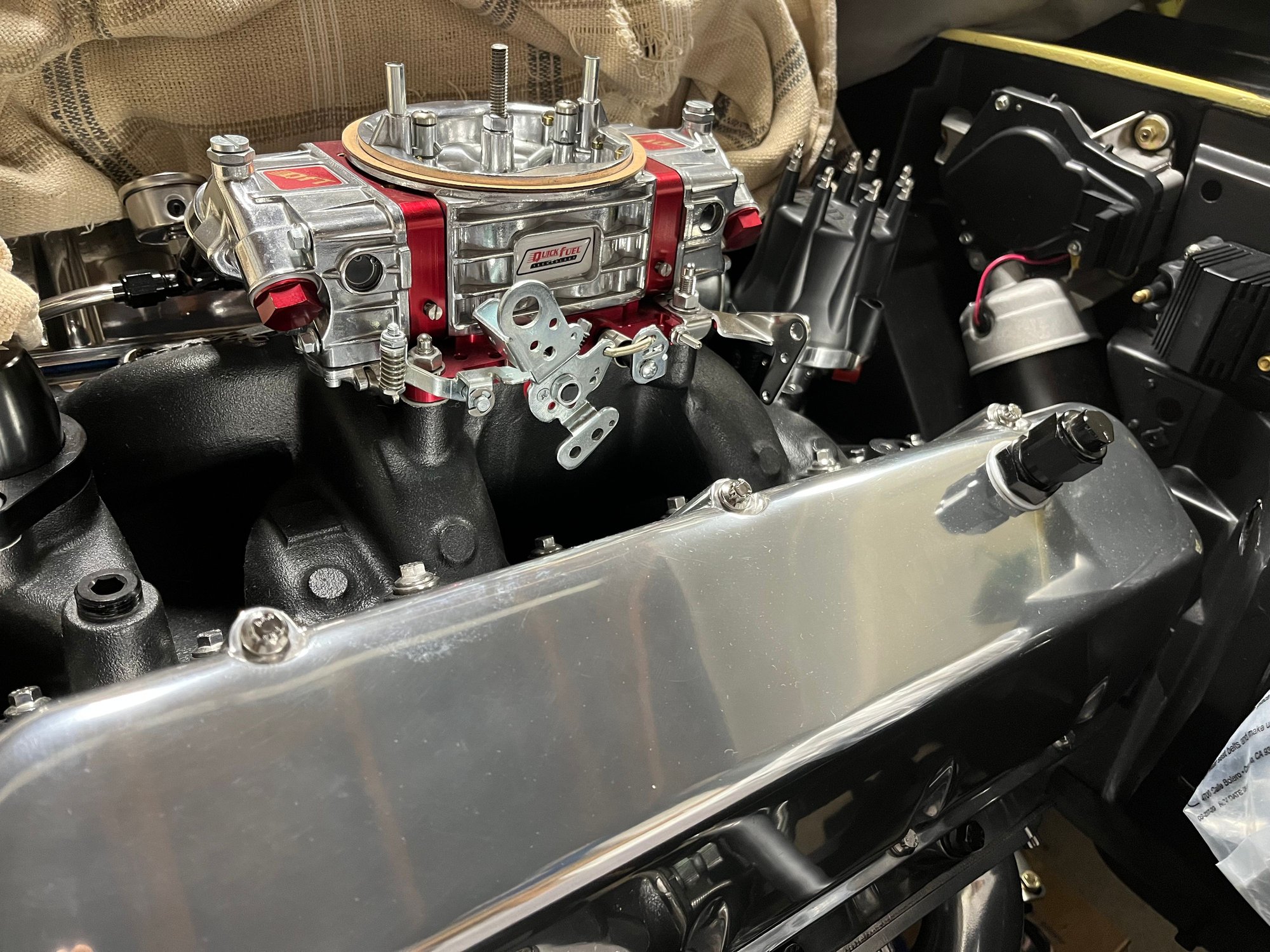

You might even send Lars some pictures of your QJet and see what he thinks.
It may need some of his expertise.

So Lars post really got me thinking about this. I am running a 4 inch tall filter with the L88 drop base. I am running the L88 air chamber as a cold air box. Popped my air cleaner lid off and sure enough I only have 2 inches of clearance with the 4 inch element. Seems as if even the stock L88 cars would have had an issue with this as well with their small 3 inch tall element.
