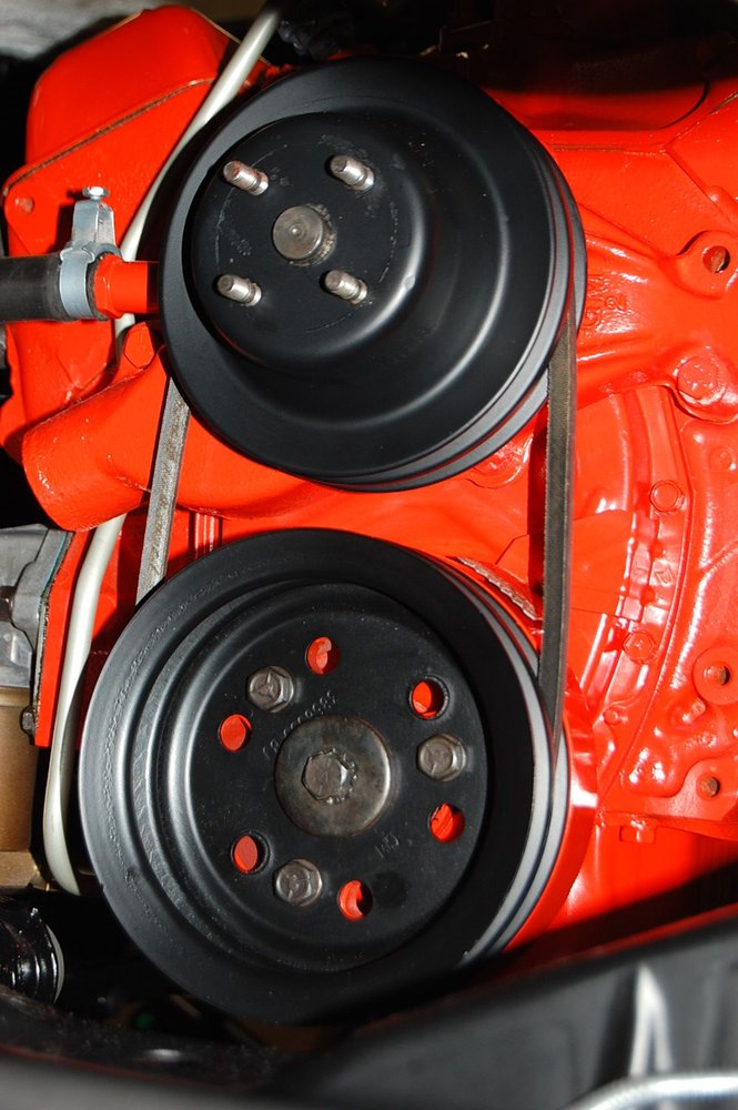

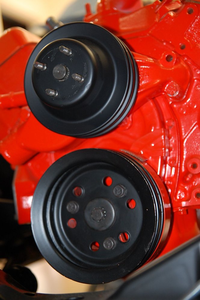

Hello,
Typically a sb with no options still had 2 belts.
A short one that ran between the water pump pulley and the crankshaft pulley. There was no tensioner.
The second longer belt ran on the alternator, water pump, and crankshaft pulleys.
The short belt could be installed by loosening the fan pulley enough so it could be tilted enough to be able slip the belt in place.
Regards.....

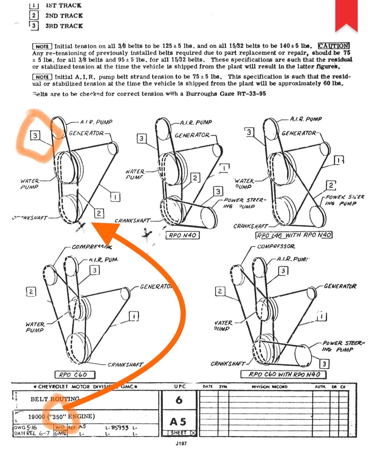

Yep,
Inboard track #1 (engine) is water pump & alternator
Outboard track #2 (fan/rad) is water pump
Marked up on my digital A.I.M. I’m running the same set-up: no A.I.R. pump (smog), no A/C, no P/S
I’ve got these two pulleys installed:
WP: 3848904
Crank: 3858533
Belts are:
Gates XL 7320 water-pump-crank and it seems loose. But a 7315 just won’t fit easily :-/
Gates XL 7530 crank-WP-alt that should be (?) a 7355
Gates site specs:
7355: 35.6”
7320: 32”
So technically my crank-WP-alt is ~3.5” too short.
Although it does allow for install & tensioning.
[EDIT: had the tracks wrong]
