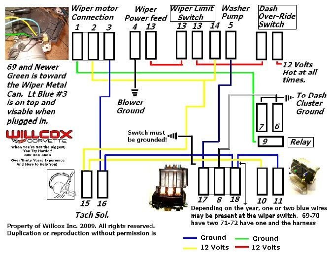

I have the Wilcox wiring diagram which answers most of my questions, but I have been unable to find out what wires 10 and 11 are?
Yellow is keyed power, so is that the ignition switch?
Thanks in advance.

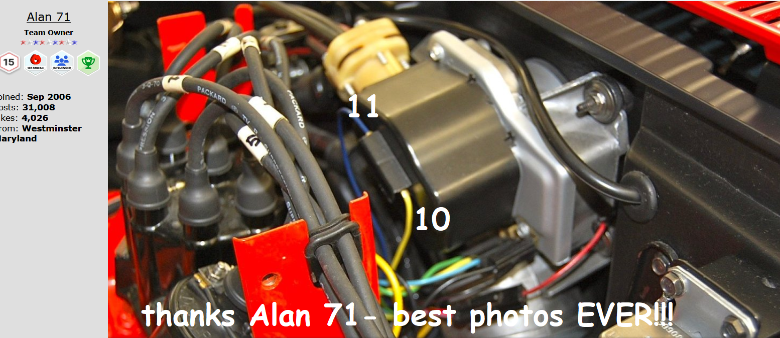

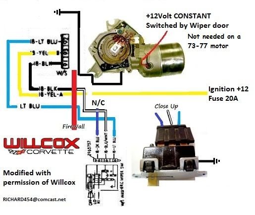

So looking at your profile/posts - looks like you have a 72 restomod- with no door
10 and 11 are for the headlamp washer extension jumper wires
I have helped several people out with this mod- not running a wiper door- You can use a 73 - 77 motor and clean up the wiring- see below

Wow, thank you so much! I don't see a relay? Back to the drawing board, will have to send back 72 motor
