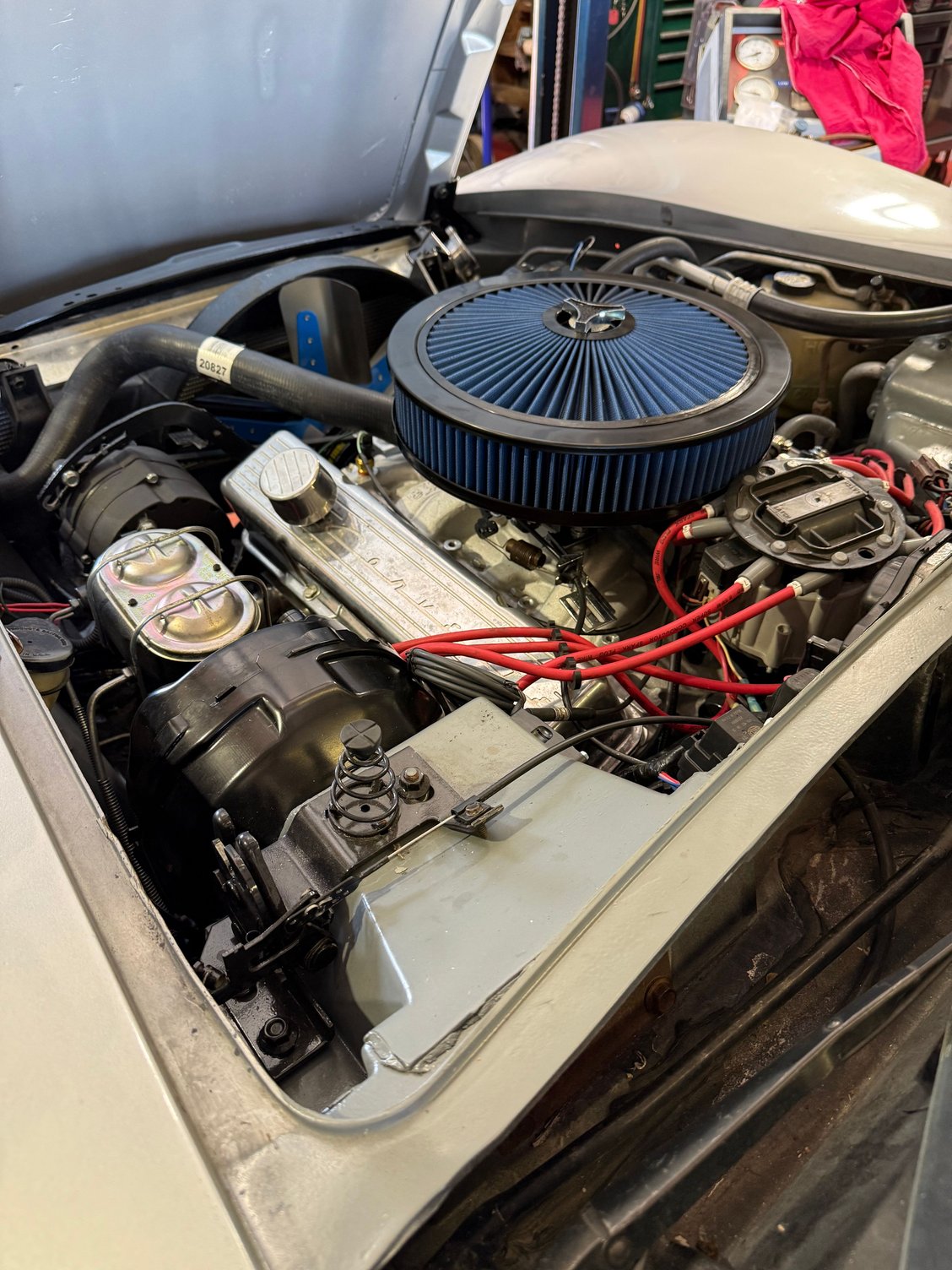

I recently updated my c3 engine and installed a new ac compressor. Now that its charged, when i slide the controller **** to ‘Max’ it turns the compressor off. When slide back to the off position, it turns on. I switched the wires around on the compressor unit but it made no change. Any help would be greatly appreciated.
