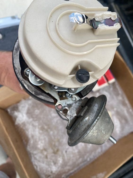

That looks like the rotor is pointing at the #1 position.
Now keep in mind that the rotor turns in a clockwise direction, mark the “1 post on the distributor cap and check your plug wires.

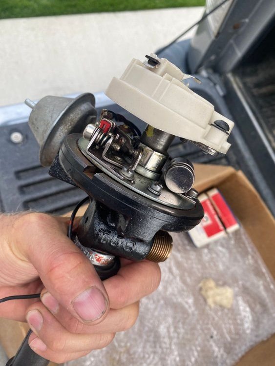

What's the deal with your distributor? GM never used screws and nuts to attach the distributor rotor.
Old Apr 19, 2026 | 12:06 PM
  #39
MelWff's Avatar
MelWff
Posts: 18,710
Likes: 2,574
If you closely there are no points, there is a shutter wheel under the rotor which uses a different set of attachment hardware.
Old Apr 19, 2026 | 12:17 PM
  #40
sunflower 1972's Avatar
sunflower 1972
Joined: Sep 2016
Posts: 2,215
Likes: 971
From: Wauconda IL
Perhaps his current distributor in contributing to his problems? I never liked the aftermarket "electronic conversions" for GM points distributors. And I'm aware some people swear by them.
