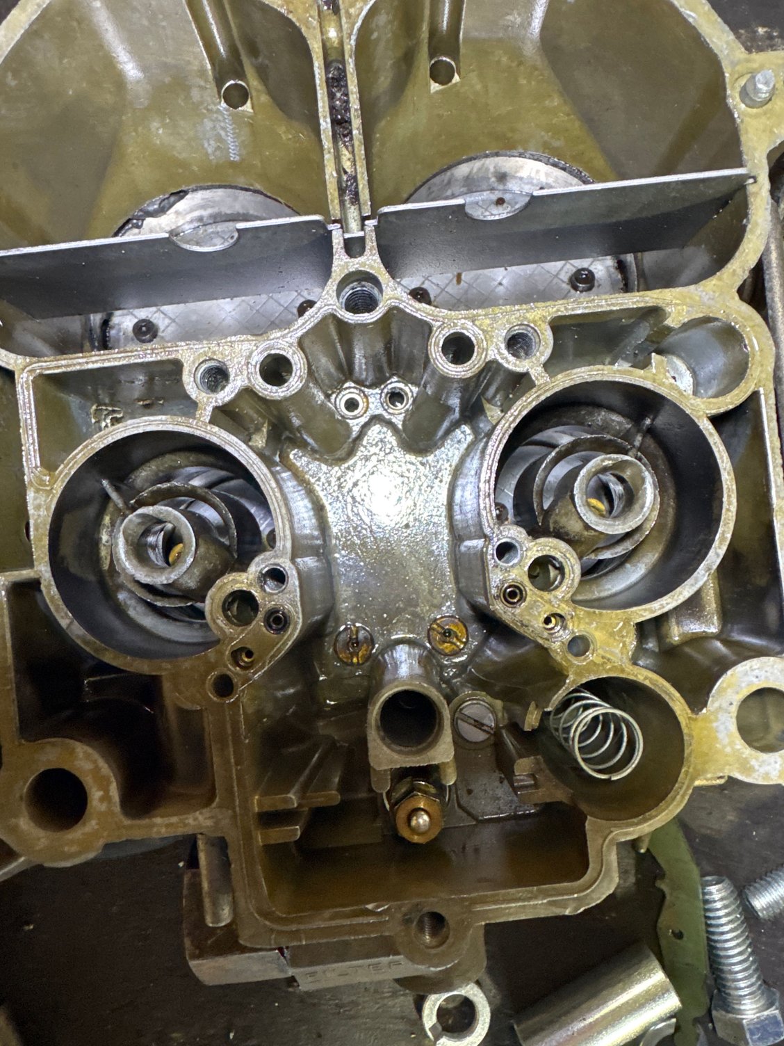

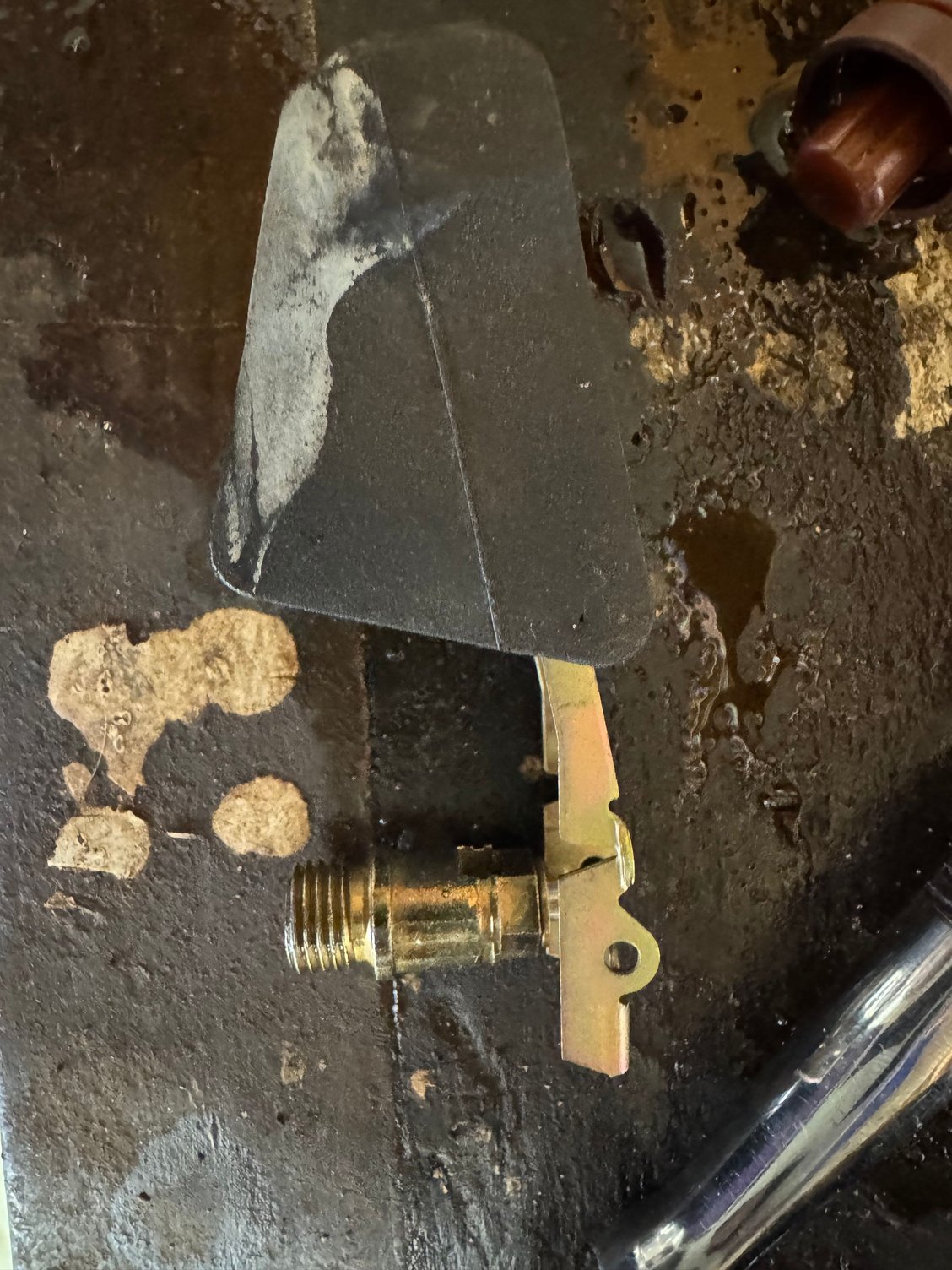

Finished replacing the intake gasket on my 74 big block. Got it all out back together with plans to finally start it today.
it started, but after maybe 20-30 seconds it stalled. the carb immediately filled with fuel and would even spit fuel out the top of the carb when stalling.
took the carb off and it was filled with fuel. the float looks fine. Float wasn’t filled with fuel and didn’t appear to be rubbing or stuck anywhere.
i didn’t have this issue pre taking the intake manifold off.
I am out of my comfort realm with this one.

Are you sure there was no dirt on needle/seat assembly?
Make sure the needle hanger is correctly connected to float.
Read post 11

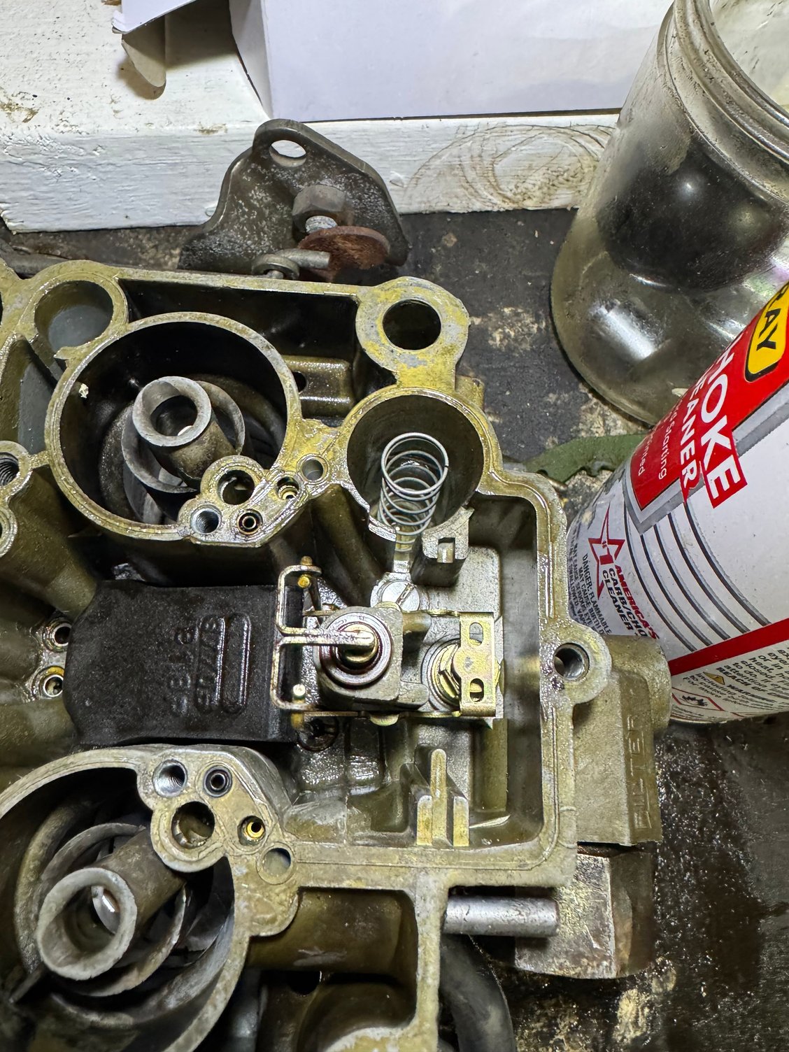

Huh, mine doesnt hang on anything.
could it be cemented since i haven’t tried to start it since October as mentioned?

Is your float not attached to the needed with a small hanger clip to raise it? Not sure they are all configured that way but every one I've rebuilt was
sorry my bad if I'm wrong, looks like yours may be different than I've seen?

Nope. Some background this hasn’t been on the road since the mid 90s. I was told that they rebuilt the carb right before I got it.
any chance they rebuilt it with the wrong rebuild kit?

What is holding the needle to the float, they should be two pieces.
Didn't notice any comment about October, there isn't any, so yes something could, dirt/deposit, could have caused this.
Nothing

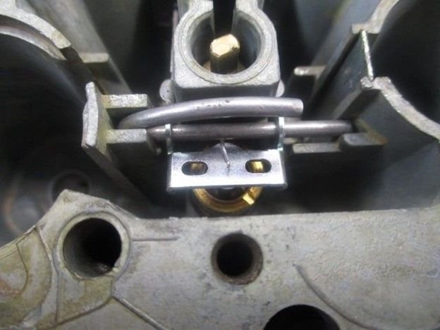

You have a completely junk, aftermarket needle/seat assembly. It may have been installed due to stripped out threads in the bowl. Inspect your threads and the gasket sealing surface. Then throw that crap needle/seat assembly into the trash can and install a correct needle/seat. I think JCWhitney sold those Chinese needle/seat assemblies in their $5 carb kits.
The inlet seat and needle should look like this, and the inlet hole in the seat should be .135" diameter:
Installed, it should look like this (your '74 has a longer float hinge pin than the one shown here):

Be aware that the carb you show in your photos has seen some severe hack-work, and will need a whole lot more than a "rebuild kit."
