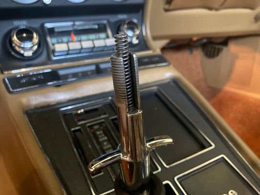

Since you had your shifter apart, take off the ball and see if the spring is on the top. If you put the spring in first it falls to the bottom and then you cannot get into reverse. Getting it out is a lot of fun. A long spring hook will usually work.
The picture is how it should be.
Yes that's how it is.

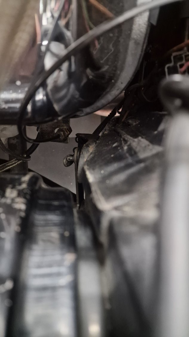

Old Apr 5, 2026 | 02:57 PM
Golfobsessed's Avatar
Golfobsessed
Joined: Aug 2016
Posts: 1,793
Likes: 937
From: Arizona
The issue can only be in a few areas... from furthest away.1. Reverse cable at steering column, if disconnecting it didnt fix the problem thats not it. 2. The reverse cable at the reverse shifter lever end... either stuck in casing or kinked. 3. Linkage... if you can take a box end 9/16" wrench and shift the levers into gears and neautral than its not linkage, cable or transmission which will leave 4... the shifter assembly. If under the car checking for lever and linkage movement leave the forward gear levers straight up and down and reverse lever all the way forward so you know your in neautral and then check shifter assembly...

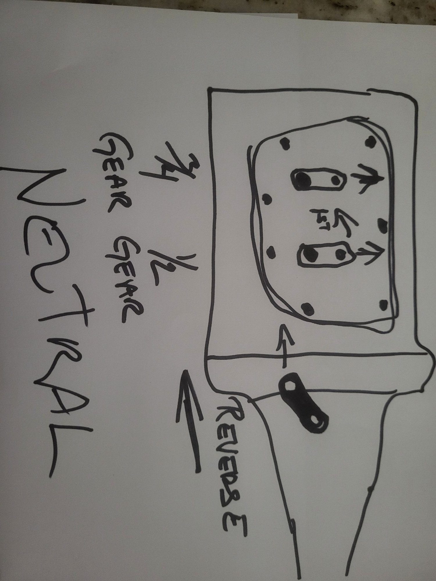

you will need to get the car up on jack stands... from the underside you can put a 9/16 wrench on each transmission shift lever and move the levers, if they all move freeley than your issue is likely in your shifter, with the inside of the car shifter in neautral leave the forward gear levers straight up and down and the reverse lever all the way forward on the transmission... this is neautral in the transmission, if your just stuck in multiple gears this should fix the problem otherwise its likely in the shifter assembly and your not getting into the reverse gate.
I would first make sure I didnt drop something from the top side into the shifter levers preventing the shifter from moving into reverse.
As you get under the car you will see if your in multiple gears just by looking at the levers
Old Apr 5, 2026 | 03:08 PM
Golfobsessed
Joined: Aug 2016
Posts: 1,793
Likes: 937
From: Arizona
A little primitive
the 1/2 and 3/4 levers straight up and reverse forward

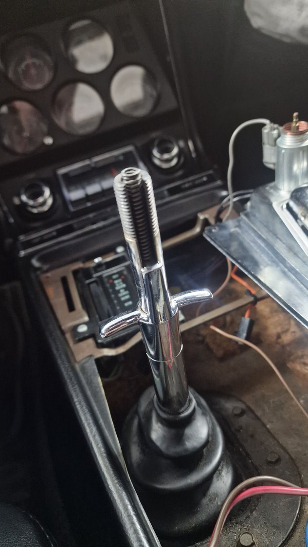

chrisdotmt's Avatar
chrisdotmt
Joined: Sep 2025
Posts: 116
Likes: 10

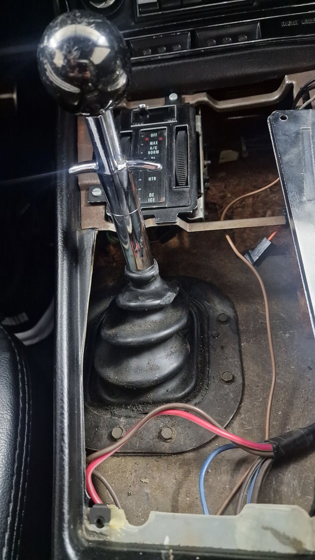

Before getting under the car, would it help if I remove the lower shifter boot (see photo)? Would I be able to do some troubleshooting from there?
Old Apr 5, 2026 | 03:16 PM
Golfobsessed
Joined: Aug 2016
Posts: 1,793
Likes: 937
From: Arizona
yes I would do that first to see what's going on as best as you can and also see if you didnt drop something in between the shifter levers

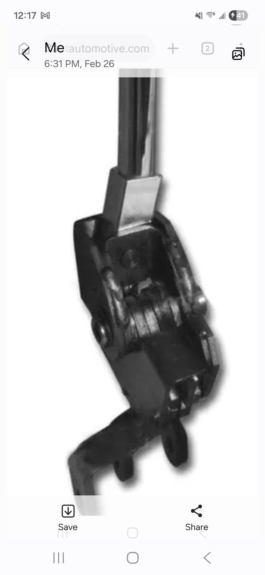

Old Apr 5, 2026 | 03:19 PM
Golfobsessed
Joined: Aug 2016
Posts: 1,793
Likes: 937
From: Arizona
These are the shifter levers in the shifter along with the reverse lockout plate between the 1/2 3/4 levers and the reverse levers

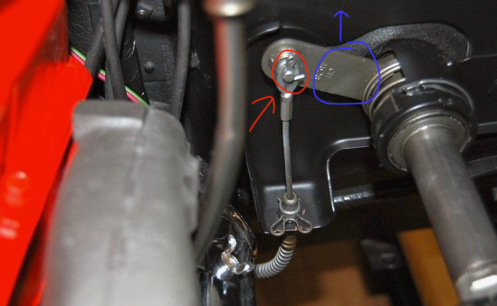

chrisdotmt's Avatar
chrisdotmt
Joined: Sep 2025
Posts: 116
Likes: 10
Problem solved !!
I had indeed disconnected the reverse lock cable (red circle below), but I had not raised the metal lever (blue circle below). I just assumed that only disconnecting the reverse lock cable would have done the trick. I had to manually pull the metal level (blue circle) up with my fingers. Then I heard a click of sorts. Turned on the engine. Put it in first gear, then in reverse, and the reverse got engaged normally.
What can I say guys?? Thank you very very much !!! If @sunflower 1972 and/or @Golfobsessed are ever in Brussels, drinks are on me
Thanks again!

Old Apr 5, 2026 | 04:19 PM
  #37
sunflower 1972's Avatar
sunflower 1972
Joined: Sep 2016
Posts: 2,230
Likes: 984
From: Wauconda IL
YAY! That's great! Good for you! Always a great feeling when you fix something!
