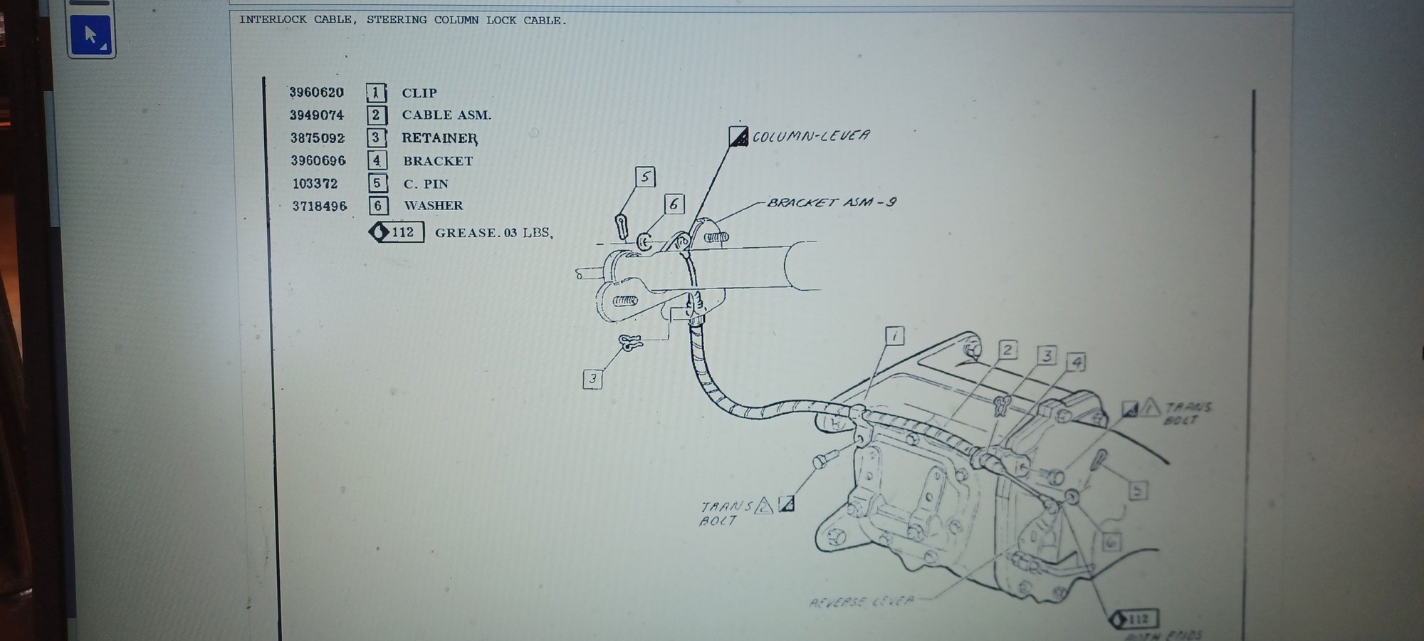

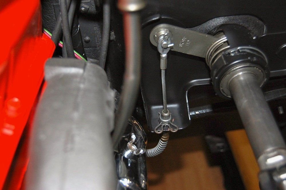

There's a cable (park lock cable) that runs from the shift lever to a lever on the steering column. Just disconnect it at the steering column and you'll be able to engage reverse. It's an anti theft device that locks the steering.

Be sure the shifter is put together correct, try removing spring and rod to see if you can get into reverse, if the key is coming out that means the reverse lever cable is moving forward and activating the lever at the base of the steering column

Old Apr 5, 2026 | 01:20 PM
just to be clear, this cable (steering side), is it accessible if I disassemble the steering column INSIDE the car (i.e. in front of the dashboard)?
Old Apr 5, 2026 | 01:23 PM
sunflower 1972's Avatar
sunflower 1972
Joined: Sep 2016
Posts: 2,230
Likes: 984
From: Wauconda IL
It's accessible from underneath the hood.

Just disconnect the cable underneath the hood. See what happens. What have you got to lose. That's a lot easier than crawling around underneath the car.
