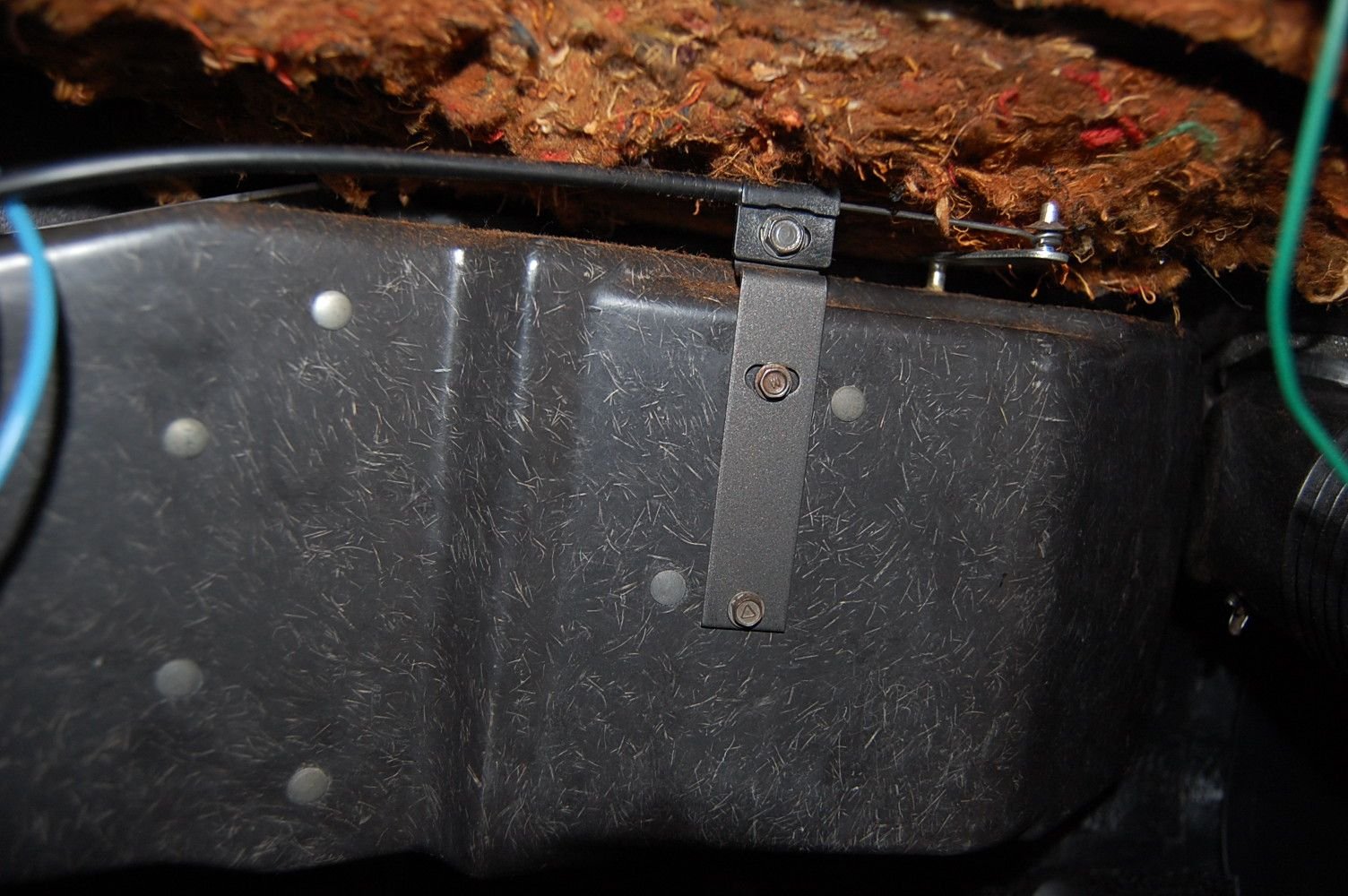

Hello,
Here are some photos showing the Bowden cables 'snaking' behind the dash panes.
Perhaps they might be some help to you.
Look for the distinctive 'alligator skin' on the cables.
Regards....
