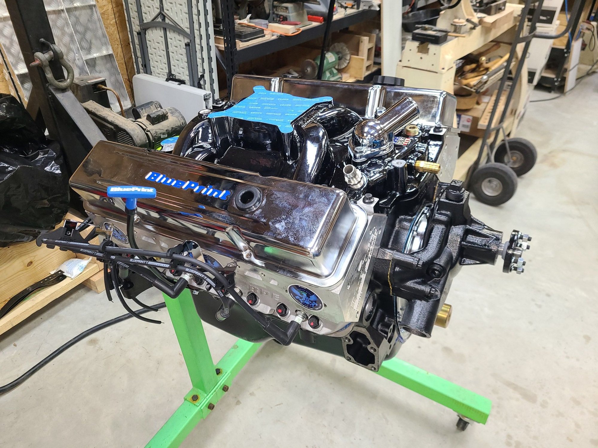

This thread is very timely for me. I’m getting ready to buy a BP 350/341 long block to install in my 72 C3. I had planned to install the BP 350/390 but was concerned by the vacuum and idle rpms. I plan on using most of the accessories from my old engine including the Quadrajet carb, Edelbrock Performer intake manifold. Does anyone know if the old style intake manifold will bolt to the BP heads? The BP literature says it has both bolt patterns. I will give BP a call. Thanks for everyone’s expertise.
As @Fly skids up! pointed out the old manifold may not fit, I would get a new vortec manifold and I did get a new vortec manifold for my BP350CT
I think I'll cover up the BluePrint with a sign that says FingerPrint!
