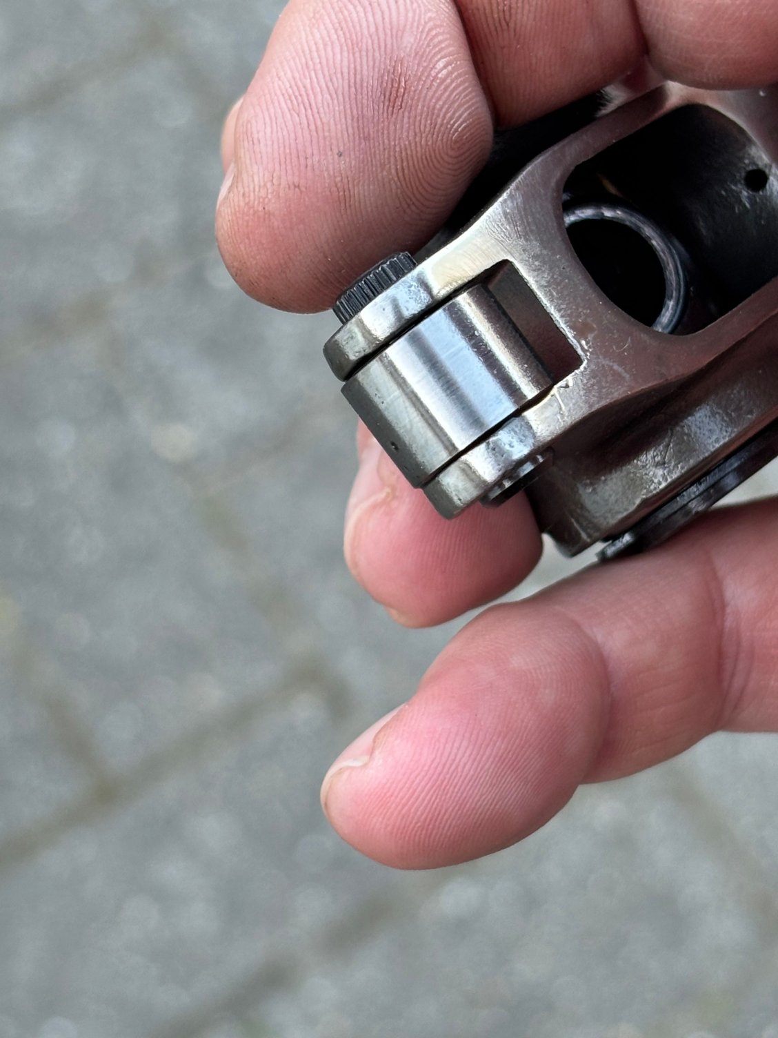

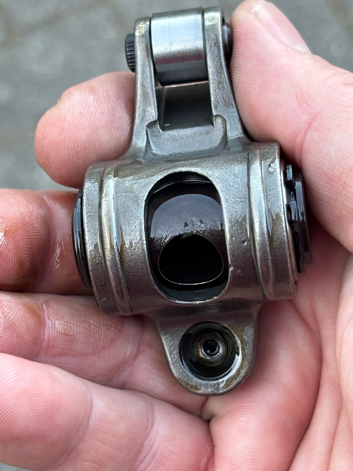

Originally Posted by DorianC3
Yes. These heads came with the 400. I know next to nothing about them. I am not even sure they are producing them anymore.
The rockers are 1.55:1. And don’t seem to interfere anywhere.
Agreed on everything you said about these springs.
These RAs are not recognizable to me either
That bottom pic with rocker arm OFF--- clearly shows valve TIP.
There's a cross X or star-like pattern on TIP: that pattern CAN, repeat CAN be result of valve float.
On the rocker arm's Roller-tip to Left of Star --- there's an ugly wear pattern developing on that roller.

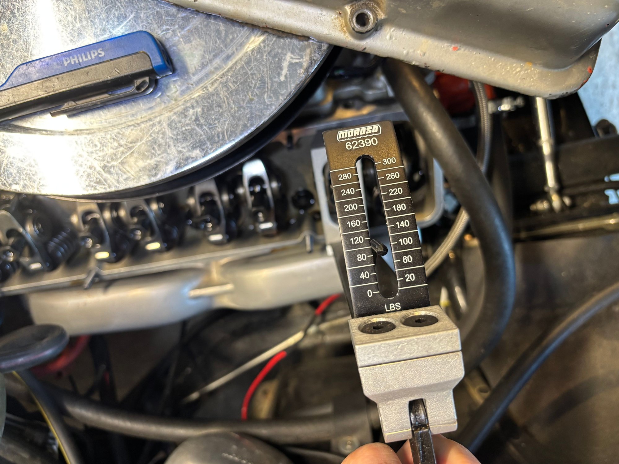

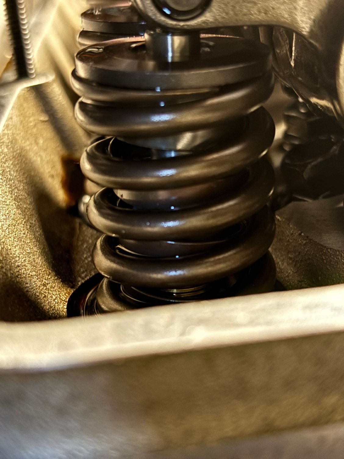

So, I finally came home a bit early…
#90
#90 at the seat
Rocker wear seems minimal
I don’t see anything terribly concerning here either.

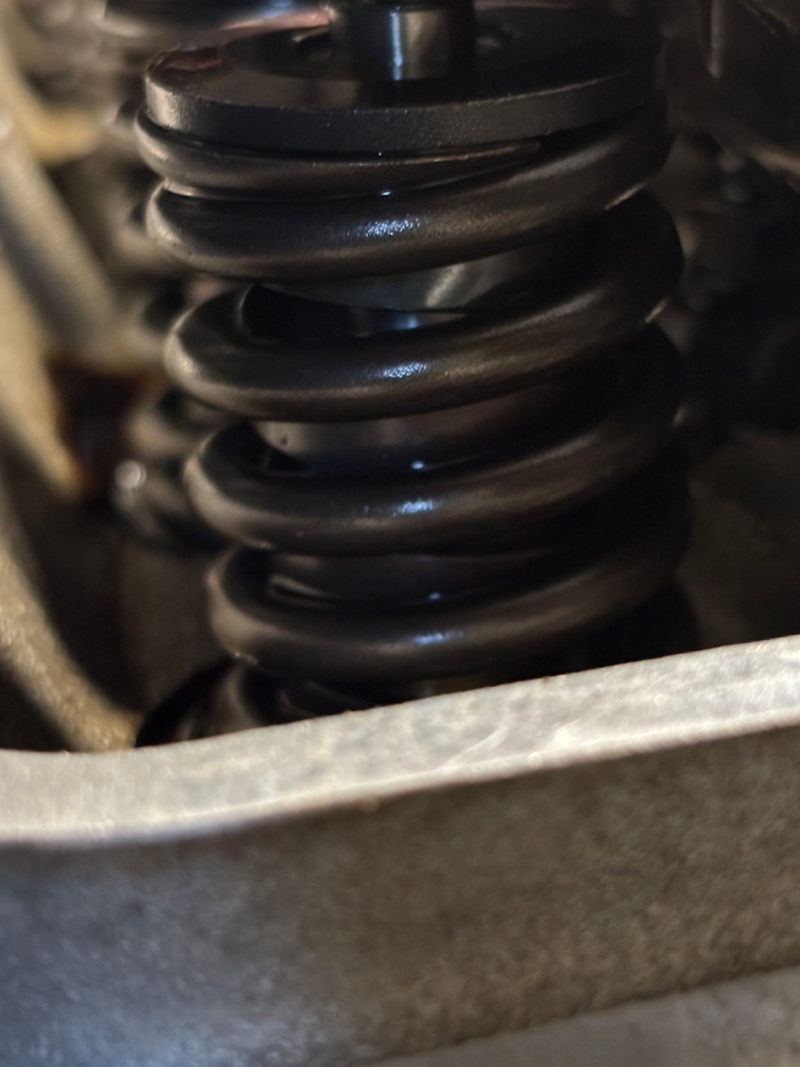

Dual springs.
Dual springs.
And in other news.
And in other news.

I cannot tell from photo-lighting
is One of the springs (inside) made of a flat steel ?
OR, are Both springs made of a Round wire ?
100 psi relative to what ? Closed, partially open, fully-open ? at what valve height ?
Old Apr 22, 2026 | 03:04 PM
  #35
DorianC3's Avatar
DorianC3
Joined: Nov 2017
Posts: 2,358
Likes: 519
Outside spring is round. Inside is flat.
90 lbs at the seat. Maybe even a tick less.
This weekend I will measure the installed height
For *****’n’giggles I eyeballed full lift and it seemed to be less than 200 but more than 150

Well those pressures are the opposite of what I was expecting, but still a problem.
I am so glad you purchased a spring checker.
Those are basically stock springs. 90/180#
Here are Chevy's specs:
And since you have heavier non-factory roller lifters, and a cam with a much quicker ramp speed, I would go with Comp's suggestions, which are significantly stronger.
Like 30-40%. Nearer to 134/280#
Too light of a valve spring can cause valve bounce on closing, and it is possible that is the source of you idle concerns.
Light springs can also cause valve float at higher rpms, maybe not even so high in this case.
That means check the valve tips and the rollers on the rockers very carefully.
How many miles did you put on it like this?
Yes - those must be stock springs. What I don't understand is why the previous owner had such a hairy cam in it with essentially stock springs.

Hm 986 springs are discontinued.
Need to find alternative with correct specs.

They also recommended a beehive spring. Much more modern and better valve control.
986 are basically decades old Z28 off road springs from the 70s.
Try #26986 beehives instead.
Or even better just use PAC springs
