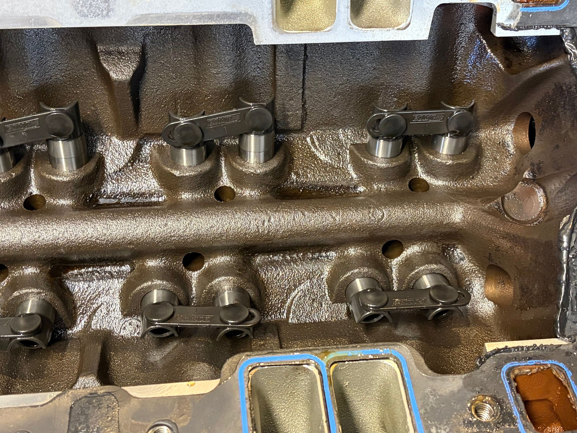

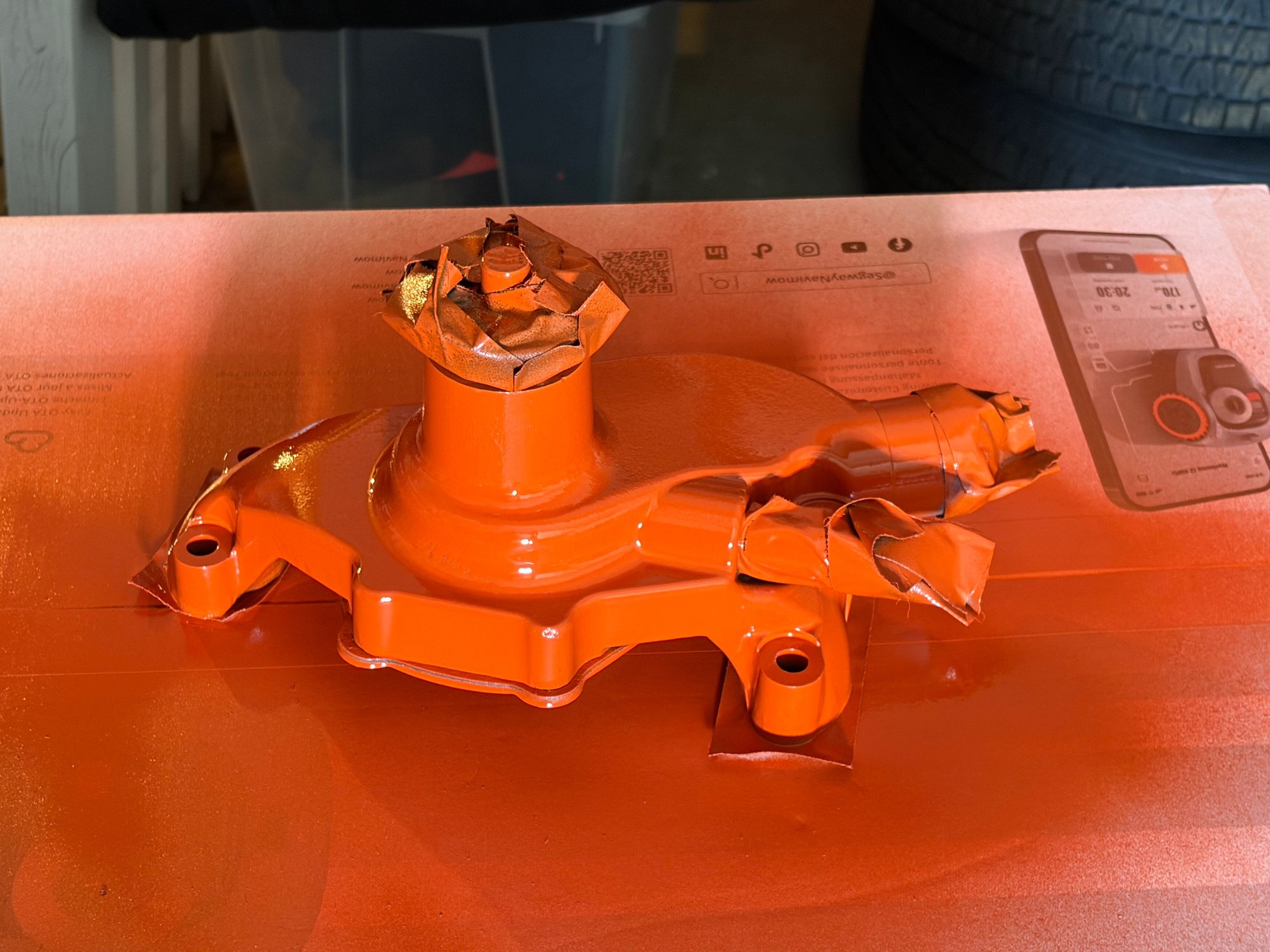

DorianC3's Avatar
DorianC3
Joined: Nov 2017
Posts: 2,358
Likes: 519

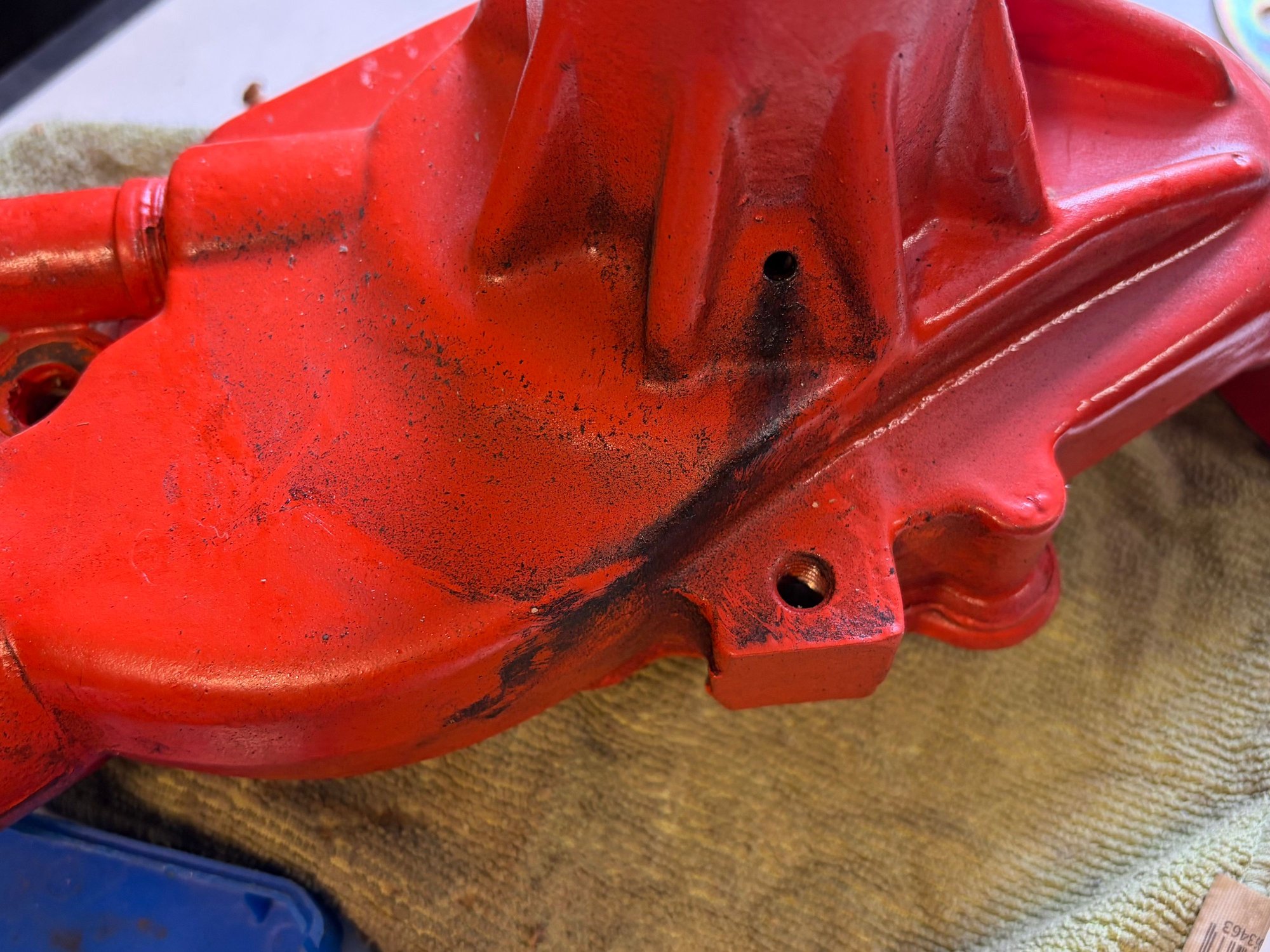

New aluminum pump.  I could hear bearing grinding at idle.
Some engine enamel.  Chevy Orange, of course.

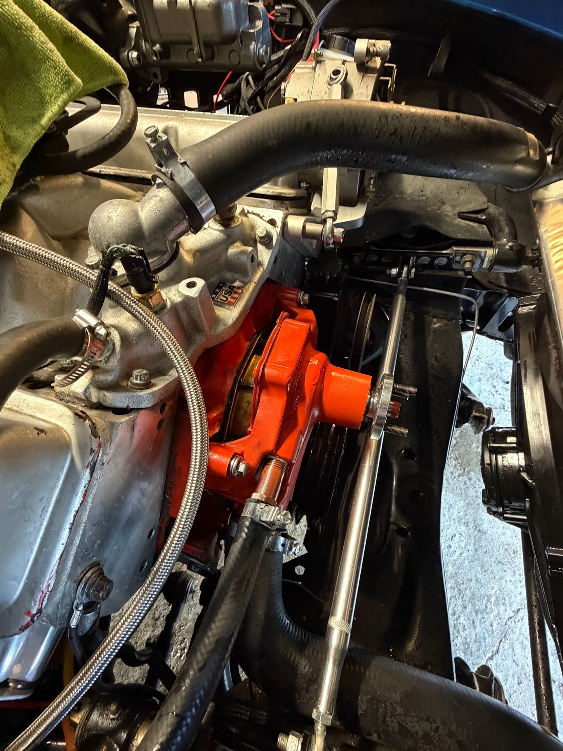

Interesting- weep hole on underside reveals a leak.
New pump installed
New pump installed
With a bit of luck, a test run tomorrow or the day after.

soon as is possible, suggest remove all paint that may be on that lower rad hose spigot.
Paint will cause the hose to bond to pump; later (when you need to remove hose), that may give you grief.

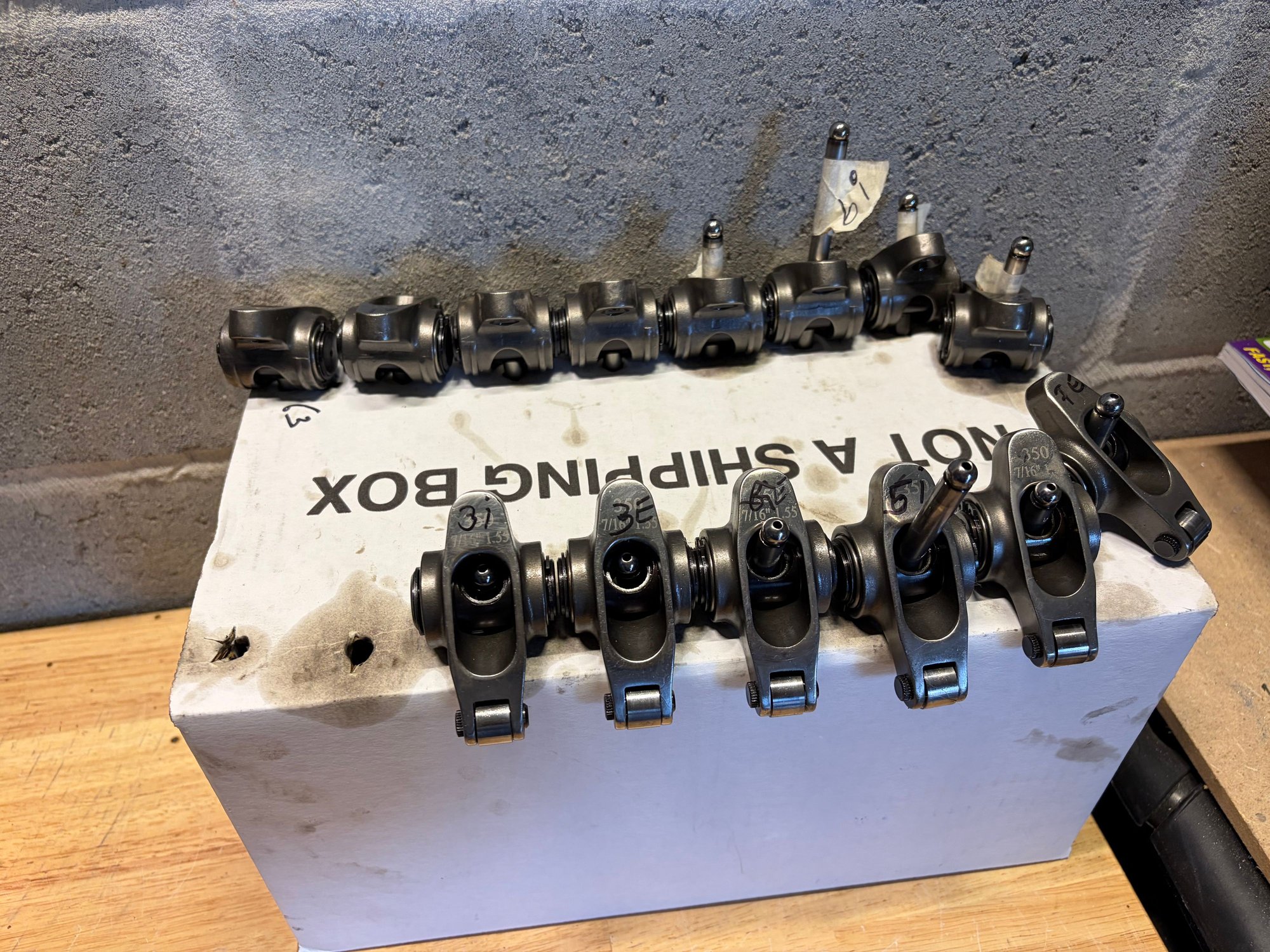

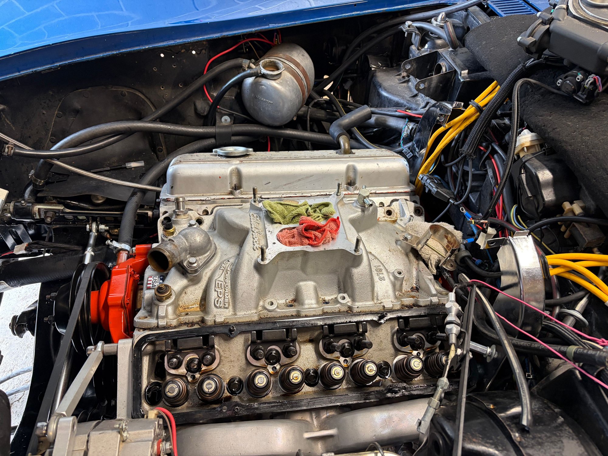

We all know the drill
We all know the drill.
Maybe will make things easier.   I hope it sticks.
Here we go again.
Here we go again.

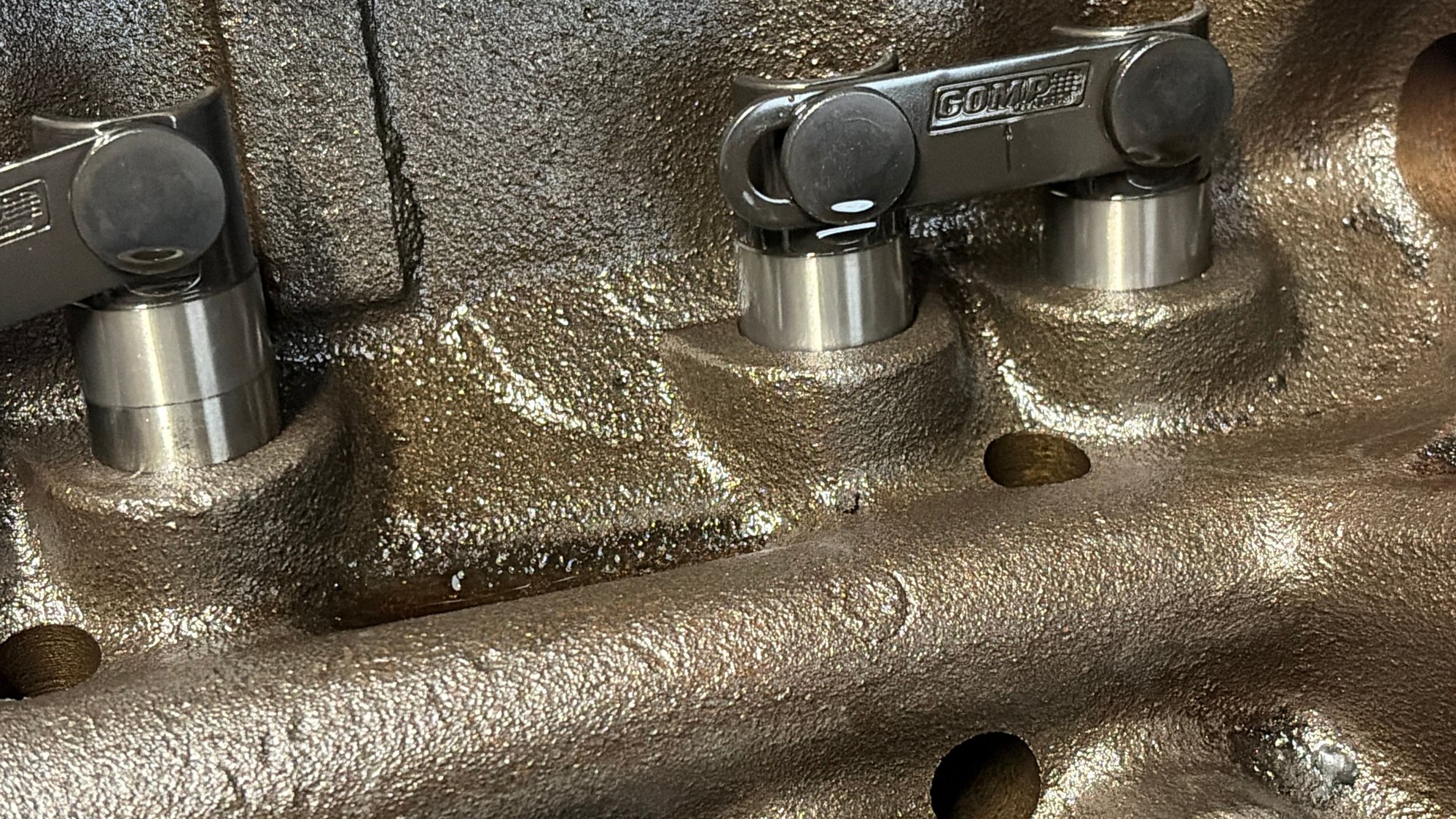

Nothing unusual that i see.
Nothing unusual that i see. Dirt is an optical effect. It’s clean.
Looks fine.   I checked the cam with a bore scope.  Looks fine.
These look fine as well.
The only issue: several of the lifter plungers are stuck.
I am going to try to carefully unstick them.

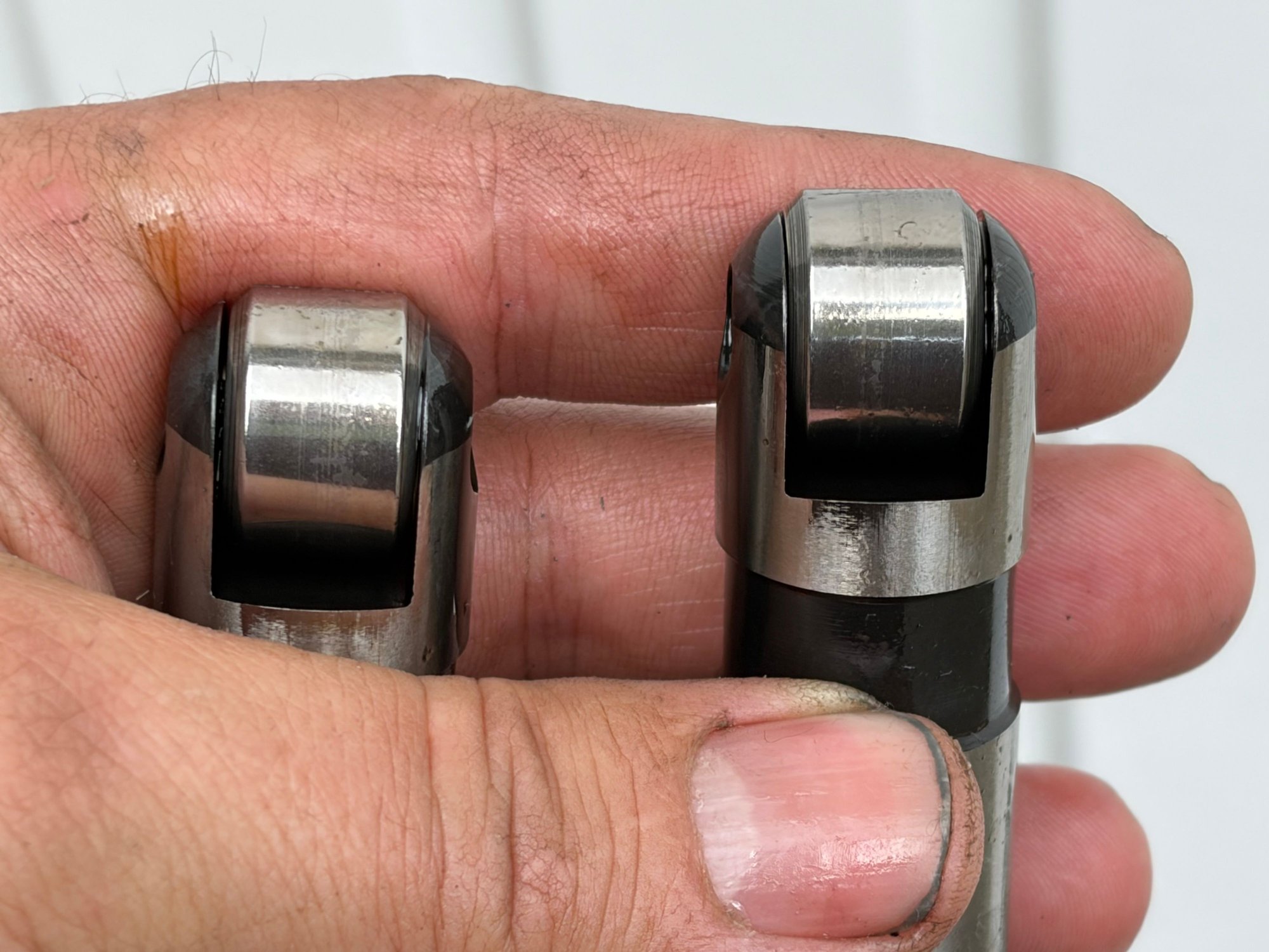

I am not confident that the lifters will become “unstuck”. Several hours later, one pair is still stuck.
i have been reading up on my “high energy” Comp Cams lifters. Not unusual to fail out of box. (‘had these issues since day one.)
interestingly these lifters are no longer available. The next generation are called “Evolution”. Go figure !!!
Sigh. Expensive !!!

When hydraulic lifters are stuck internally, you must completely disassemble them and clean all bits with aerosol carburetor cleaner & compressed air. Reassemble internals with just enough AT fluid to coat surfaces (don't attempt to "fill" them). Do NOT mix any internal parts between lifters. Maintain each lifter and its parts as one discrete unit.
Top quality, New replacement retrofit link-bar roller lifter brands:
Gaterman, Iskenderian, Morel
yup, good quality valvetrain pieces are expensive
*I see evidence of scuffing on lifter bodies.
suggest you closely inspect & measure lifter bodies' external ODs and block's lifter bores' IDs
lifter bores can and do wear out.

Originally Posted by Rebelyell
When hydraulic lifters are stuck internally, you must completely disassemble them and clean all bits with aerosol carburetor cleaner & co…
Sadly, these are not rebuildable. Interestingly, the next generation is.
yes. I noticed the scuffing as well.
I have a set of used comp retro roller lifters like this with very low miles and the sides are very scuffed compared to the enginetech version I pulled from my 355.. Not really sure why but that and the fact that Id need to change my pushrods led me to reuse my enginetech lifters instead. I plan on using the comp lifters along with this cam in my 355 once I find a project roller for it and the th400 I yanked fro the c3.
That evolution thing is essentially an insert from an OE GM hyd lifter.
Newer Harley D are likewise.
Suggest purchase new Gaterman or Isky or Morel (not Comp). told ya.
I don't have Your lifters in front of me. And whether they can be rebuilt (or not) is not a certainty, either way.
But, I do feel confident advising you, that (unless the lifter is severely damaged/broken) the hydraulic part can be disassembled, cleaned, then reassembled; in much the same manner as a typical hydraulic flat tappet lifter.
As for the roller parts, it would likely require a dedicated jig/fixture to disassemble/reassemble and dunno if comp offers replacement parts for those specific lifters. Their bodies may be so damaged-scuffed to be not suitable for reuse; I have not inspected/measured.
OR try some of the Asian retrofit link-bar hyd roller lifters like augiedoggy got from RockAuto; Enginetech P/N RFC35016. A full set of Eight pairs are about $212 today.
Regardless whose New lifters you settle upon; strongly suggest you disassemble, clean, reassemble as before.
And, suggest you pull cam from motor and place on a clean bench with bright light and magnification. Closely inspect for any damage to all lobes.

Yes, I suspect with a lot of patience and the right tools, these could be rebuilt in my garage. I can see the snap ring, but goodness the pry gap is ridiculously tiny. And with these plungers not budging, I have a little confidence that I can service all of these lifters.
Over 12 hours in paint thinner had no effect.
I do remember when I first installed these lifters and the roller cam, it was difficult to set confidently the lifter preload. Was this related to having the wrong springs on there? Who knows.
While I’m at it, I will pick up some valve spring seat locators and hopefully these are standard valve stem oil seals.

You probably need 1mm snap ring pliers and you need to roll the roller on a hard flat surface, they should roll smooth. If they don't you have brinelling which means the needle bearings inside are deformed or flattened and should be replaced.

I must say, this has been an interesting journey.
My frustrations with this engine have been with me since almost day one. It seemed plagued with performance issues.
I am convinced we are finally on to something. I do think the lifters failed out of the box… I don’t think the weak springs caused this - sure as hell did not help. The problem with new parts failing is you tend to question what you are experiencing and look for the suspected issue elsewhere.
These lifters, now no longer on the market, had a mixed track record on reliability and QC. That said, I’m only speculating on their share of responsibility.
I am not there yet, but I think we are on the right track to finally solving this one.
Further, I want to thank everyone who contributed to this thread.
Stay tuned. I expect to order parts still this week.
I am sure curious to see how performance will be affected.
Incidentally - the rollers on all were operating super smoothly. No complaints there
