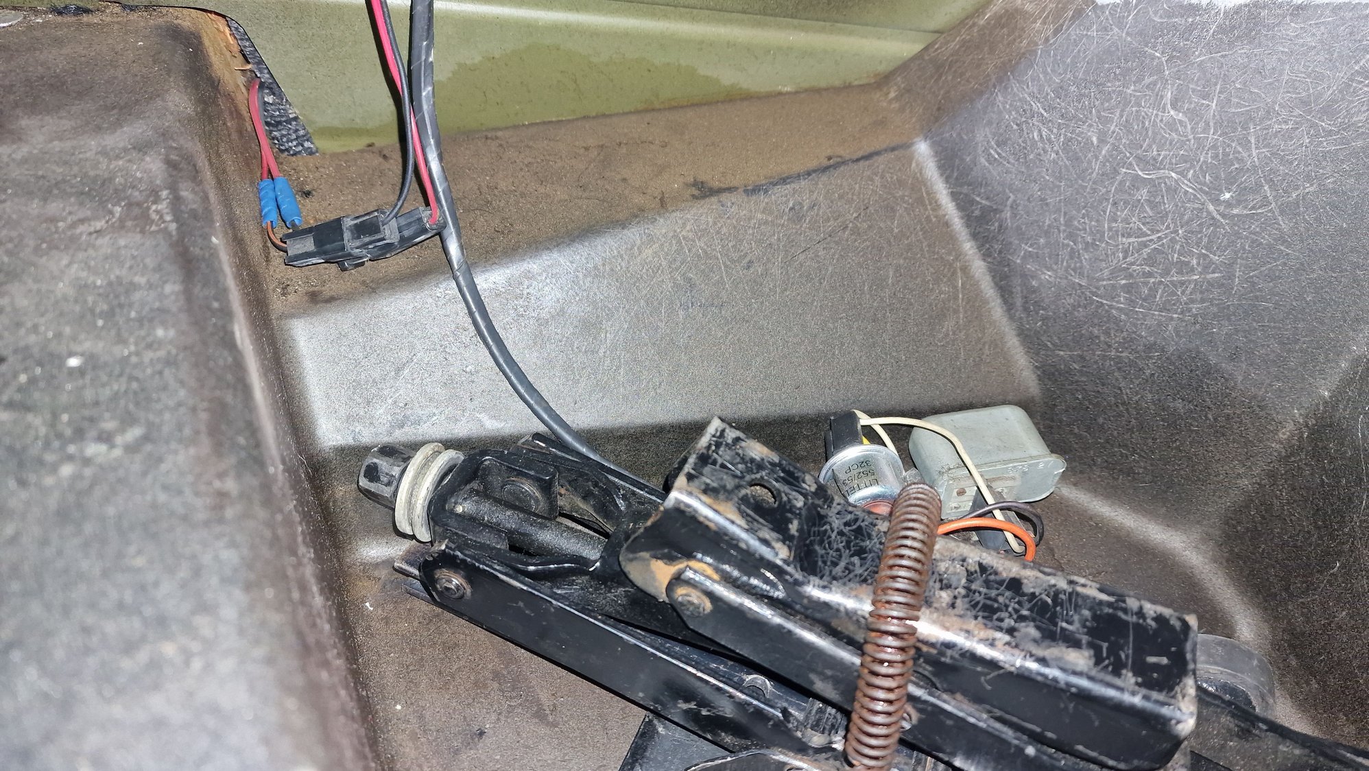

I dont have a light inside my middle rear compartment even though the compartment has a place for the light to go in.
I also dont see any wiring in place that can host a light bulb. Is it possible that the car came out without one?

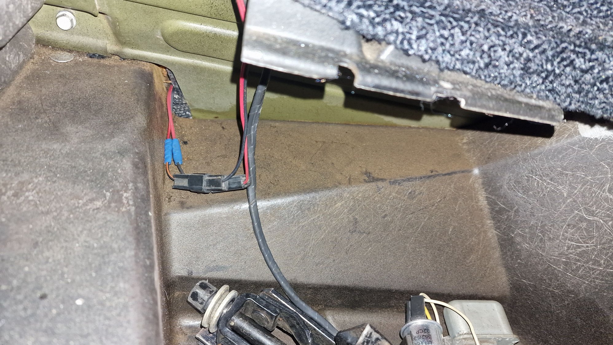

Thanks Alan! Indeed I do have the insert. But if I buy the light and switch, to what will I connect them to? To my non-expert eye, there doesn't seem to be the wiring in place. What am I missing?

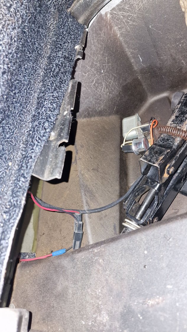

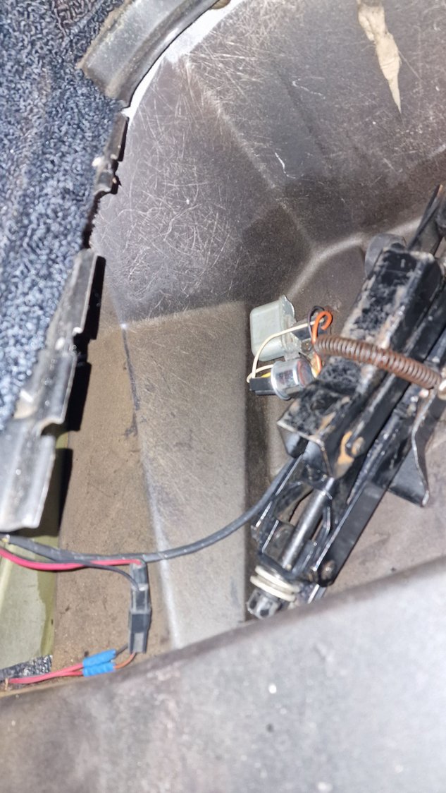

All your photos seem to show the passenger side outer compartment, not the center compartment area. On my 71, I believe the center light clips to the fiberboard removable tray and there is a plastic connector junction that the wiring plugs into. Mine does not have the round flasher? or rectangular relay? that you show next to the jack. Also, those 2 blue butt connectors shown imply to me that some wiring mods or repairs have been done. Could those leads have been the original leads to the center light that were repurposed for something else?

The wiring should be in the jack compartment. It appears there are a number of non-factory connectors in your pictures.

I did not show under the center compartment area because there is nothing to show there. But I like your idea about the leads having been repurposed. I will investigate further this.

That's what i thought. Thanks for confirming. Any idea what those contraptions next to the jack might be doing?

I found a 69 wiring diagram that shows the light/switch assembly should have a connector that has a black 20 ga wire and a black & orange 20 ga wire. That connector mates to another connector that has red 20ga and black 20 ga wires.

My light/switch assembly is completely missing, so I will never find that. But I do have a red wire and a black wire. For some reason, they are connected to something else. I will investigate more where those 2 red wires with blue butt connectors are going.

Yes, factory alarm relay and flasher. You should have the switch to arm the system dead center rear of car.

another mystery solved. I will test it out in the coming days.
i do have a separate 'door ajar keeps blinking' after doors closed. I suppose this would confuse the alarm, right?

Yes, switch needs adjustment
