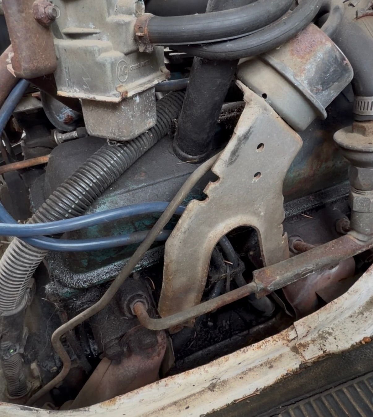

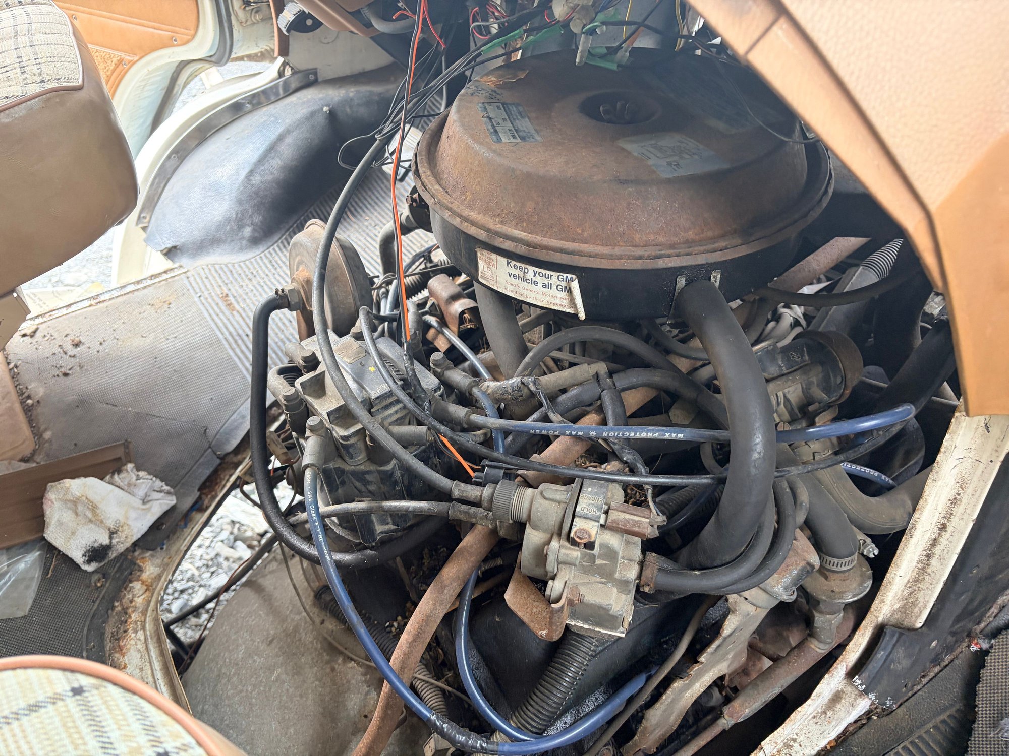

Hi, I have been seeking out used engine options for my 1980 C3. I found a 38,000 mile 400 ci engine. It was new in a 1980 Chevy chassis motorhome. I inspected it, it checked out good.
This 400 engine has quite a bit of smog crap on it. I see air pipes going to each exhaust port. I assume it has an air pump as well. I was hoping I could strip-off all this smog stuff. I haven’t acquired the engine yet, I just went to look at and inspect it. Can anyone confirm if the air pipes are connected to the exhaust manifold at each cylinder? Or are they connected right to the exhaust ports in the heads? In the photo below its looking like the air lines might connect to the heads? Perhaps I can plug these air ports at the heads, when removing the lines?
I am hoping to run the stock heads (with smog crap removed) for year or two. Maybe just replace the intake manifold and install the quadra-jet carb that was on my 1980 when I bought it. Add headers, dual exhaust and get out cruising for this summer.
Here is a photo of the stock 400 engine as it sits, currently in the RV. Thx.

They're great motors BUT I don't need or want another one or this one.
But what is your your purchase price for this ? That will help me guide you ?
AND, what are last Three numbers in block casting Number ? ... should be easy to find along rear ledge either side of dist.
YOUR 1980 vette ex manifolds should easily bolt right up to those OE 400 heads
-add-
I've seen and owned a fair few sbc 400. Never seen one that the air emission pipes screwed into Heads ... Only screwed into ex manifolds. Just swap your 350 ex manifolds onto the 400 heads.
How much it gonna cost ya ?

Those manifolds look pretty thick, but the AIR tubes do go into them.
You are going to replace the heads eventually, right? It should be plenty torquey in the meantime.

Well lucky for you to snag a 400 for that price.....They all looked like that when they were new...pipes, hoses, sensors, vacuum lines, all kinds of crap. The nice thing is you can strip all that stuff off, and have a nice running small block with low miles. You may be fortunate enough to even get the 800CFM Quadrajet with that... If you don't want it, I'd like first dibbs on it
I have a 400 and a 5 speed as well, and love the way it changed the car from a 350 with a 4-speed. The 5 speed is the best change you'll ever make to your car.

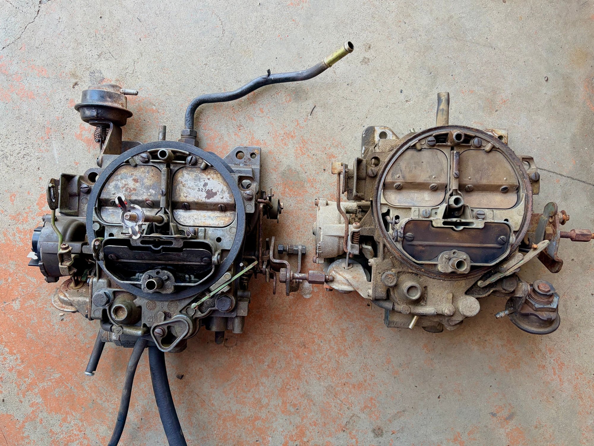

Left pulled from failed 350 engine. Right pulled from 400 engine. How can I properly id what CFM each carb is rated for?
Old Apr 19, 2026 | 01:23 PM
Bikespace's Avatar
Bikespace
Joined: Mar 2017
Posts: 11,953
Likes: 4,510
The part numbers are on the side somewhere. It'll be obvious when you see them. Post those.
