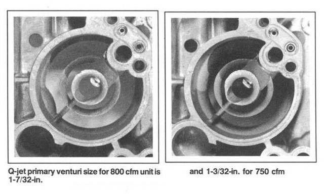

In this case Google AI seems to have good answers, since they refer to a very respected source "Cliff's High Performance""
Cliff literally wrote the best book on QJets.
Just Google: "I.D. a 800cfm Quadrajet"

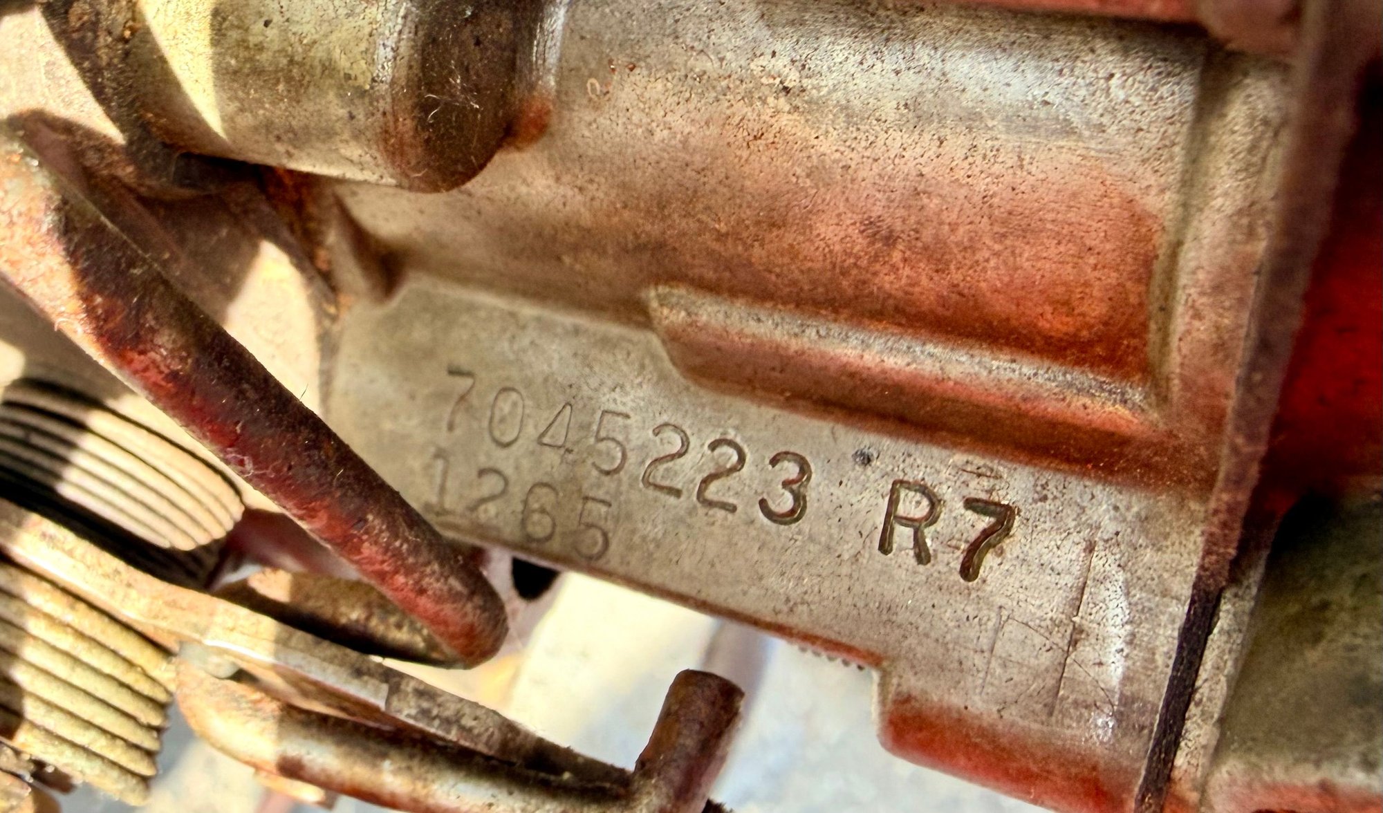

The two part numbers from each are here:

Old Apr 19, 2026 | 03:58 PM
Piersonpie's Avatar
Piersonpie
Joined: Apr 2021
Posts: 2,720
Likes: 2,165
From: Minnesota
Just the good old human noggin for this one. Note the little hump at 8 o’clock on the 800 CFM unit.
7045223 is from a 1975 Corvette, manual transmission (doesn't say displacement)
17059229 is from a 1979 Chevy truck, 400 ci, automatic transmission
These are from the Q-Jet white papers that @lars keeps up to date. You should email him for the latest copies if you intend to rebuild one of these carbs. Ask for his timing and HEI papers as well. Good luck!
