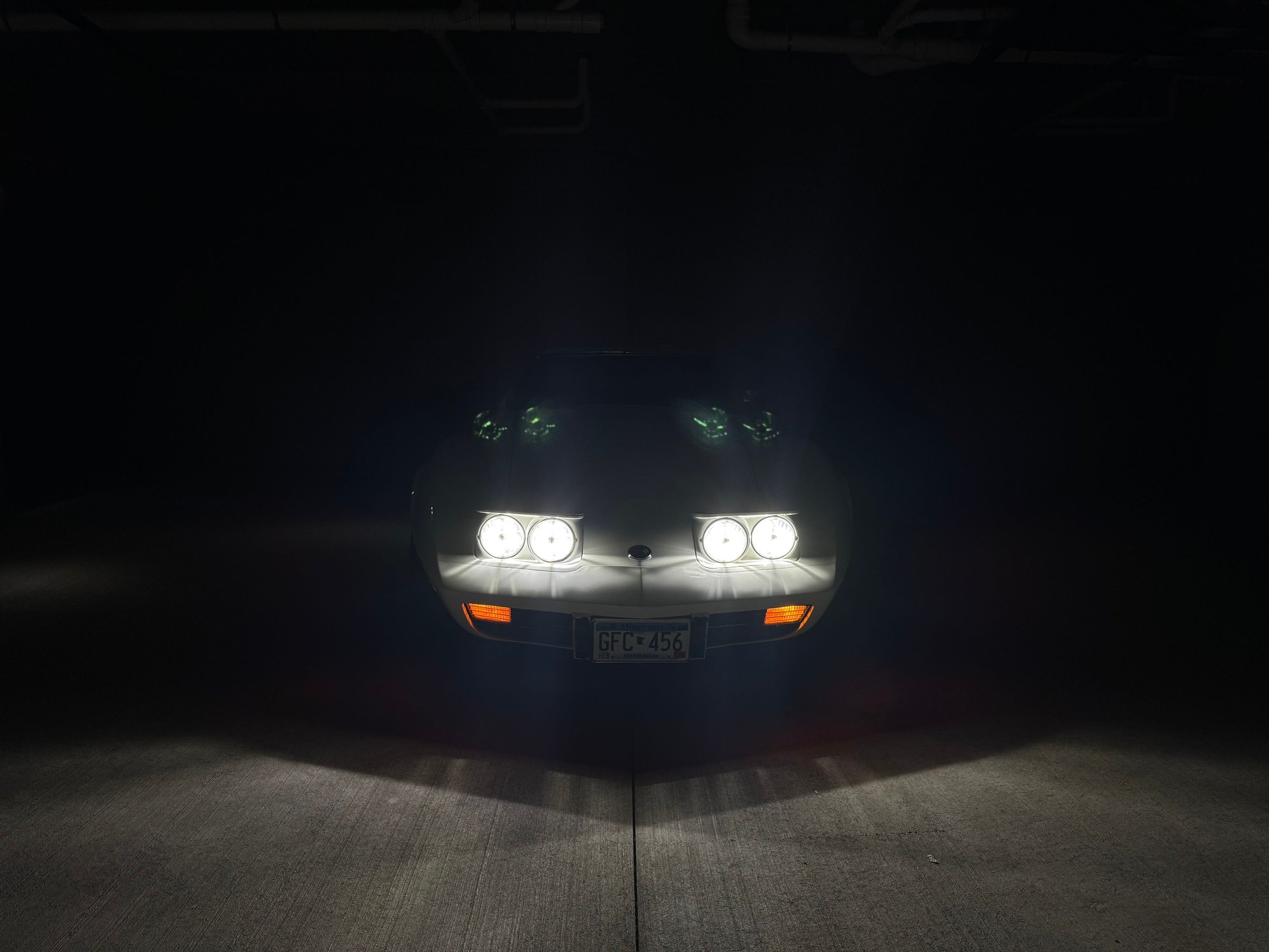

I used the Octane Lighting kit. Plug and play, works great, but suffers from being significantly less expensive than the Holley.

Just installed Octane Lighting 5-3/4 Stock OEM Retro Style Glass Metal Headlight LED's. What a huge improvment. Easy install with no modifications to the vehicle. Now I can run my high beams without tripping the circuit breaker.

I also put the Octanes in my '79. No mods required. They are a HUGE improvement over the stock halogens. I just had to readjust the aim of each bulb after install. The Octanes sit slightly different in the rings.

I run the octane lighting LEDs without the adapter so i have 4 low beams with 4 high beams....i can finally see my side of the road on low beam when a new car with HID lights comes at me or a dope with incorrect aligned LEDs or their high beams on...and i tried the wiring upgrade with relays and H1 and H4 Hellas...
