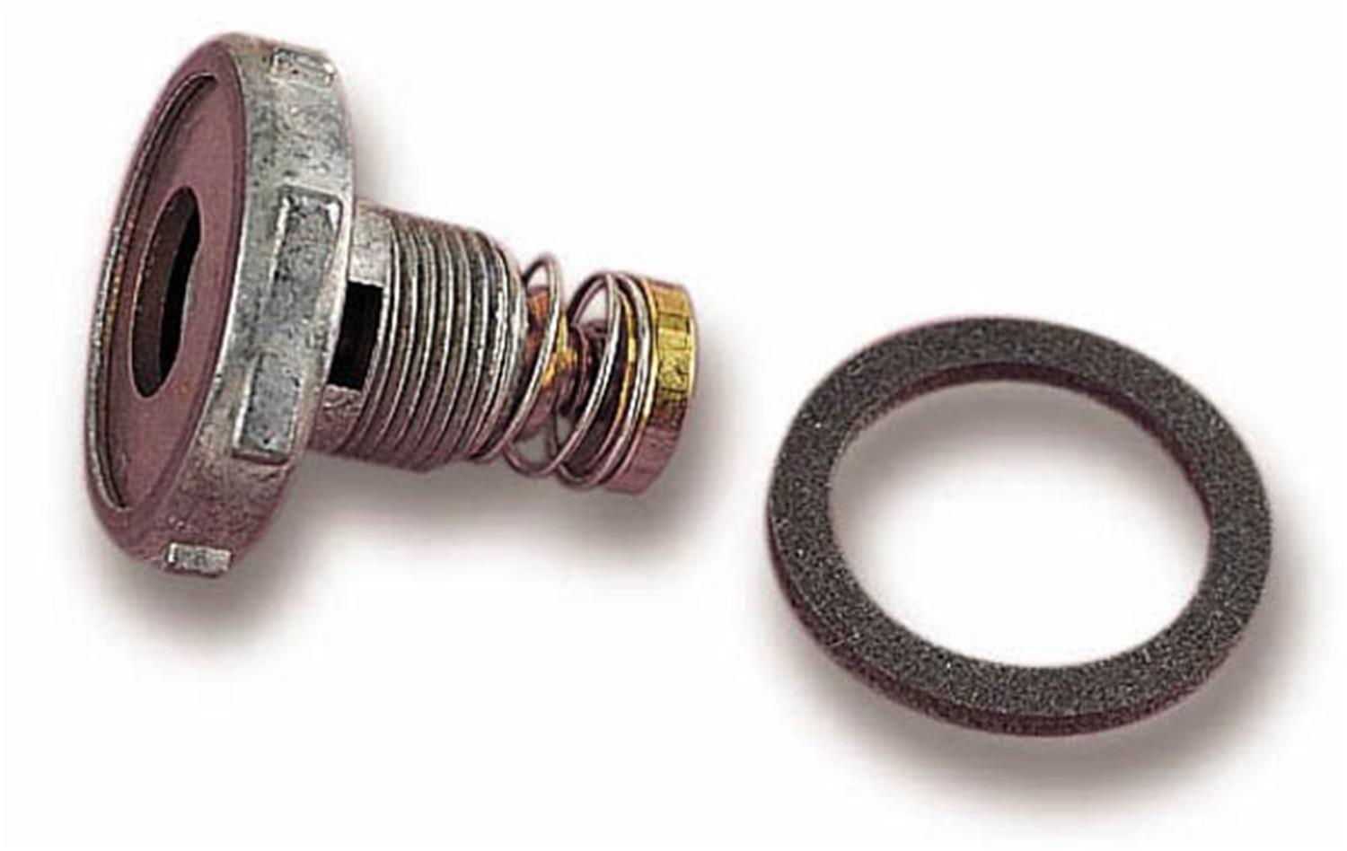

As long as the ignition is working properly I would check the power valve. Holley's have a habit of blowing them from a good backfire.

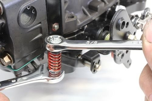

Have you checked the gap between the accelerator pump cam linkage and the pump lever? Too much gap leads to off-idle stumble.
From Holley's website:
Make sure the accelerator pump linkage moves the arm to the diaphragm as soon as the throttle is moved. Clearance at the lever will create a hesitation. Adjust the spring-loaded bolt and nut until the clearance is eliminated. This should require only a slight adjustment to minimize the clearance. Do not preload the lever. Excess clearance at idle is a very common occurrence that takes a minute to repair and when adjusted drastically improves drivability.

I will check the accel pump adjustment although before the amplifier died, it ran just fine. Power valve, maybe.
The car was running fine, shut it off, came back about 40 min later n nothing. The engine cranked , had plenty of fuel, but no spark.
plugged my spare amplifier in and it fired right up. Now the stumble off idle. The accelerator pump should cover the transition from idle to run so will ck that adjustment.
