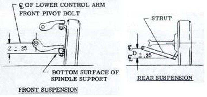

The stock front springs in my 1969 (I think) were in the 280 inch pound range. The F-41 front springs were in the 550 inch pound range and lowered the front end one inch. Since you said:
"my front end will be sitting up too high" this may help.
This is the proper way to set the height
To Front springs question
