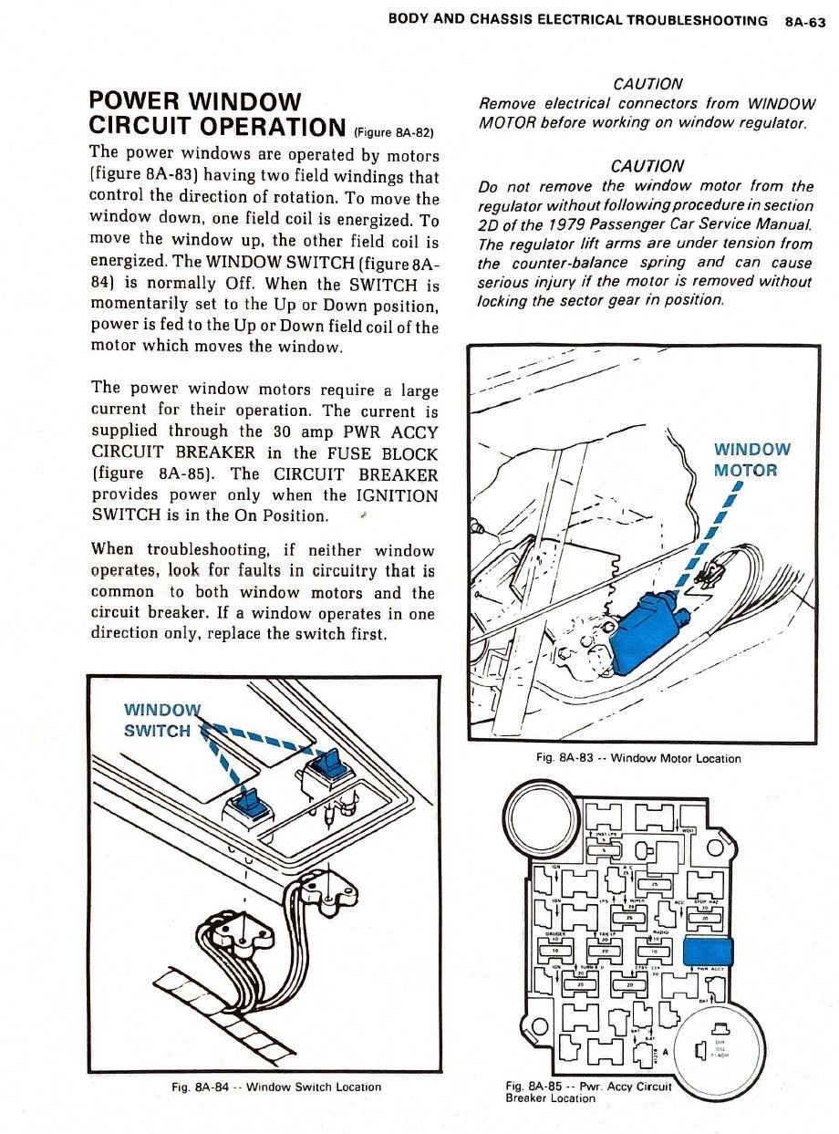

I do have a wiring diagram. All power windows on 79's are on a circiut breaker per the diagram, and confirmed on my car. Apparently 79 was the first year they did away with a power window relay snd went to a circuit breaker instead.

not sure what diagram you have but this may be helpful. seems like a short to me if clicking right away..maybe unhook the wiring at certain areas to see if it does not trip? corroded connectors...
