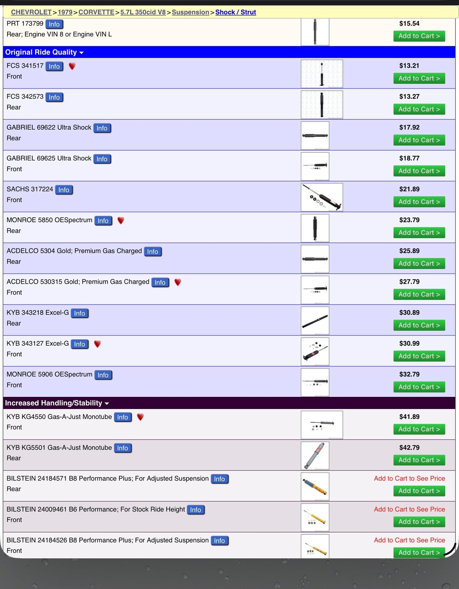

I am on my second set of KYB Gas-A-Just in about 30 years and I've been very happy with them. By all reports the Bilsteins are better but they are substantially more expensive and I've never been able to convince myself they are worth the money.

I have a 72 and run the air pressure about 29-30, have you run the KYB's or the Monroe OESprectums ? Thanks for the info !

I'm in Canada so I pay a premium on parts as well, but I can only imagine what you go through.
Rock Auto shows the KYBs at about $58 CDN. They only show the fronts for the Bilsteins and they are $133 CDN each! Everyone who has them seems to love them, but are they really worth $600?
