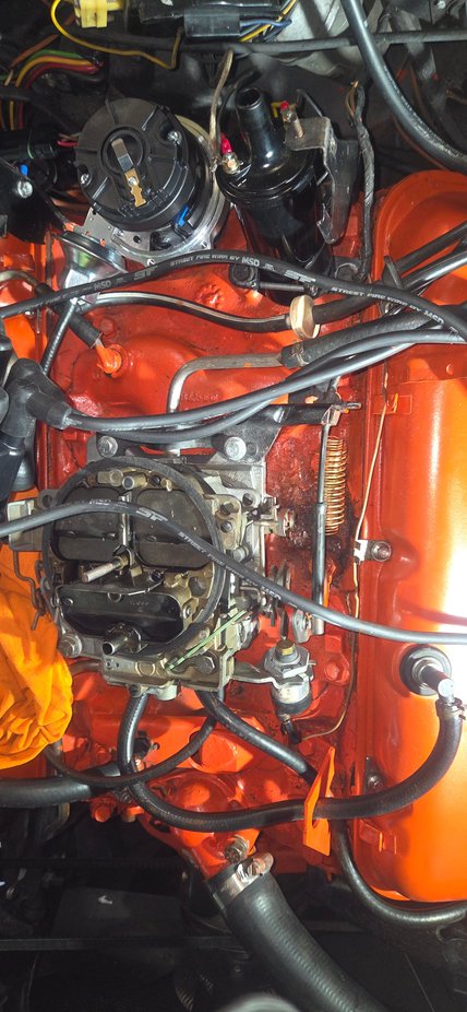

I am at my wits end. 1974 bone stock low compression 454. All cylinders have the same compression, valves look ok.
About three years ago my mechanical tach stopped working and I tried replacing the gear, but the insides were also stripped and ruined.
So, I bought a new one. It was a nightmare. After months of fiddling and fooling I finally got the car to run, sort of. Backfiring, spitting through carb. Terrible.
After checking, diagnosing and relacing the vacuum and trying different springs, I noticed that there was spark jumping all over the top of the distro.
Well, I tried to find a new cap, but to no avail. If you made it this far, bless you.
I just went ahead and bought another distro. Not wanting to throw more good money away, I decided to go discount, and after being assured this would work, I bought one.
https://www.ebay.com/itm/202251380240
I installed it today, and OMG, what a disaster. I put #1 at TDC, pointed the rotor at it, dropped in the distro and set the oil notch. Put in all the wires and new coil. 18436572 firing order. vacuum hooked up.
It is really bad. Wont even start, spits gas out of the carb, stumbles, bumbles and won't run.
Worse than the last distro. What can be happening here? I've done this simple job 100's of times!!!

Are you positive you put the distributor in on #1 TDC of the compression stroke and not 180 out?

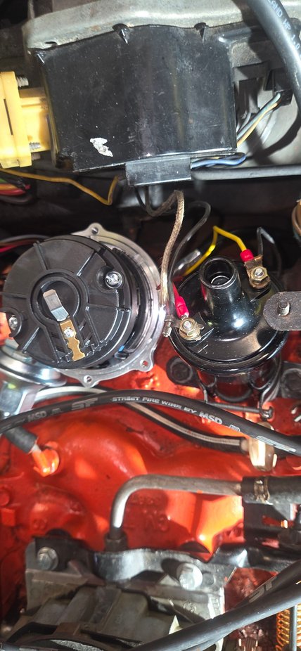

I am still at a loss with this. The motor is at TDC. The line in the photo looks a little off, that is the camera angle. It is dead on. Compression on spark one detected with finger in spark hole, then hand rotated to TDC. Rotor pointed at 1, and set in oil pump. Car wont run. What have I boneheaded?
"The rotor pointed at #1" could mean 2 things, but the only one that means anything is that the rotor is pointing at where the #1 spark plug wire is inserted into the distributor cap. It doesn't matter if the rotor is aimed at the physical location of the #1 cylinder. Both the #1 cap tower and the #1 cylinder could be in the same line with the rotor but that's not important.
Put the cap on the distributor and then place a marker/pointer somewhere nearby, indicating were you have the #1 wire connected to it. Remove the cap and align the rotor tip with the marker. Remember that you can make small adjustments with the alignment just like you would when moving the distributor to time the engine.

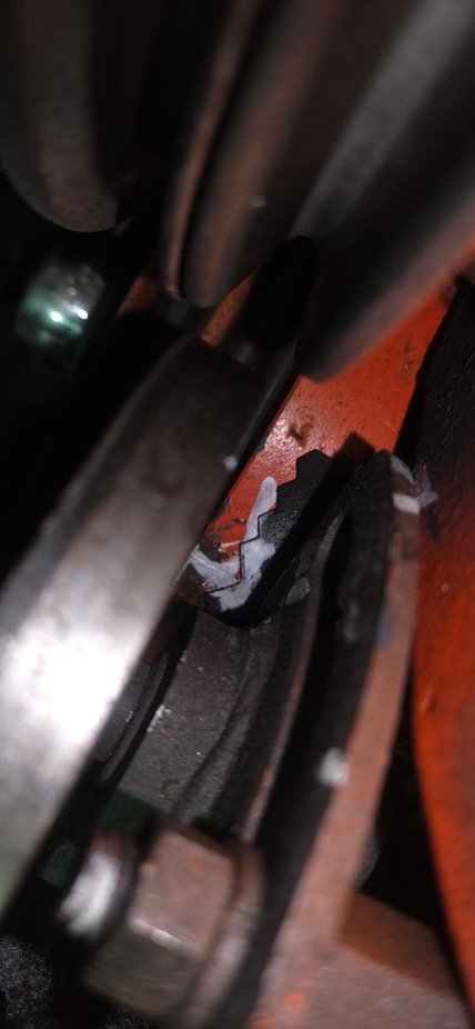

At that point stop, and using a 3/4 socket hand crank the motor clockwise until you see the timing mark and line line it up with the mark on the damper. It helps to dab white paint on it.

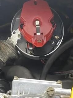

And whenever you take it back out take a picture of the rotors orientation from above so you don’t have to go through the alignment procedure again.
