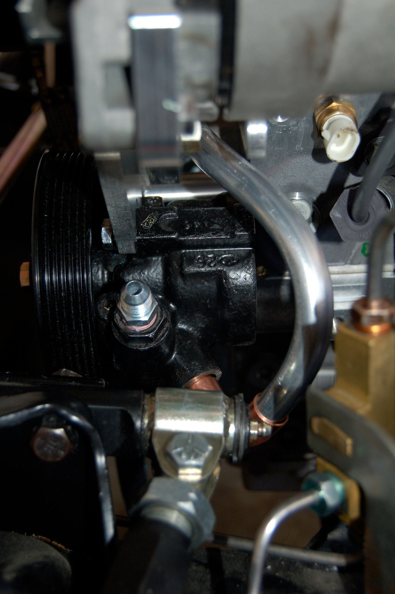

I was in a pretty good place. Body was off and San Jose had a business where you could just walk up to a counter and get some hoses made. I have an LS motor so that required me to make some custom plumbing for the brake power steering fluid return line.
Some of these pictures may help you. I remember having some fitment problems with the Pittman arm that required a couple of trips to my local shop (Corvette Clinic in SJ). I am on good terms with the owner so he let me swap some arms until I got one with a pretty good fit.

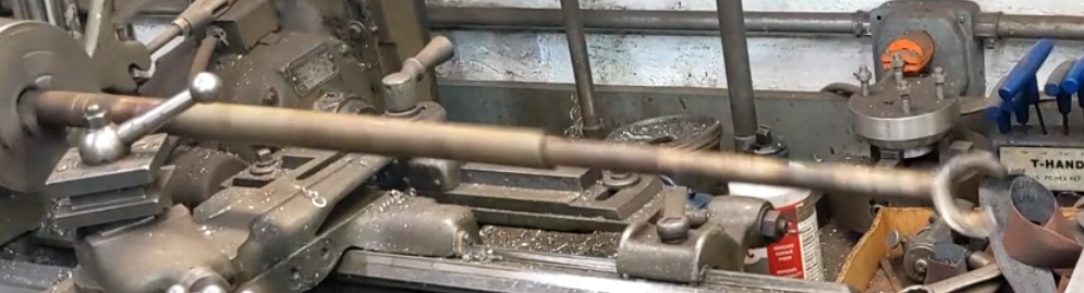

Perhaps the "non-hack" way to shorten the column would be to remove it, disassemble it, cut the lower shaft the correct length, and add new spines to the end.
I pulled the column and shortened it the "hack" way in my 79. The Borgeson upgrade completely transformed that car for the better.

I would not call shortening the column a "hack".
Just a length adjustment.
The 68 & up steering column is designed to collapse.
Disassembly of my column shows several tubes & shafts inside.
Each of those multiple parts is designed as two sliding tubes.
I did not measure the total collapsible length, but I would estimate it is at least 12", maybe 18"
Once the main shaft has been broken free of it's 50 years of rust, it will slide longer and shorter without ridiculous amounts of force. Maybe 10-15# of pressure. The weight of a gallon of milk, or two.
Injection molded plastic pins have been mentioned prior. They are for alignment and anti-rattle use only, they serve no strength purpose.
Shortening the column an inch or so does in no way defeat it's purpose as a safety item.
Main shaft, two piece
Main shaft, two piece, has a long large collapsible section, thinner section can completely fit inside larger diameter section, effectively cutting length in half
Several other internal tubes, all 2 piece and collapsible.
Several other internal tubes, tilt & tele column, all 2 piece and collapsible. Each of these sections can also collapse to half length.
