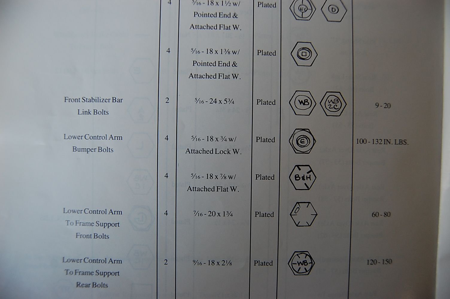

Hello,
I believe this book is a very good choice for chassis fasteners and hardware information.
I don't know its been updated. It was printed in 1989.
I don't know how available it is presently.
Regards....
Small example of the information it contains.
Small example of the kind of information it contains.

Thank you both for your help in identifying the bolts.
