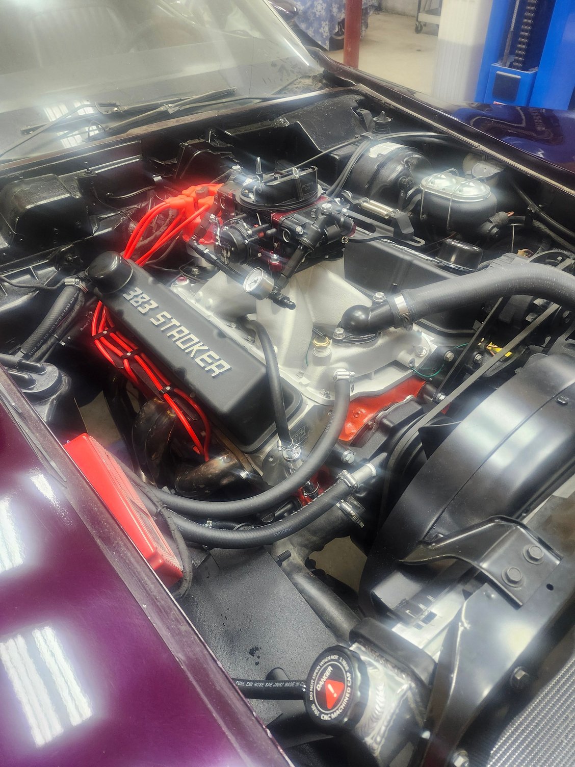

Just dropped a fresh built 383 in my 76, got everything lined up, filled with antifreeze and was a few days from fire up when I noticed fluid on the floor. Freeze plug by starter is leaking. Now I dropped 1k at the machine shop to have the block redone including new Freeze plugs, pressure test, bore, and mag. I really don't want to yank this engine again but I have never replced a freeze plug. Is it difficult to get the old plug out and what is the best way to do this? I seem to have enough working room, any advice would be appreciated.
