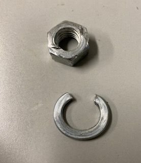

Am I doing something wrong or is this a result of poor quality materials? I've replaced the differential front mount (snubber) kit (rubber cushions, plate, washers, bolt and nut). As I torque the nut the split washer spreads open (see photo). Note that the nut surface is also deformed. The AIM calls for 55 - 75 ft lbs, but the washer deforms long before 55. All parts came in a kit from a supplier that appears respected on this forum (and I've used often). Sort of looks like the nut is too soft and bites into the washer instead of compressing it. Tips will be appreciated.

I have had the same experience, just junk out there.

Chinesium...

They supplied you with junk hardware. Very common these days. Use your original hardware or get new from the hardware store.

Most common hardware is sourced from China these days so just make sure you buy grade 8 or SAE J429.

Use a flat washer on top of the split it will never happen again

Using a flat washer did enter my mind, but wouldn't that negate the purpose of a "lock" washer to prevent loosening of the fastener?

Absolutely. That's not really a great idea. Using quality fasteners is the answer. So many things that come with hardware these days come with inferior hardware. I have such a problem over here in Australia, even the hardware stores sell junk. That I've taken to ordering genuine Harley Davidson nuts, bolts and lock washers. They are actually top quality. No lock washers spreading apart! But I work for Harley. Which helps. But it's still expensive.

These no need for those split washers anymore when a drop of loctite will do the job, or a self locking nut. That pic in post #1 is just poor quality parts.

Bad parts will be bad regardless, but a NASA study in 1990 showed that split ring washers are ineffective at preventing loosening on threaded fasteners. That’s what adequate torque is for, and why you’ll never see them on newer cars. Here’s more information about it.

I’ve been an engineer for several defense contractors for the last 40 years and we have never used split lock washers on anything. We used either lock nuts or loctite.
