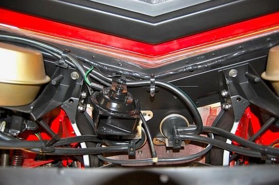

Here are the 2 relays located between the headlights on a 71 car. (The one on the left is partly hidden by the horn. Check that area on your car.

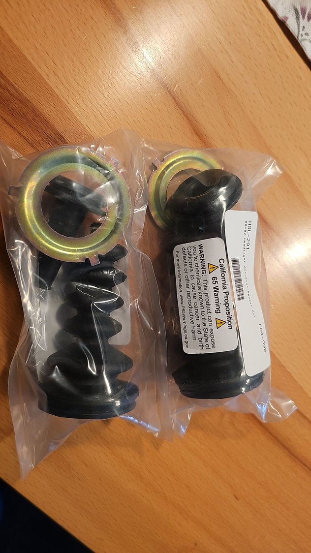

I have had this problem too. The reason was a worn sealing of left activator.
if activator wants to raise the headlight up, its rod is moving out, it comes to a position where the sealing was worn out. Thus the vacuum drops and the lid closes. Installing new sealing kits on both activators make it work.
