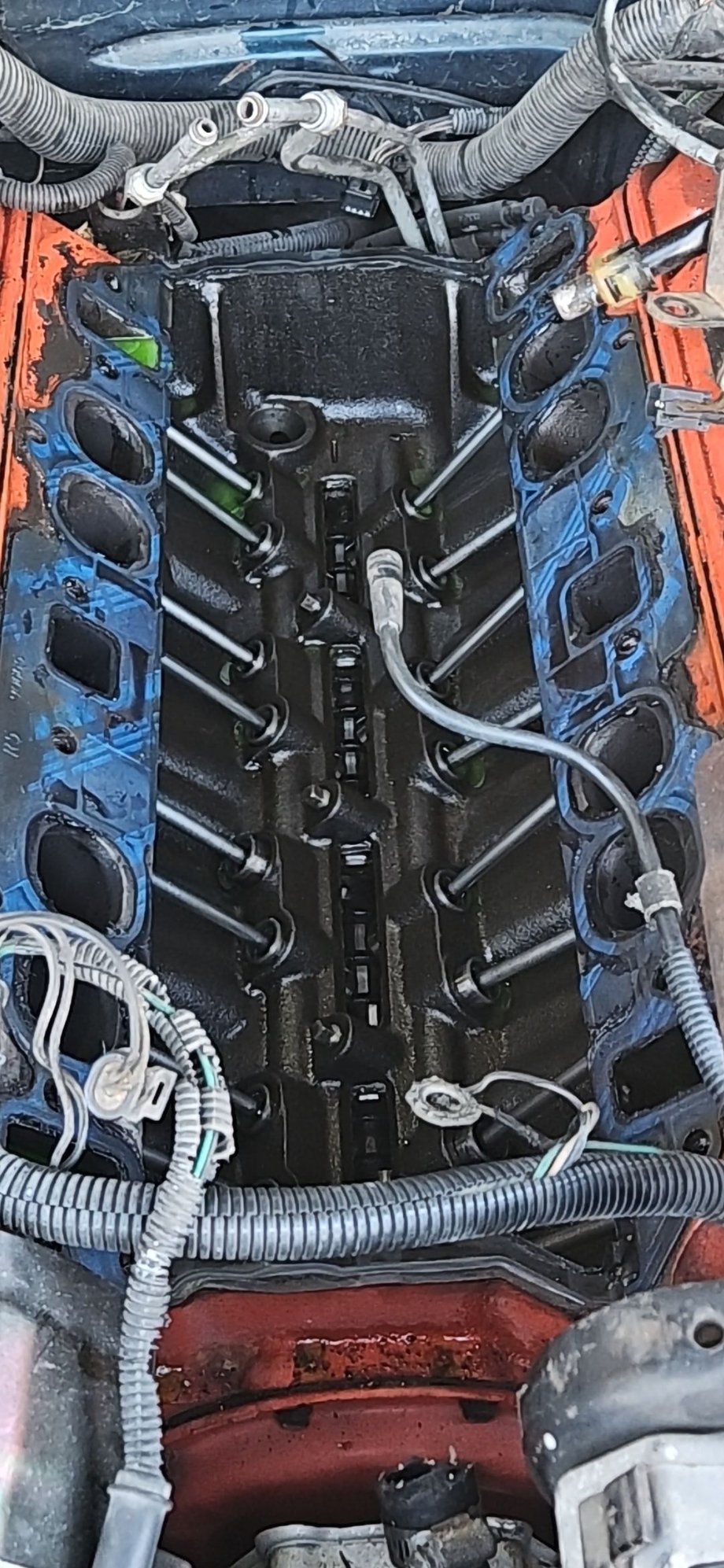

Thanks for taking the time to type all of that. Here is a pic i found of the lifter valley when I was swapping intake manifolds.

Nope ! Do Not think your block will permit use of OE GM roller lifters. Seems there are no stand-offs for OE lifter spider (cheaper) hold-down bolts.
Seems you're stuck using Retrofit Link-Bar lifters $$. Assume your comp roller cam has flat-nose; seems that's what'll mate well with your block.
However, You must verify that by inspecting the front face of Block and determining if it is drilled & tapped for a step-nose OE cam retainer plate.
Redardless, I don't see any way for the (cheaper overall) OE dogbone-spider hold down scheme to work with your block + OE roller lifters.

Remove timing set's Upper cam sprocket. Take a Hi-Rez pic of the block face that surrounds the cam's Nose.
Post it here. Looking for two tapped holes about 3.5" center-to-center. But, after viewing pic of your block's lifter valley, I seriously doubt they exist in this block.
Regardless; it's clear your block does Not have the mounting points for the components that are required to fit OE Roller Lifters.
