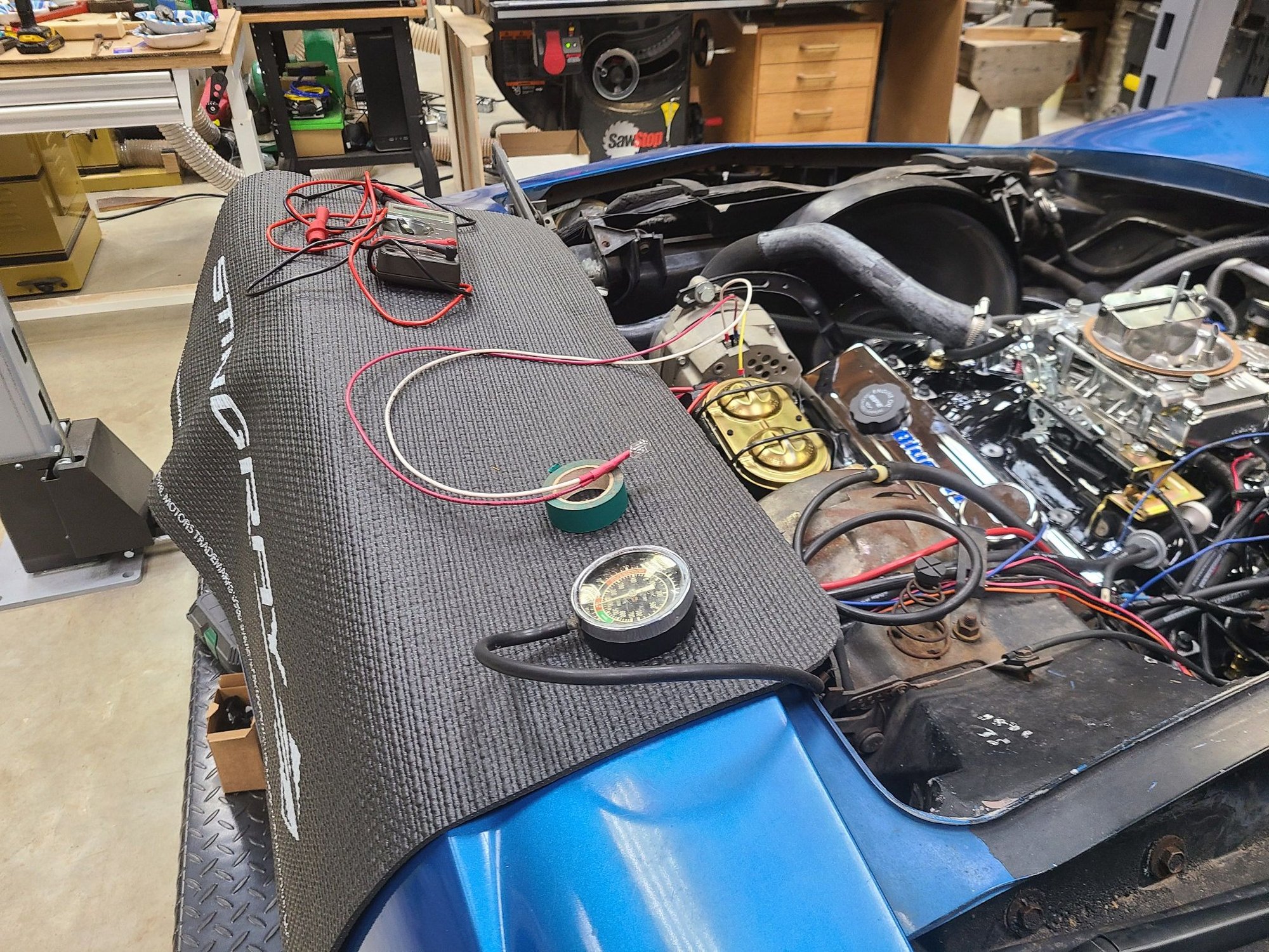

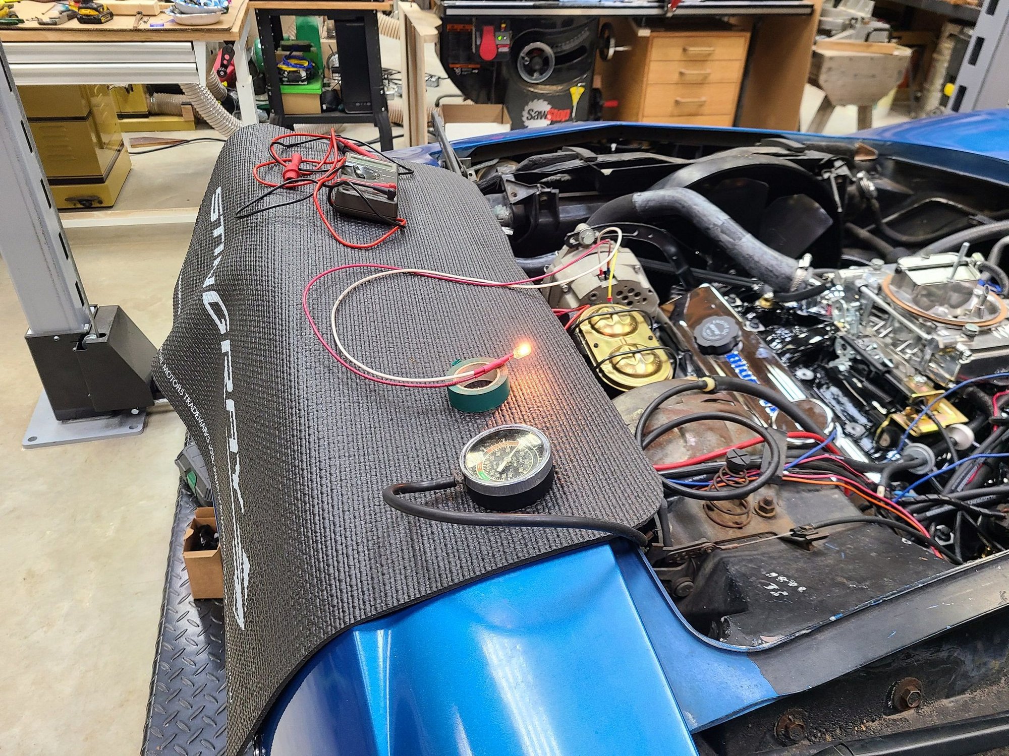

Just to test and make sure I took a dash light and added some wires to it. I took the switched wire and connected it to one side of the light bulb and to terminal #2 on the alternator. I took the other side of the light bulb and connected it to the #1 terminal.
With the key on and the engine not running the test GEN light is lit up.
With the engine running the test GEN light is off.
Interesting when you turn the key off the test GEN light comes on for a bit until the engine stops.
