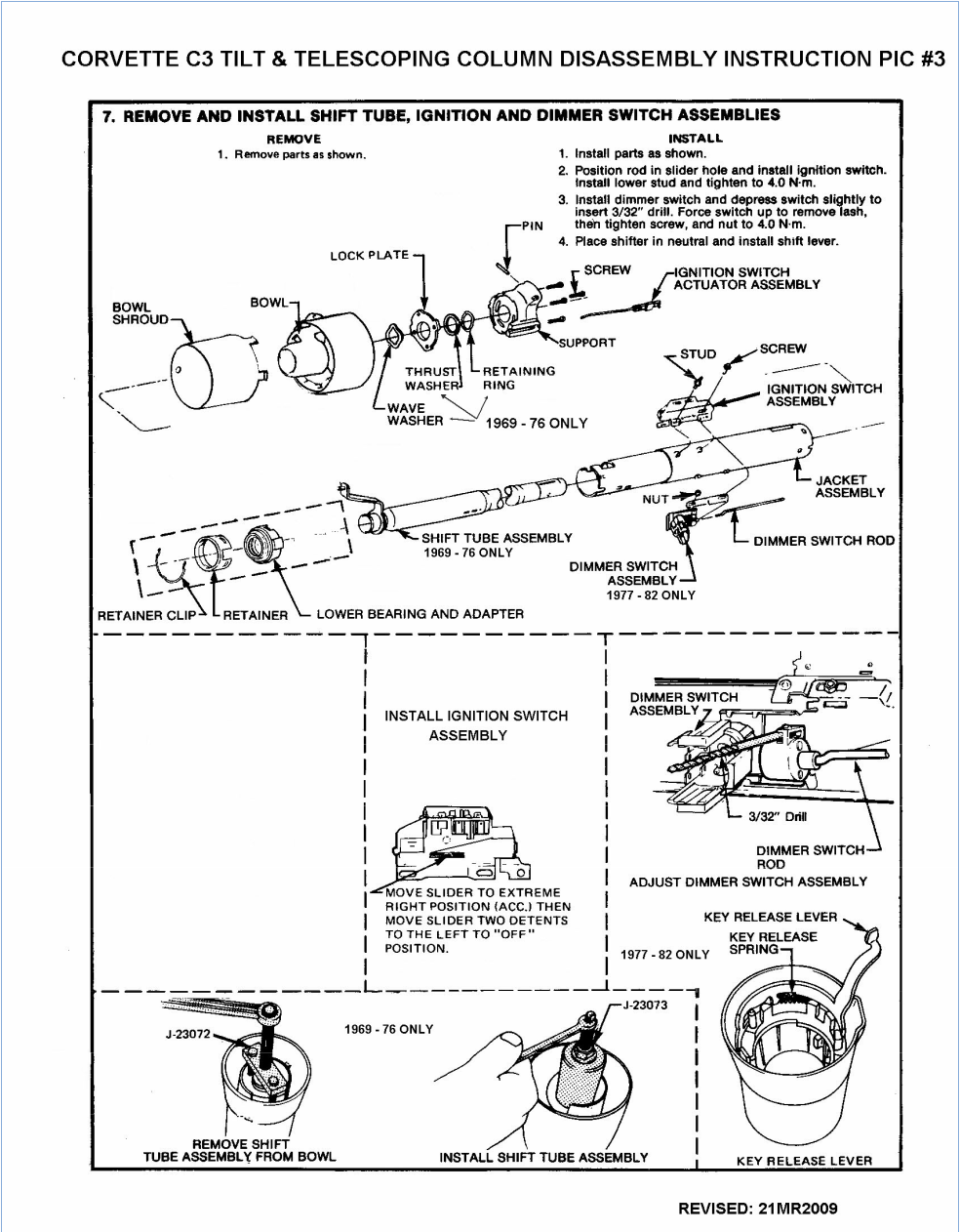

Digging through my collection of C3 information I found this pdf that shows the ignition switch.

The rack & pinion I was referring to is the key rack & pinion the moves the rod that slides the ignition switch from position to position. On the drawing above it's called the ignition switch actuator assembly.

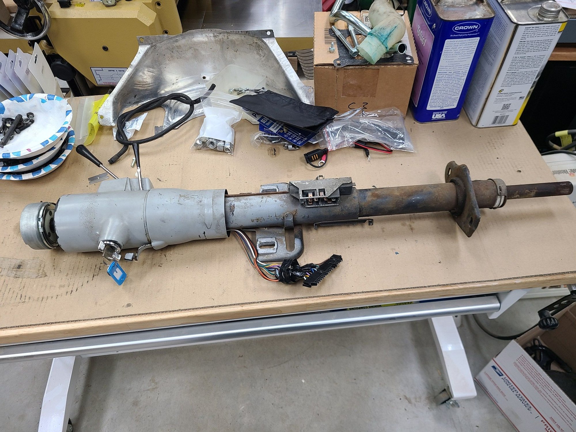

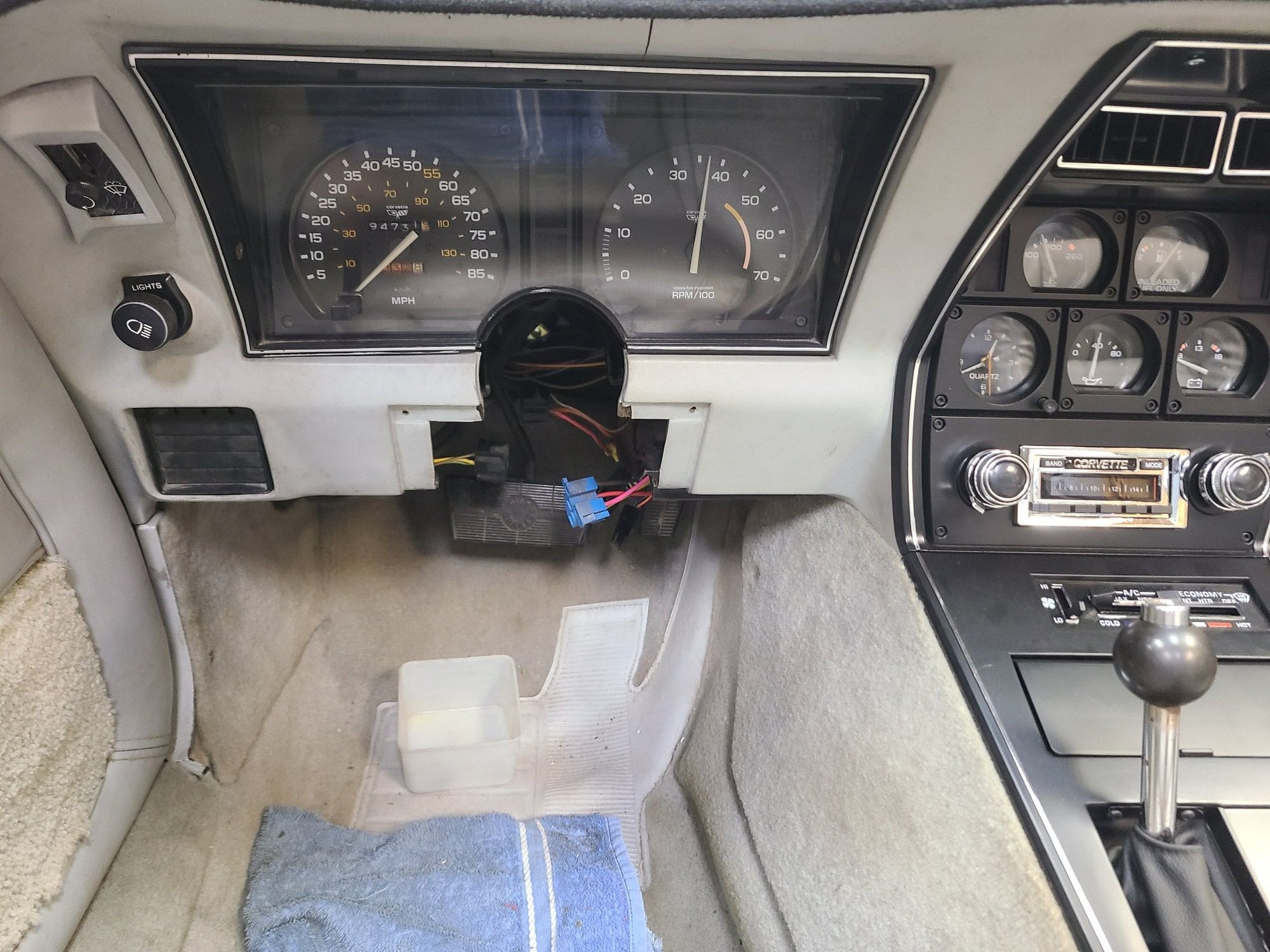

Hmm, it's out. I put a jack stand under the steering column to support it while unplugging the plugs. I had to rotate it 90° CW to clear the brake pedal.
It was actually not that hard to get the steering column out of the car. I did have to rotate and twist a bit to get the lower flange past the brake pedal.
Might as well clean it up and paint it while it's out. I see Bubba has been hard at work on the turn signals so I'll replace that and the dimmer switch while it's out and easy to work on. I also think I'll change the lower bearing as it has some play. The rest feels good.
So much for going for a ride this weekend in the C3.

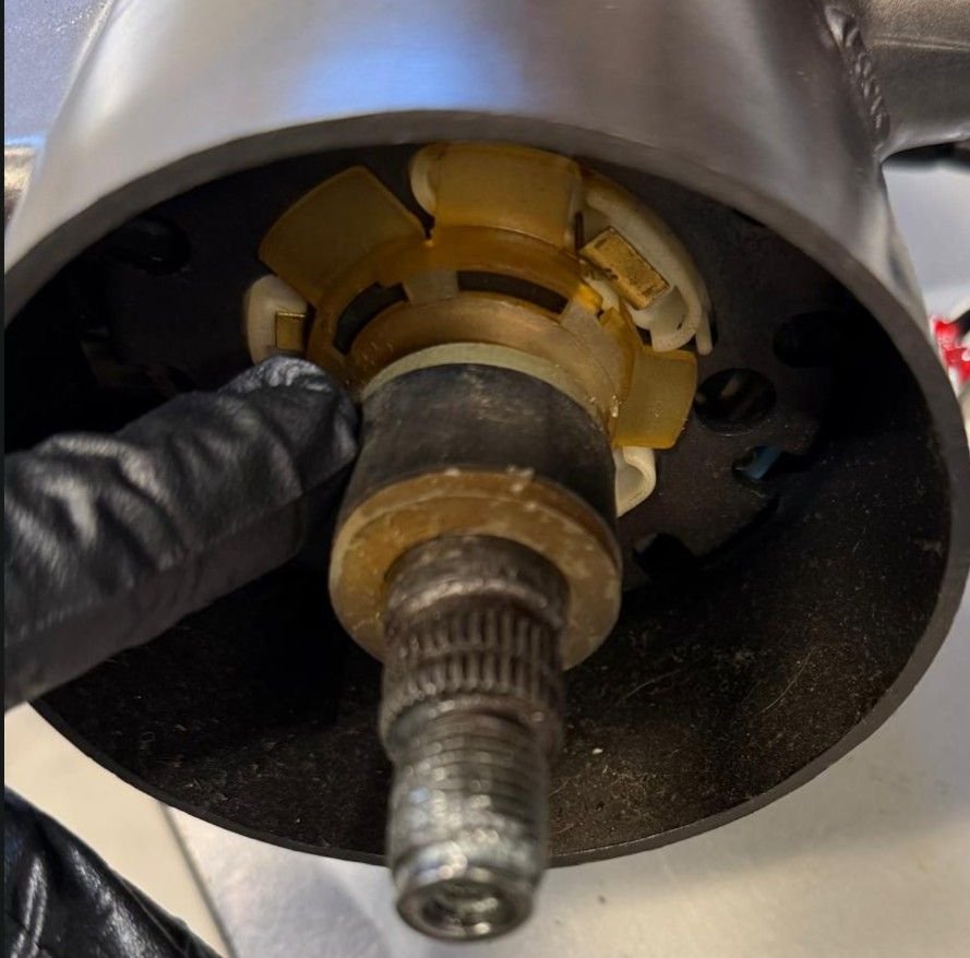

If your steering column wasn't recently rebuilt, you'll also want to get another GM steering column Horn Contact Retainer since you're taking it apart. If its 44 years old, the Horn Contact Retainer is a plastic part that crumbles to pieces when you touch it. I'm pointing to the yellowed Horn Contact Retainer before it crumbled in the picture. I just rebuilt my 82 steering column a few months ago and the two parts it needed was the lower bearing and the Horn Contact Retainer. It's needed or from what I understand, the horn will be on all the time. Since most Saginaw Steering Columns had this part for many years, they're easy to find on Amazon and other locations. The replacements are usually black colored.

Thanks, I replaced every thing related to the horn when I fixed Bubba's horn modifications when I first got the car.

It looks like the lower bearing is so close to the exhaust manifold that the grease melts away and leaves the bearing dry to fail. I packed the bearing with ceramic brake grease. Will see how the grease and bearing lasts.
