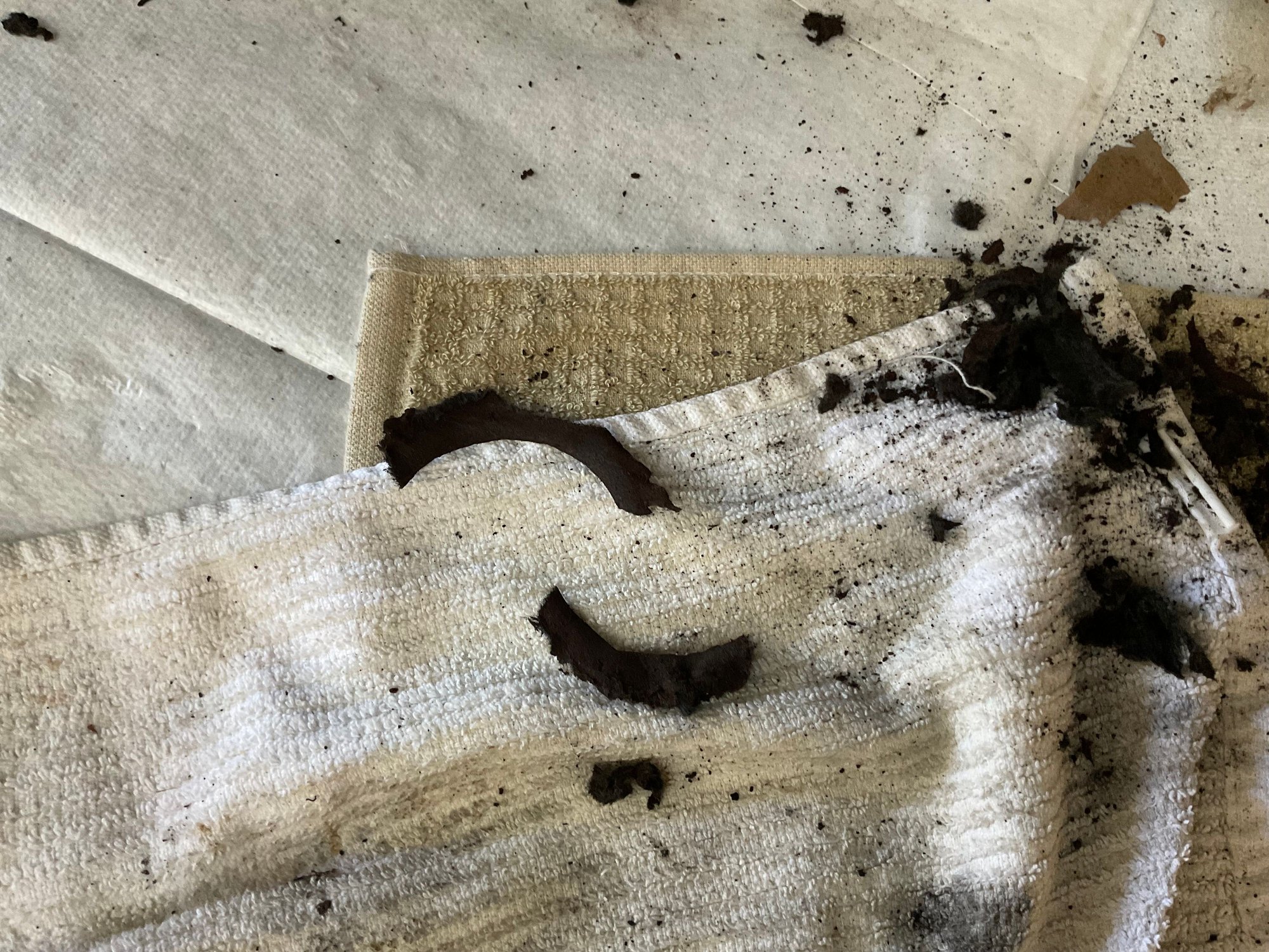

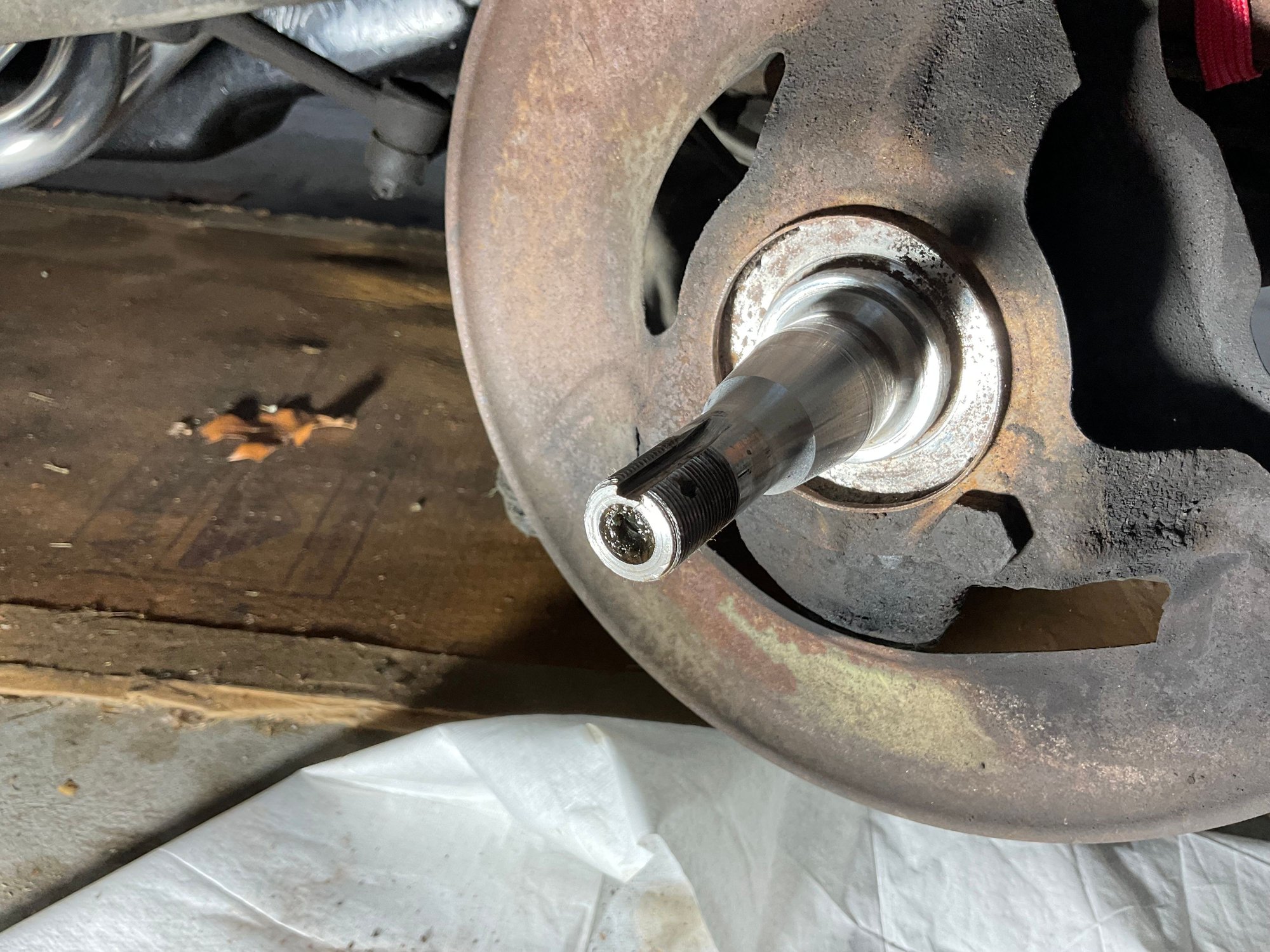

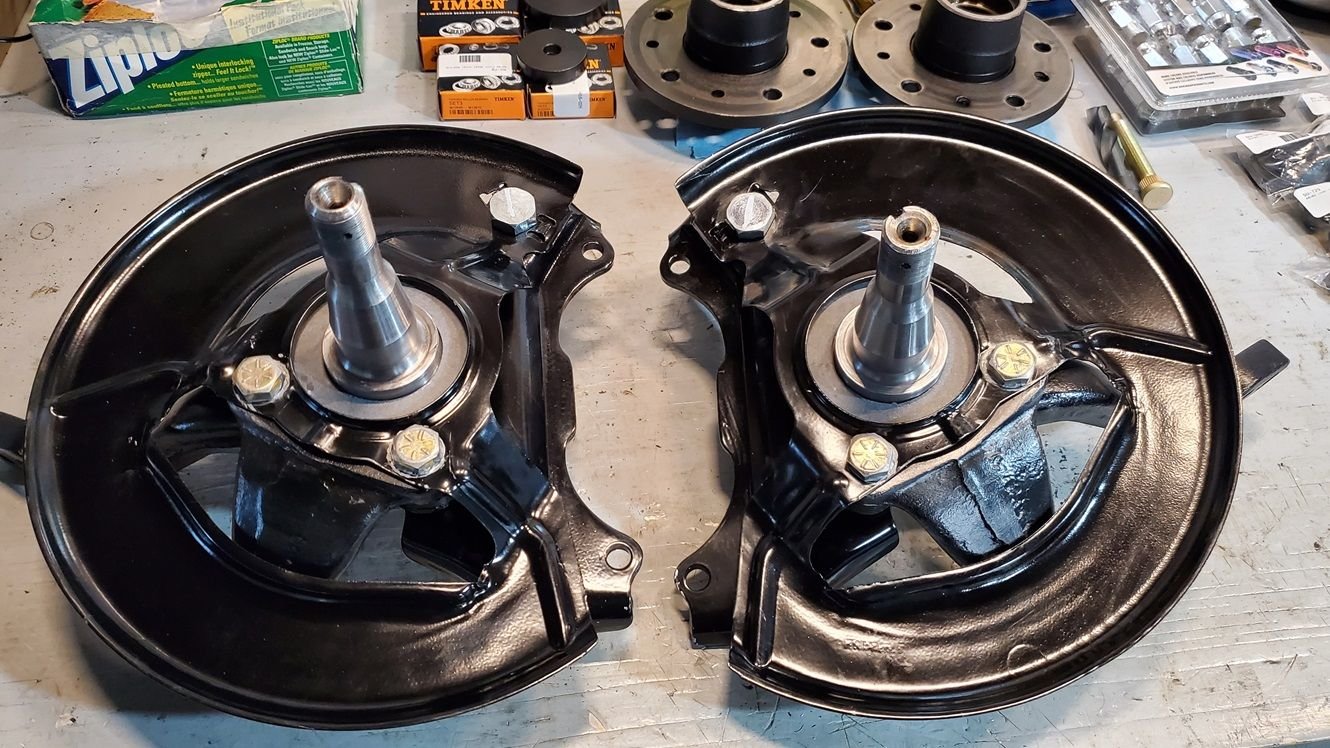

As I was cleaning the spindle with BrakeKleen….the are on the bracket wouldn’t clean up till I used a flat blade screwdriver. It seemed like a paper gasket was used. Not aware of any gaskets. Have I missed anything? Will try to add 2 pictures.

that is referred to as a grease seal. My experience on other vehicles is that the whole thing is removed, not just the material. Put a screwdriver between the seal housing ( what is left on the spindle) and the backing plate. Gently tap until it starts to move, trying not to mark up the spindle. The new one is installed in the hub after you pack and place the inner bearing into the hub. Tap the seal in place with a wooden block so that it is flush with the housing when you are done. Then slide the whole thing onto the spindle. The seal will hold the bearing in place until it is on the spindle. Next install the outer bearing, the washer and the nut. Snug the nut up and keep turning the wheel as you do. Once it is snug, back off one or two flats on the nut and insert the cotter pin. Make sure you put some grease inside the hub before you put it all together. Then go to the other side and repeat!

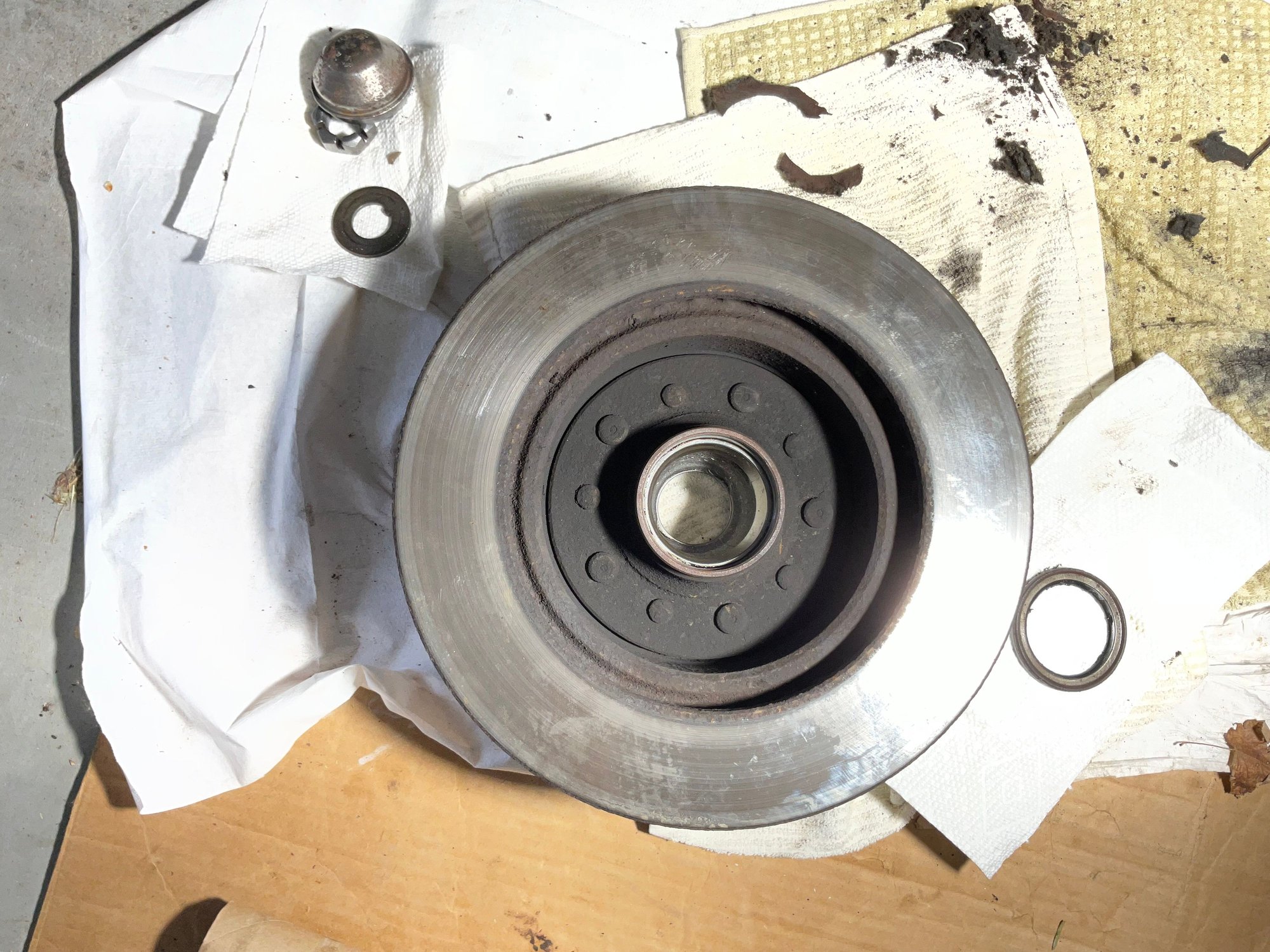

I don't think that's part of the seal on the spindle, I think it's a dust shield that belongs there. Let's see the back side of the hub, I'll bet the steel remains of the seal is still in the bore.

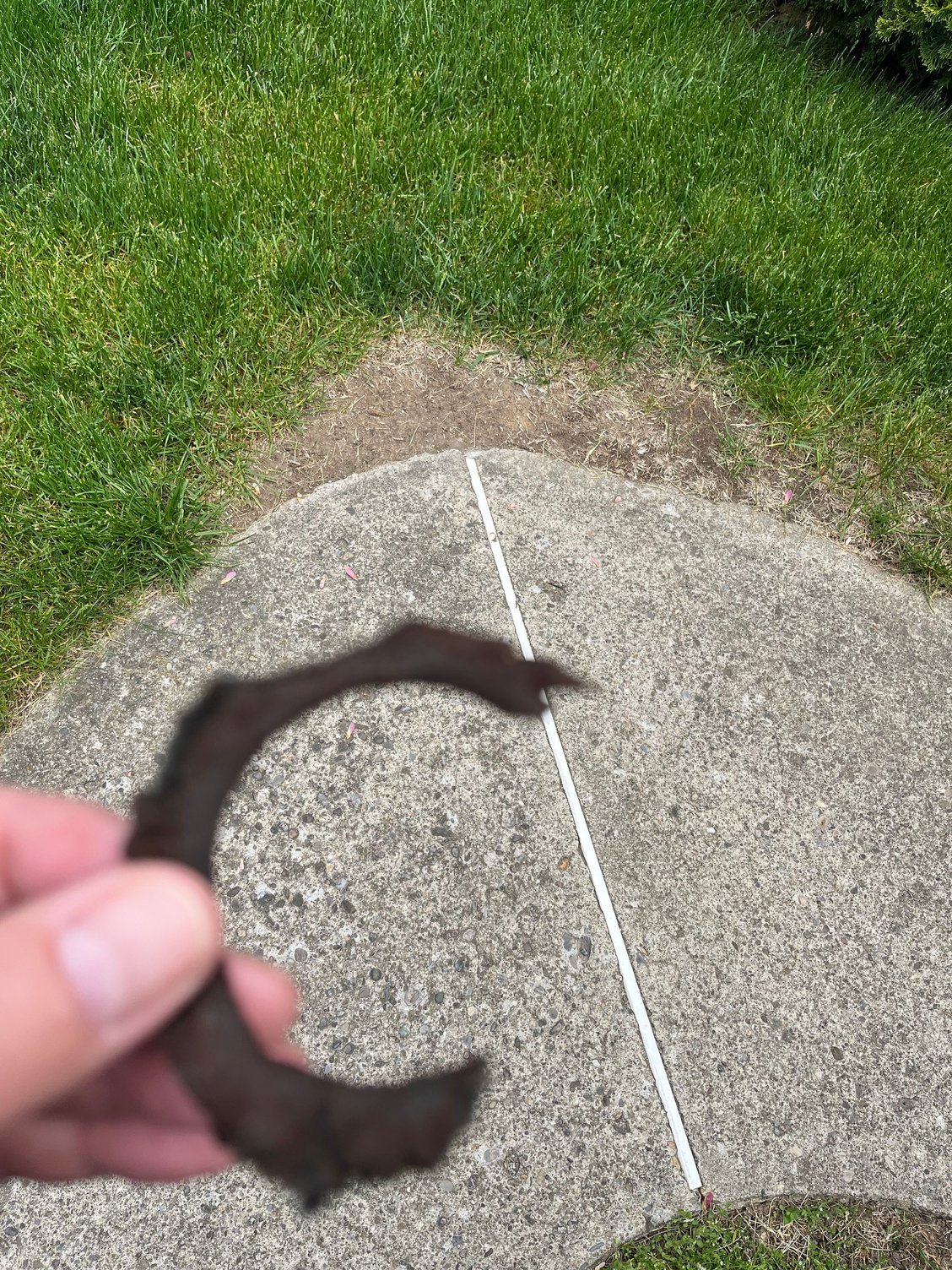

Good morning. Let me start by thanking the members for taking the time to share their expertise. I removed the inner seal with a seal puller. Took some pictures.

As a quick aside, was watching "Time with the Durbins" YouTube channel and at the very beginning of "Repacking C3 Chevy Corvette Front Wheel Bearings" ....it shows him inspecting the spindle and saying "seal area looks good" and the dark material around the spindle looks like the material I pried out with the screwdriver. Apologize for my confusion...it seems I need to replace a seal.

I believe I have located what I need on the Zip Corvette web site. I shows the following;
69-82 Front Spindle Dust Shield Seals
Will order and replace. Thank you all.

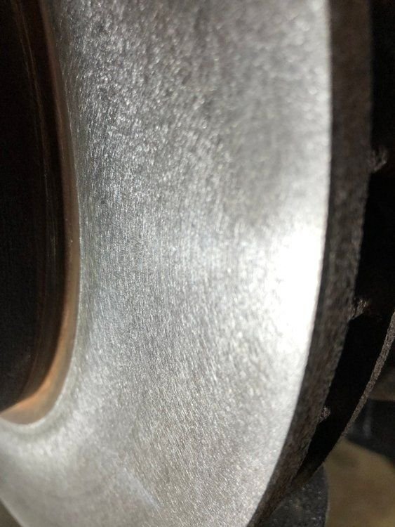

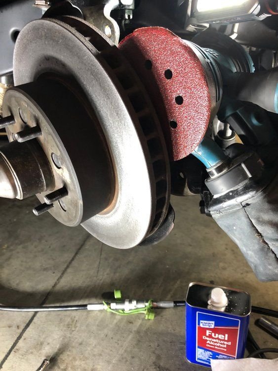

You may want to take a DA to the rotor to break the glaze

Old May 19, 2026 | 09:28 PM
rht69911s's Avatar
rht69911s
Joined: Dec 2024
Posts: 80
Likes: 40
From: The Plains, VA
Dual action sander.
To Front wheel bearings
Old May 19, 2026 | 09:37 PM
interpon's Avatar
interpon
Joined: Jun 2019
Posts: 7,677
Likes: 2,479
From: Indiana
Originally Posted by conrailbob
sorry Gary...DA ?
like this

You will need to replace the felt seal you removed or that fell apart.
