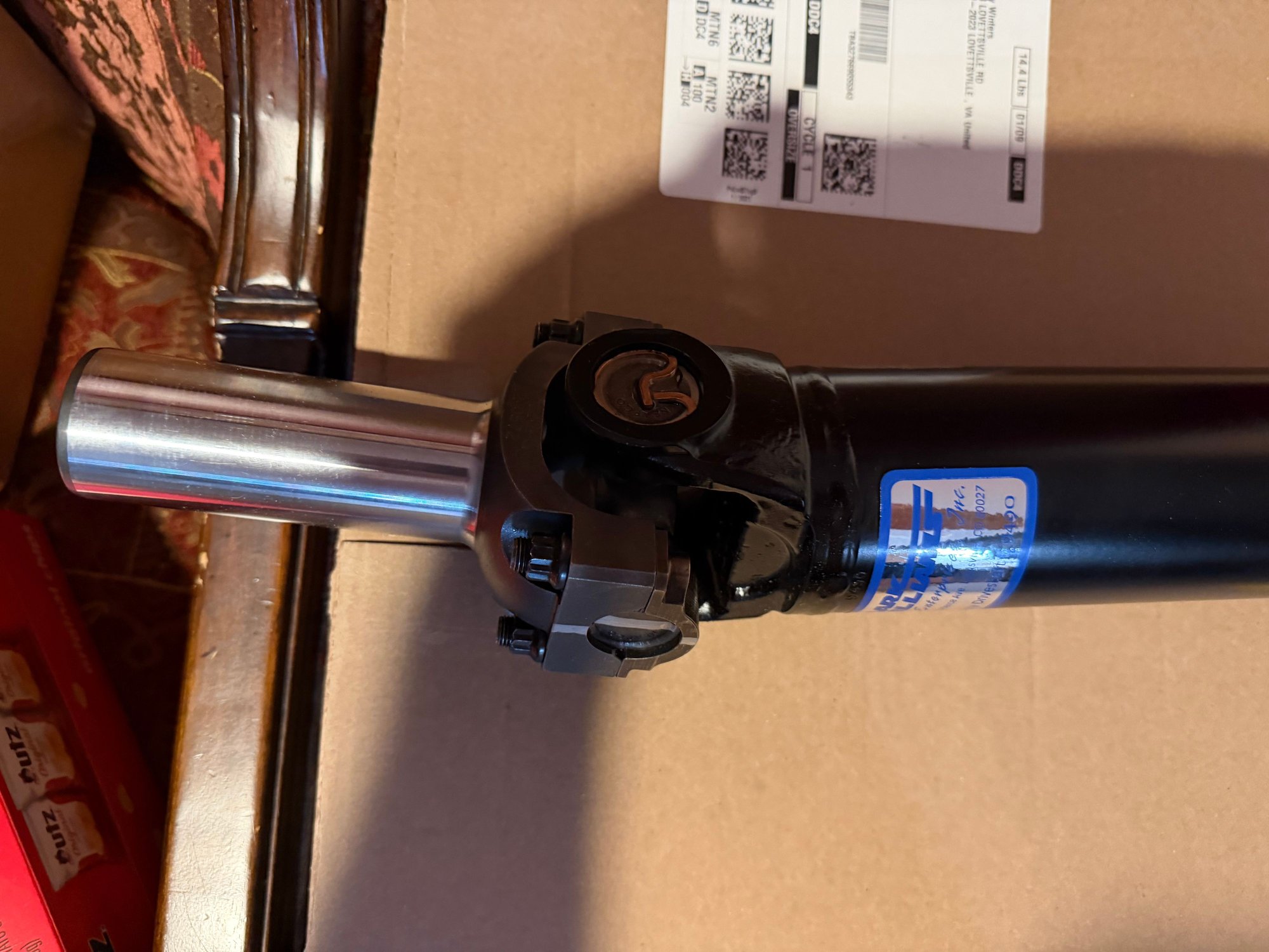

Anyone running a TKX 5 spd? I have a Yoke question. My TKX output is a 31 spline shaft and I have a 31 spline Yoke from Richmond Gear/via Summit Racing that is sold as fitting the TKX. This Yoke is only going 3/4" on to the shaft. I can see no blockage on either part. Anyone else run into this?

My 81 has a bolt in crossmember. I'm thinking push the yoke all the way in, insert the rear u-joint which will seat with about a 1/2" pull back. all that's needed should be 1/2 inch clearance to get the rear in. What do you think?

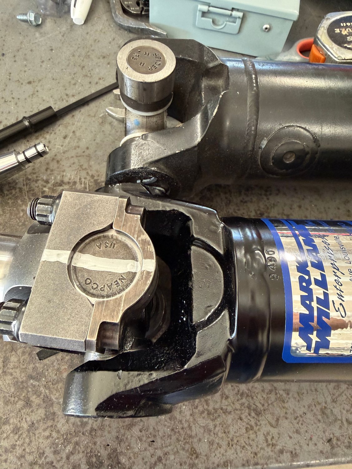

I bought a Mark Williams with removable caps for my tkx but it’s pricey. I had to due to my 4 link setup. I cant remove the driveshaft otherwise.

I ordered my yoke/shaft assembly as part of my TKX kit from SST but interestingly it's not their product. It fit and works perfectly but was drop shipped separately from a third party supplier. I researched having it made by a local shaft shop I already have a relationship with but the cost would've been similar so I just added it to my SST kit. I still have the box, I can easily get the name off it if anyone's curious.

Jeez that's a bargain. Mine was more than twice that, but has a flanged yoke so I it goes into the car in two pieces and gets mated in place with no interference with the car.
